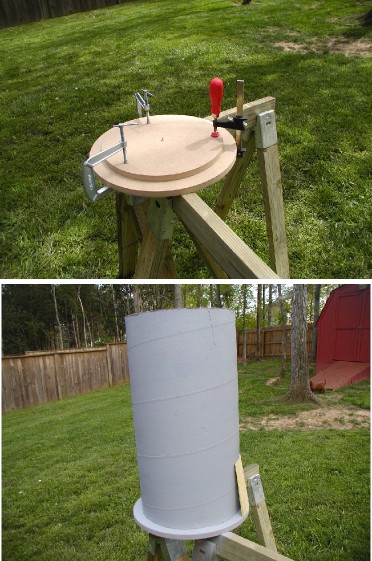

The 2nd thing is the construction of the Mamboni SonoTube base units and assembly went fairly well after I got over the learning curve of using my new plunge router. I purchased the Hitachi KM 12VC unit after I read some reviews on different routers and I have to say that I'm pleased with this unit. I wish it had a vacuum hose port because it sure makes a lot of dust when carving up MDF and I needed to manually vacuum stuff up between carving / cutting up pieces. I did wear a respirator, dust suit, safety goggles etc. but it took me as much time to clean up the work area as it did to do the actual work!
Once I put the base plate and center brace into the Sonotube and had everything glued up, braced, etc. I performed a knuckle test on the tube and determined that this thing really needs sound damping BAD! I'm not sure if simply filling it up half way with ACOUSTA-STUF POLYFILL is going to be enough damping because the tube resonates like a - well like a big cardboard tube! I believe that Mamboni's outter covering of carpet serves to deaden the tube quite a bit but I'm going to also apply some damping treatment to the inside of the tube in addition to the Acousta-Stuf and then adjust the stuffing to my personal taste. Hopefully I can finish this test unit tomorrow and start to break it in for a week or so.

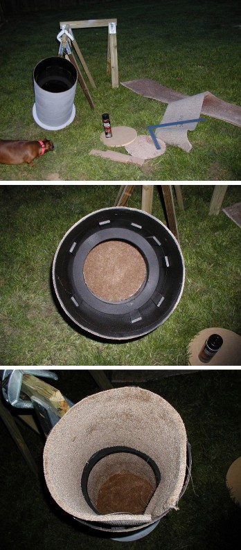

After a night of thinking about my available options as far as damping the megaphone like resonant reverberations from my SonoTube base units I decided to keep things within the boundary of DIY and select materials available to the average builder. Lead is difficult to obtain - and is fairly costly as well. I considered a dense heavy rubber matting but the material is costly and requires ordering - but there are some internet sites that offer it for around $6.00 a square ft. - ugh Heck - I can purchase some nice wood flooring for less than that! Foam rubber as used under indoor carpeting is available for a reasonable price but the materials I found were not dense enough for my taste - but I will keep them on my list for future usage. Rubberized asphalt is available at the local hardware store and might be useful - but is messy, hard to clean up, and smells very much like you have just tared your speakers and now all you need to do is find some feathers to finish the job with.
I wound up with a couple of things that looked affordable and workable. 1st was some automobile undercoating in an aerosol can. I tried a can of this material and for my uses I found it to be a waste of time and money. I was supposed to provide some degree of sound insulation but in fact provided little more than simply spraying the inside of the speakers black - plus it's messy!
I had considered gluing cut to fit wool blankets (purchased used at the local Army surplus or thrift store) or felt to the inside of the speaker - but I wanted more damping that they would provide.
In the end I stopped off at the local carpet store and purchased a 9ft. by 12 ft. carpet remnant for $65.00. That should provide enough material for my two personal speakers plus my two test speakers. At around $0.60 per sq. ft. - plus $5.00 bucks for a can of spray adhesive I'm thinking that this pretty much fits the bill without braking the bank.
I cut up a piece for the bottom of the SonoTube bass and glued it down - large improvement in reducing reverberations were noted. Still had quite a bit from the side walls - so I cut up a bit more carpet and hand fit it in for testing (no glue - yet) - great improvement and I now fell that using this oversized toilet paper roll for a speaker enclosure just might have a chance of coming out fairly decent.
I still have Acousta-Stuf to play with if more "tuning" is needed but I think the 1st speaker is about ready to fire up and get burned in.

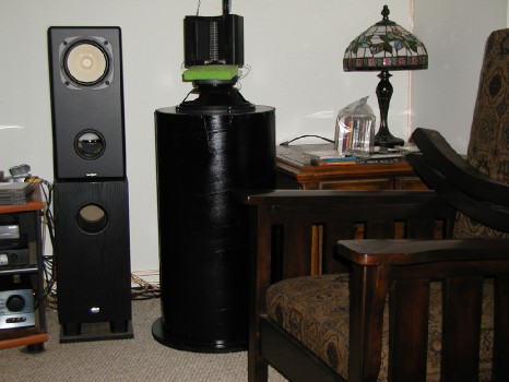

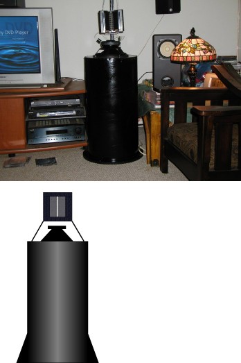

I'm attaching a photo of the test tube speaker - it's not even been positioned yet - it will sit about where it is at now but will start out at about 3 ft. from both the back and side wall to start with - and then go from there. I currently have the Heil just hanging from a support pole to play around with height adjustment before I commit to final design of the speakers I'll use day to day. The height of the tweeter in this photo is at 40 inches center.
For the real speakers I'm currently of a mind to do something like the attached photo using epoxy resin and a piano black gloss finish. But that's what I'm thinking today -
I cut the circle with a jig I purchased at the local hardware superstore. The problem there is that the fine print on the box didn't say that it would not cut circles less than 6 inches in diameter! I wound up making my own little jig out of thin plywood for the small cuts on the baffle. Guess I'll need to break down and get the Jasper jig from PE after all.

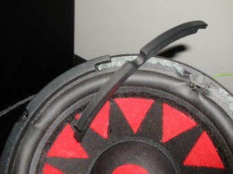

I have discovered a new edge treatment for the speaker surround - and I strongly recommend that others do not attempt it!
I decided to install some longer screws into the speaker frame to insure that it was well sealed against the baffle. I was fairly sure that it was - but I was also aware that the screws I used were just short enough to be in question - and I wanted to eliminate them as a possible source for air leakage. As I was backing them out of the speaker I noticed some sticky black rubber adhering to the screw threads and I figured it was some of the black silicone glue I had used to secure the gasket to the baffle - but alas - that was not to be.
Once I had the speaker removed it became apparent that the "sticky black rubber" was in fact the butyl rubber surround of the speaker - and it was now in need of a new surround.
So a word of caution - trim that little piece of black rubber material away from the screw hole used for mounting the speaker to the baffle. When front mounting a speaker this usually is not a problem - but driving the screws in from the back side of the speaker will "grab" the rubber surround - and - and - sob - sob - I just can't stand to go on and say the unmentionable
Good for me I have a second speaker with the Mamboni triangles applied! Good for me that I also have another spare speaker to mod. Plus - on the bright side - I'll to learn how to repair a speaker surround!! OH BOY!! - Just shoot me and get it over with!!
Thomas,
Sorry to hear of your accident. As they say now...IT happens. I wonder if you might like to take this opportunity and try an experiment with what is left. It seems to me that using the speaker face down as you are now that dome which covers and keeps dirt out of the voicecoil gap does nothing helpful for you. It creates a resonant chamber and the material it is made of adds mass, hurting the HF resonse of the cone. Why not carefully remove it and give it another audition. Actually from what I see of your surround damage I think you can fix that with some soft glue and the repair will not be seen when it is mounted. I just successfully repaired a large tear in a foam rubber roll surround on a 1 inch P-P excursion 12 inch sub using Goop.
C2C,
If the surround is not actually torn, just messed with, you do not have to do anything. If the Goop doesn't appeal you can go on safari to the big city and go to a dive products store and purchase a small tube of foam gasket repair material. Or, possibly the glue used to repair tears in dive suits. We used to repair the occasional screw driver hole in surrounds with the real PVA compound which never quite set up hard. But then we were also coating the entire cone and surround in PVA , which is a reasonably viable alternative to the Mamaboni and EnABL process. Will provide maybe 70% of our control over ringing and spurious refractions. Of course, you can only buy the stuff in 10 gallon buckets, but maybe your neighbors would like their various surfaces painted too.......
If you want to stick the thing back down use Elmers White Glue. It is not pure PVA (Poly Vynil Acrylic... I think) but it is close enough and PVA is the surround and spider glue, to basket, of choice. Surround to paper cone is a different story and it will be easier on your store of blue language to just go looking for a replacement cone with surround and voice coil from an authorized dealer/repair shop, buy a plastic shim stock kit from McMaster Carr to align the new cone and voice coil in to the gap with, preattach a new spider with two part black epoxy they sell you from the dealer/ repair shop, by sliding the coil into the gap with shim stock just to the point where the surround touches the basket and then glue the spider with the epoxy and wait a day, before gluing anything else, and then putting runny PVA on spider and surround mounting surfaces and, while carefully holding on to the plastic shims, wound into the voice coil, slide the whole apparatus down just far enough to make contact between surround and basket and spider and basket........ .......just buy another driver if you can't repair the surround... lot's easier on your heart.
Bud
Bud
Hi rcavictim
- thank you for your post and suggestions.
I have installed the 2nd test speaker and while I was at it yanked out the carpet I had lined the walls of the SonoTube with and filled it half full of Acousta-Stuf packed to a "medium" (calibrated by guess) density. I also soldered in another 4 ohm 10 watt resistor (total of 8 ohm's now for those who are keeping count ) in series with the Heil tweeter to trim it back a bit.
Your point about the rear vent of the Pioneer being open and facing up to collect lord only know what (spiders, dust, roof plaster ) is well taken and I'll go slap a piece of felt over it for the testing phase. The dome of the Pioneer has a 3/4 in hole cut into the center of it per Mamboni's design and the felt is being used as a vaiovent type of port. BTW - with the amount of air it forces out of the vent I might not need to worry very much because it is exhausting a good amount of air from that vent!! No "chug chug" sounds tho.
I have already ordered a surround repair kit for Simply Speakers - alway good to have one on hand. I repaired quite a few back in my stereo repair days - but that was like 30 years ago - back when we used the canvas off of old sailing ships if we couldn't get any buffalo hide. A patch might well do the job - need to find some thin rubber - perhaps one of those bicycle inner tube repair kits would work
The speaker is back into burn-in and playing just fine - so just a slight delay. I'm also going to knock together a unit with the Pioneer facing upwards as you have suggested - Very similar in concept to the speakers the folks at Oscar Heil Speakers are showing off in the photo.
Hi BudP,
Good to hear from ya buddy!
There are two good sized tears in the edge of the surround - so some type of patch is in order. I think I'll try a thin rubber patch similar to repairing an inner tube - should be OK - I think
If not then it's surround repair time - which the last time I did one was a bunch easier than a cone replacement. Just carefully remove the existing surround and glue on the new one - trim it up a bit and glue the new surround to the speaker frame being careful about fit and tension - and not getting glue all over everything!
BTW - yanking out the carpet and replacing it with the Acousta-Stuf was a break even - pretty much no difference. I might need to take out a little tho - the bass seems a little weak.
Thomas,
There appears to be confusion referring to the front and rear of a speaker because of the way you are using it...backwards. To me, regardless of use, the back is the side the magnet sticks out OK ?
I was not suggesting you use the speaker with the front (concave side of cone) facing upwards. As a bending wave Walsh type transducer you have it facing down into the cabinet. I meant to leave that alone. I merely suggested the dome in the middle of the cone front is not helping you now and it might be better gone. I saw that you had punched a hole in it and added felt as a variovent. I did not comment about plugging the vent hole through the magnet center pole piece. With the dome removed from the front there will be no piston action to move cooling air through the hole in the pole piece so even a solid plug could be applied otherwise at the rear of the magnet or you will have another port into the airspace below the speaker diaphragm into the bass cabinet. If left open I suppose you could levitate a ping pong ball over it with a good loud bass note from a sine generator, the same way a beach ball can be levitated above a blowing vacuum cleaner nozzle. If the bass cabinet has a port as in bass reflex perhaps not.
Hi Bob,
Thank you for clarifying - but I still want to try the Oscar Heil configuration with the cone facing upwards as well - just to see what it sounds like. I still have an untreated Pioneer to use in that manner - although I'll put BudP's EnABL pattern on it and leave the dome intact. It does mean that I may need to port the enclosure tho - but I'll go with a sealed version 1st.
Just doing what all good DIYer's do - fooling around with stuff!!
