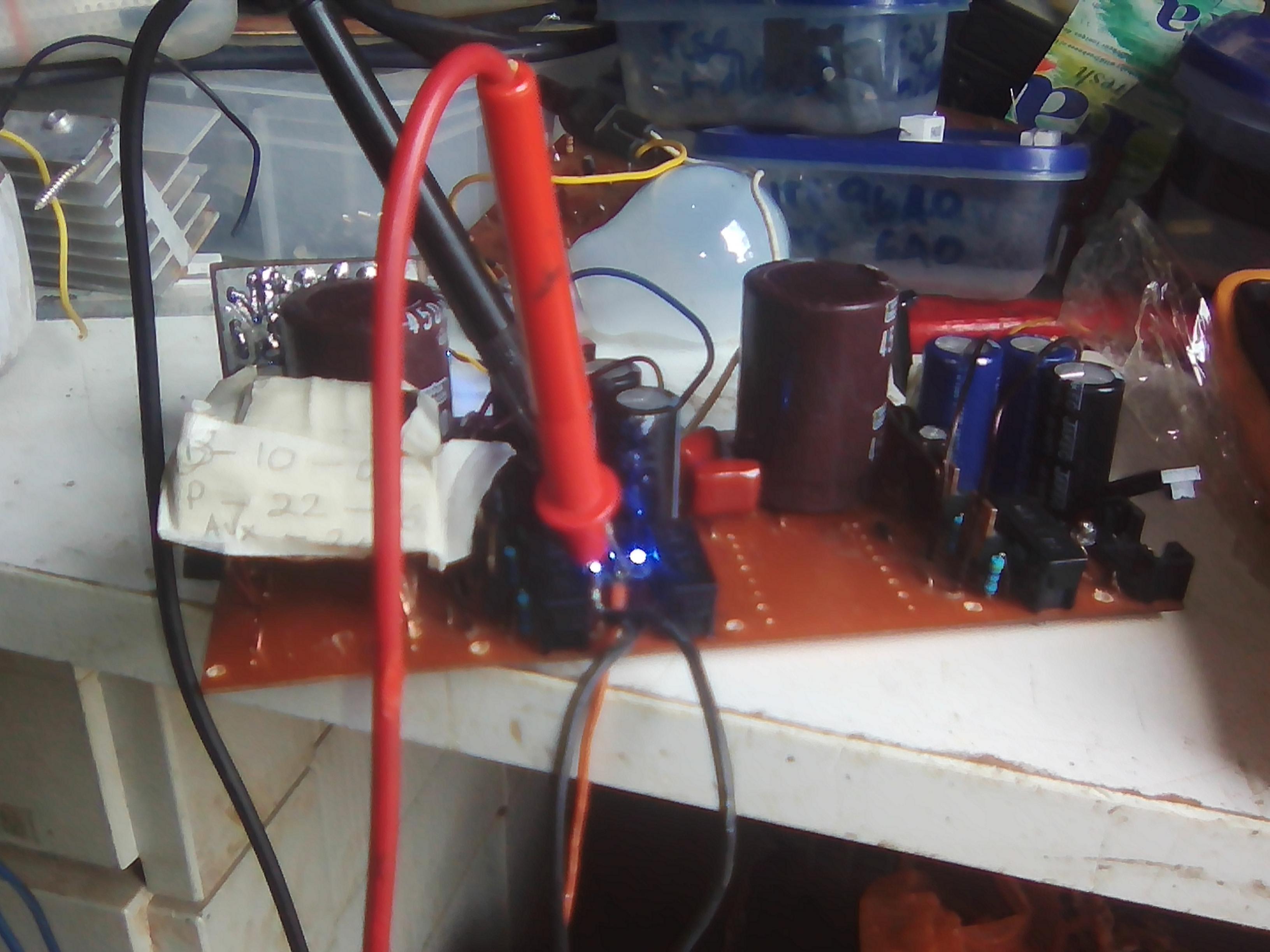

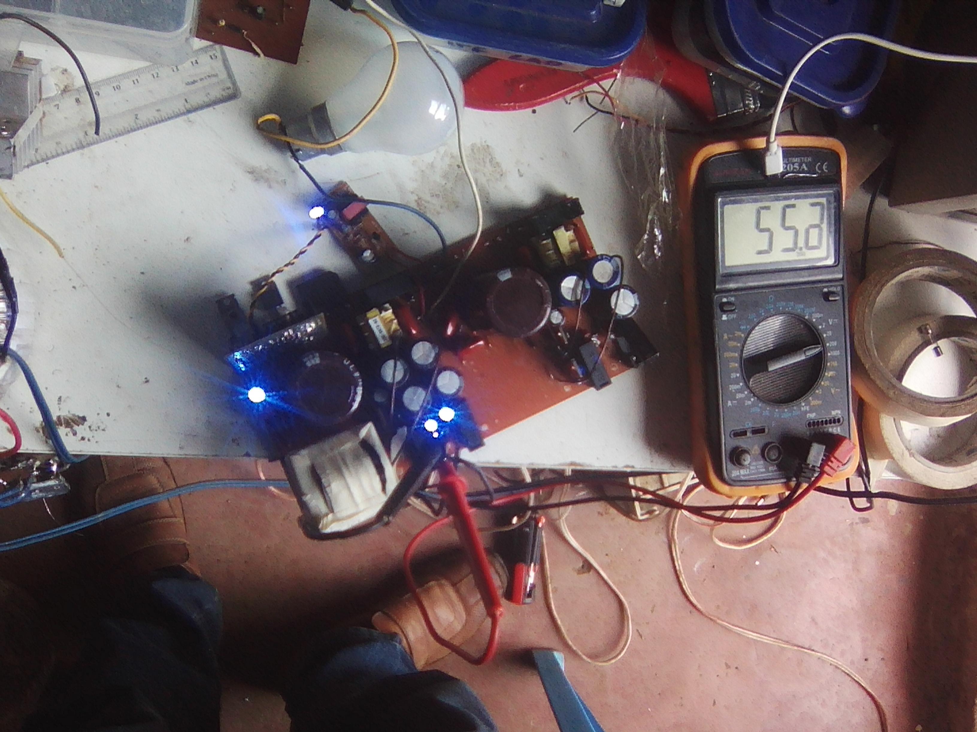

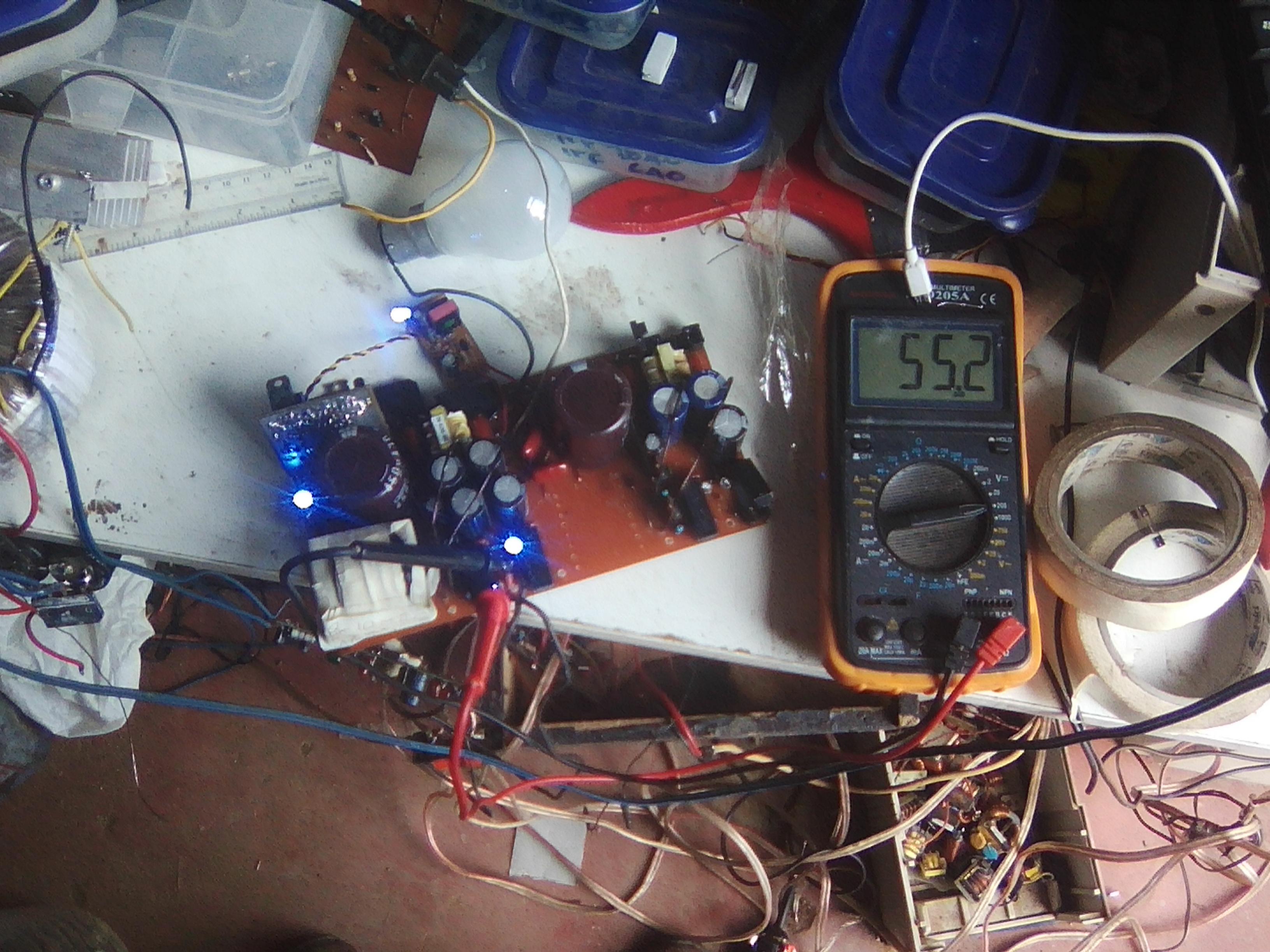

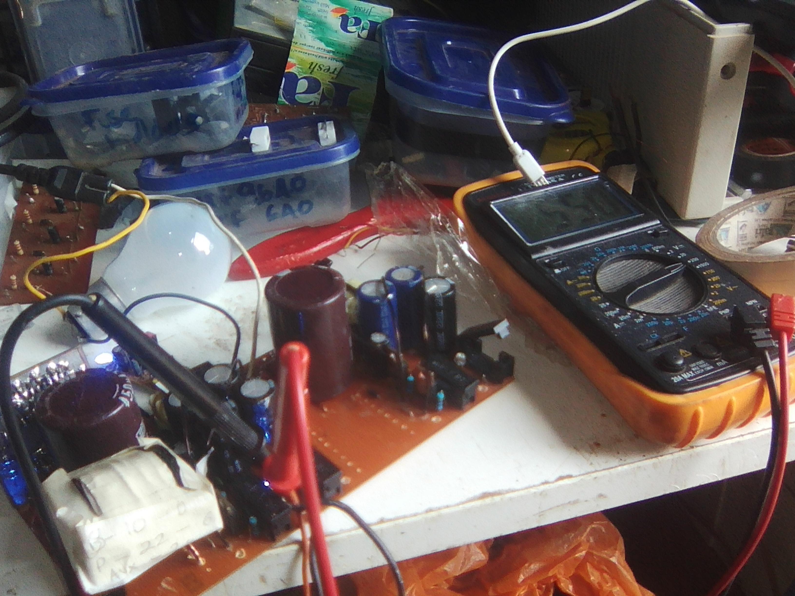

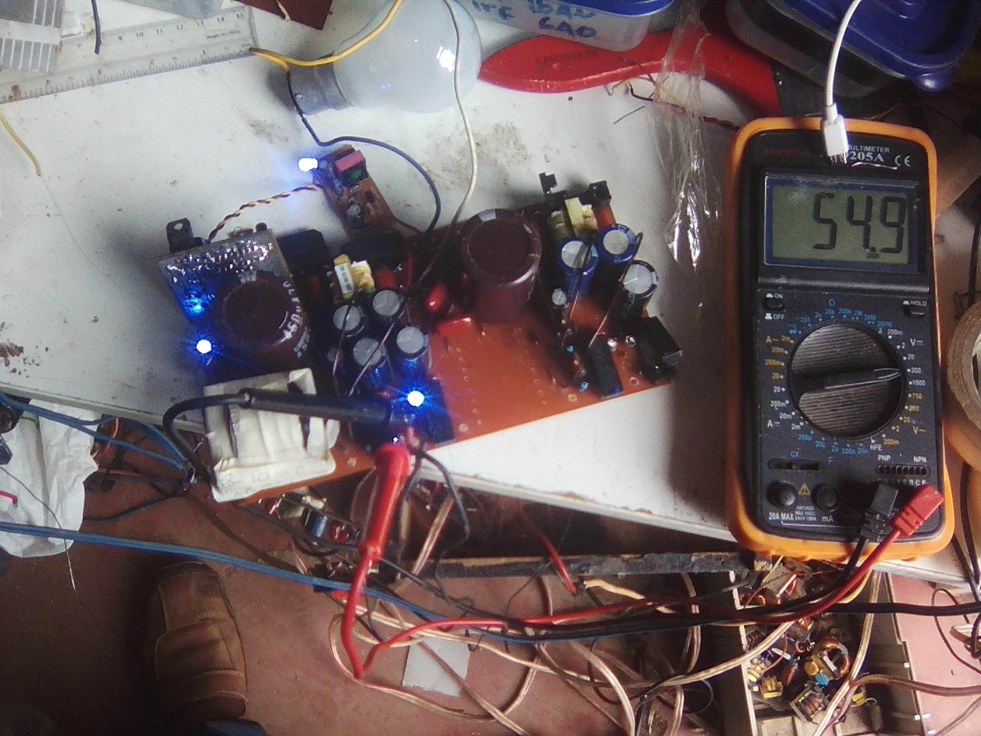

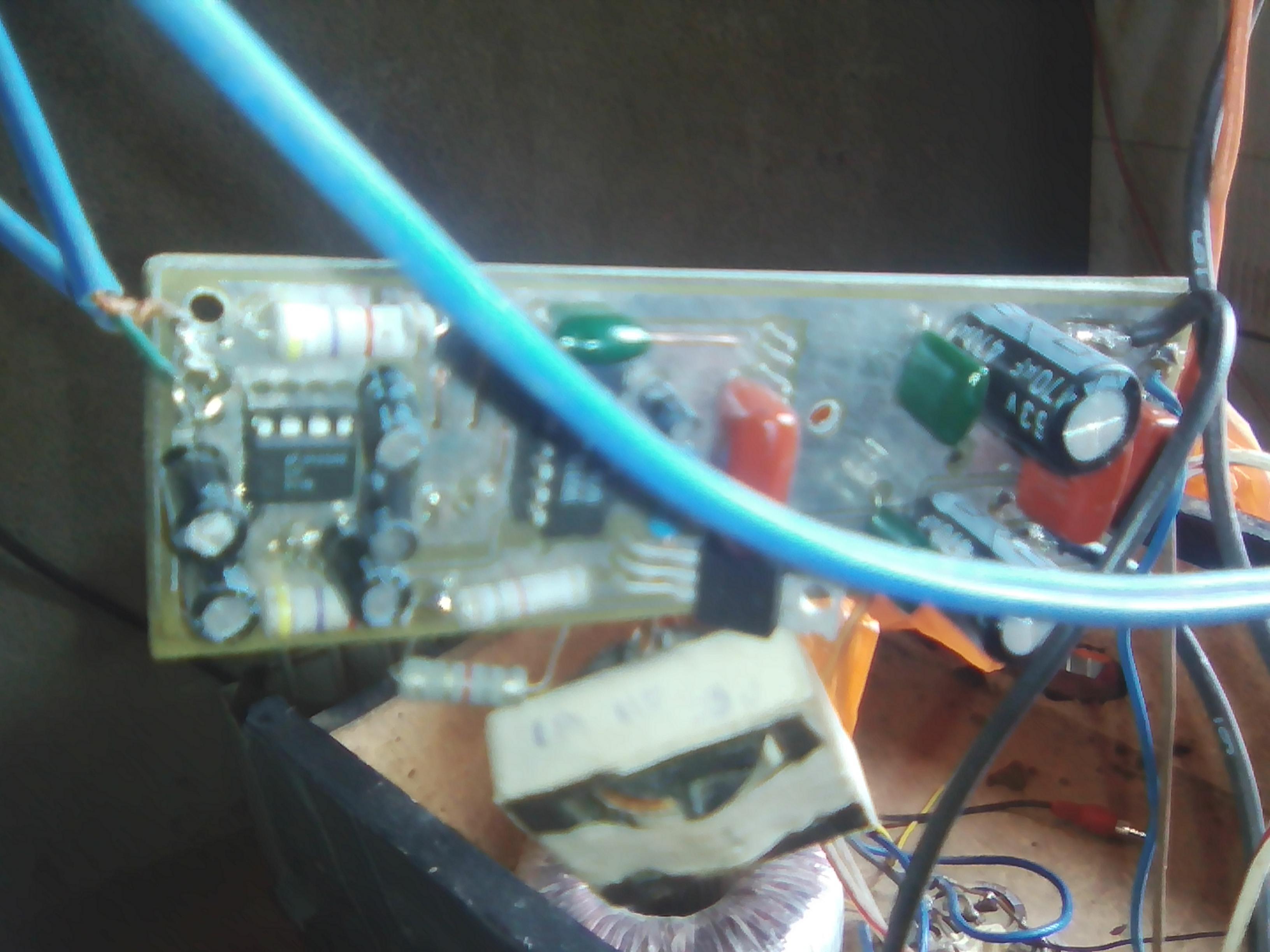

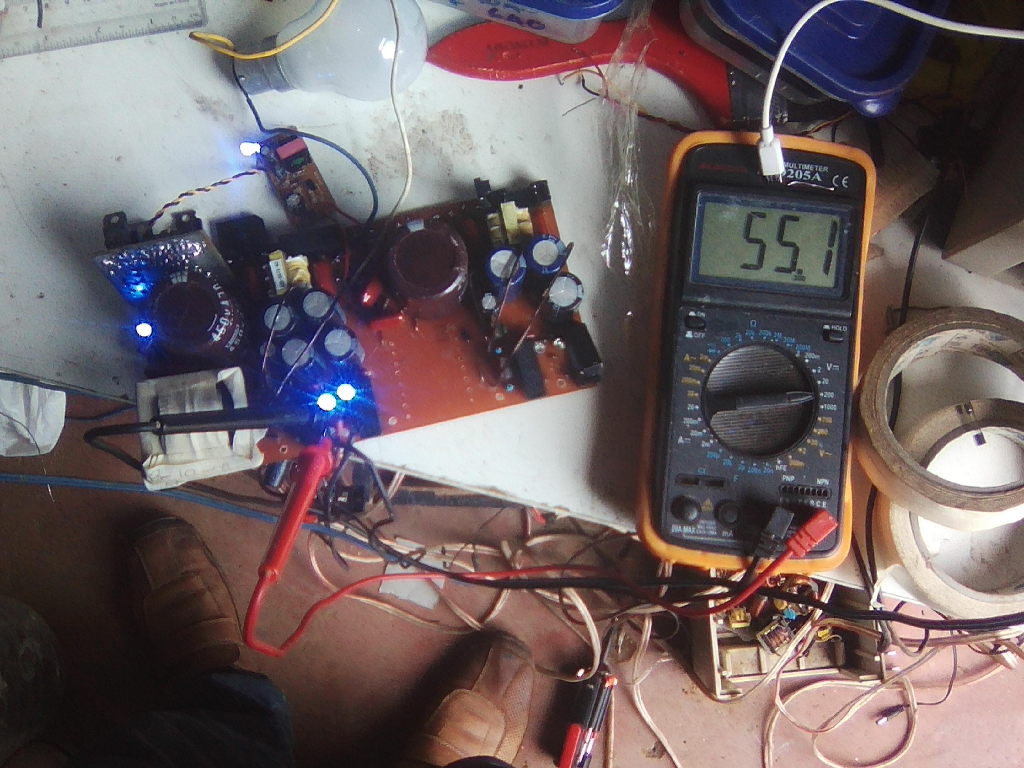

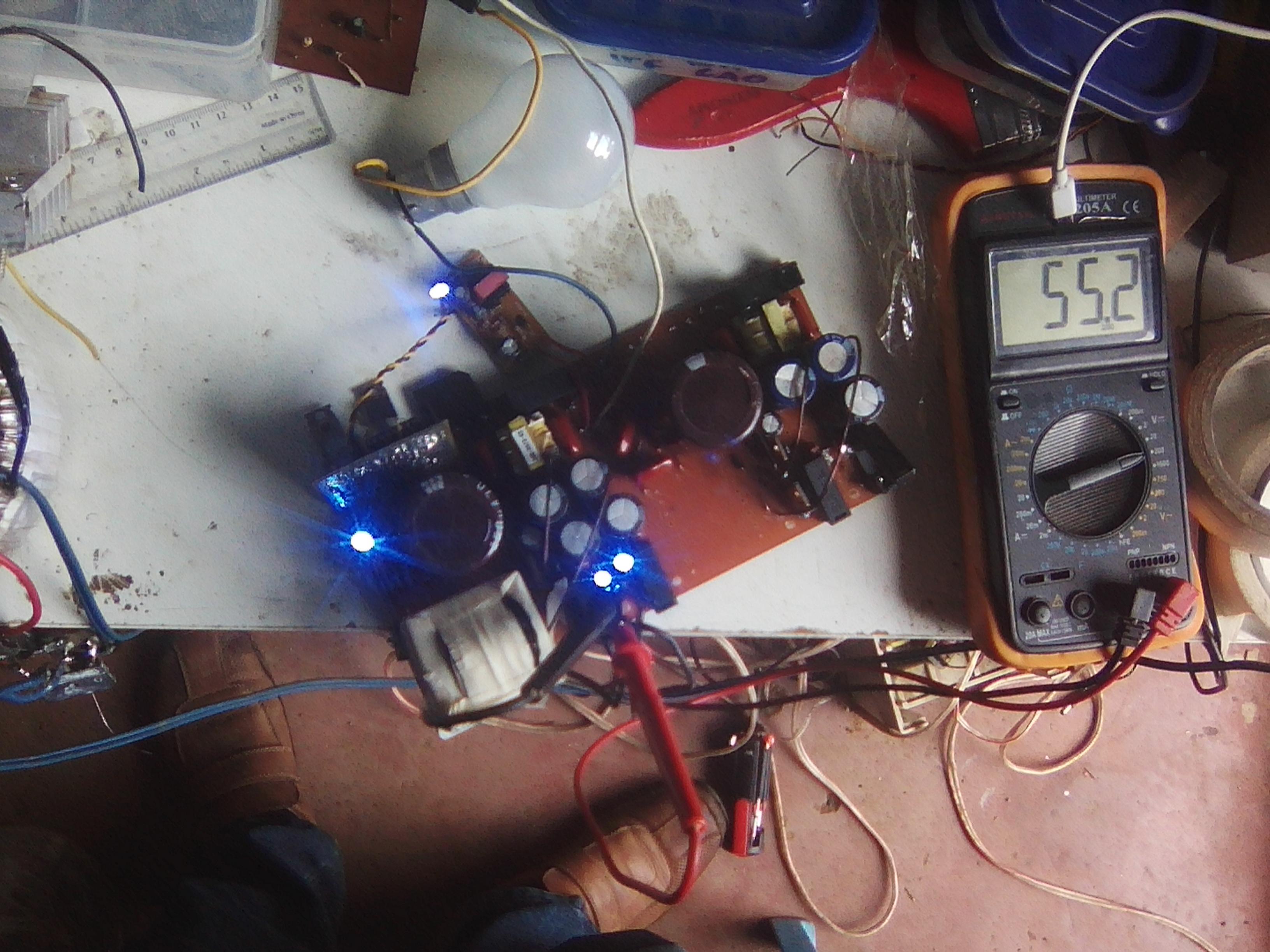

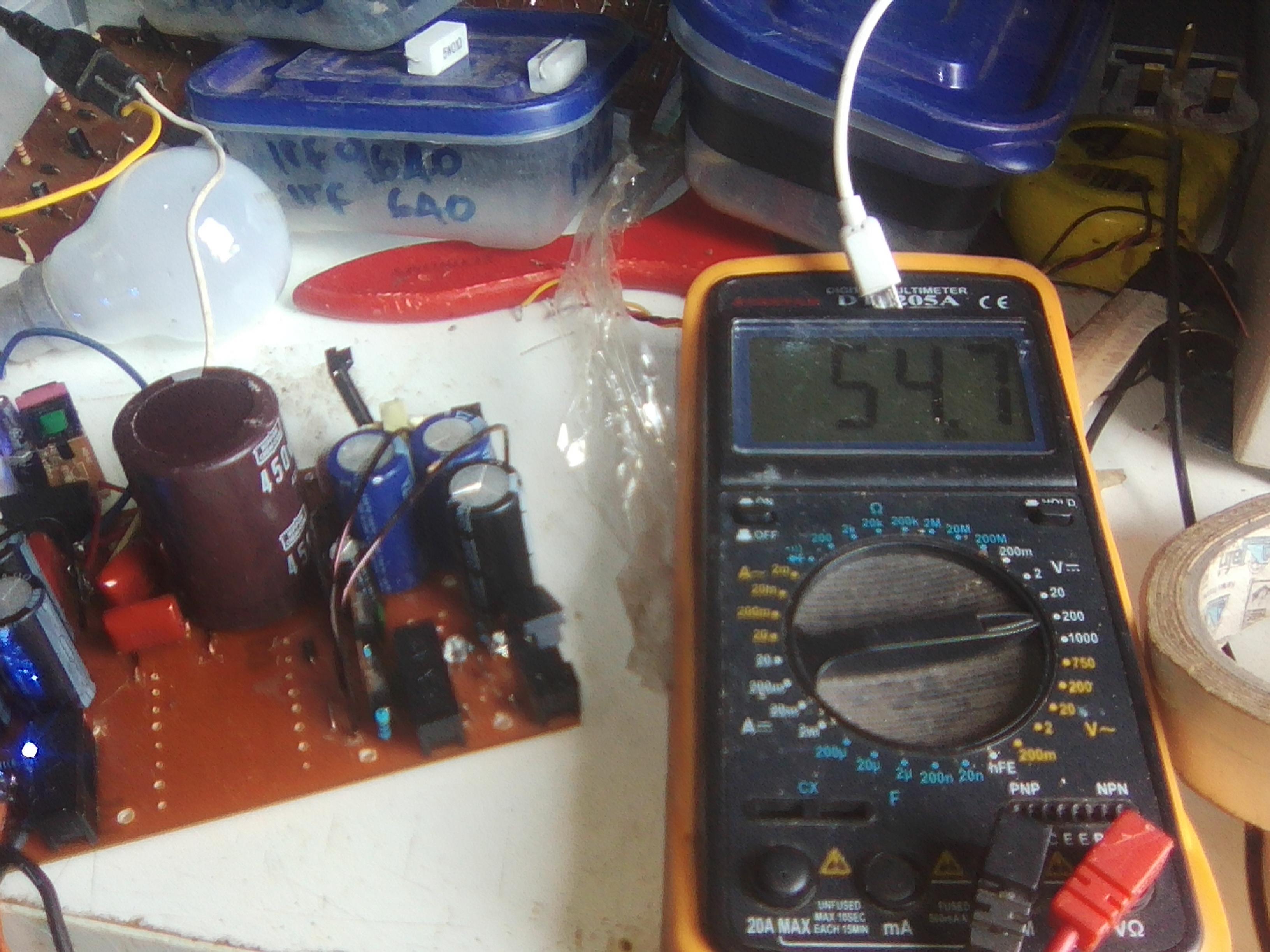

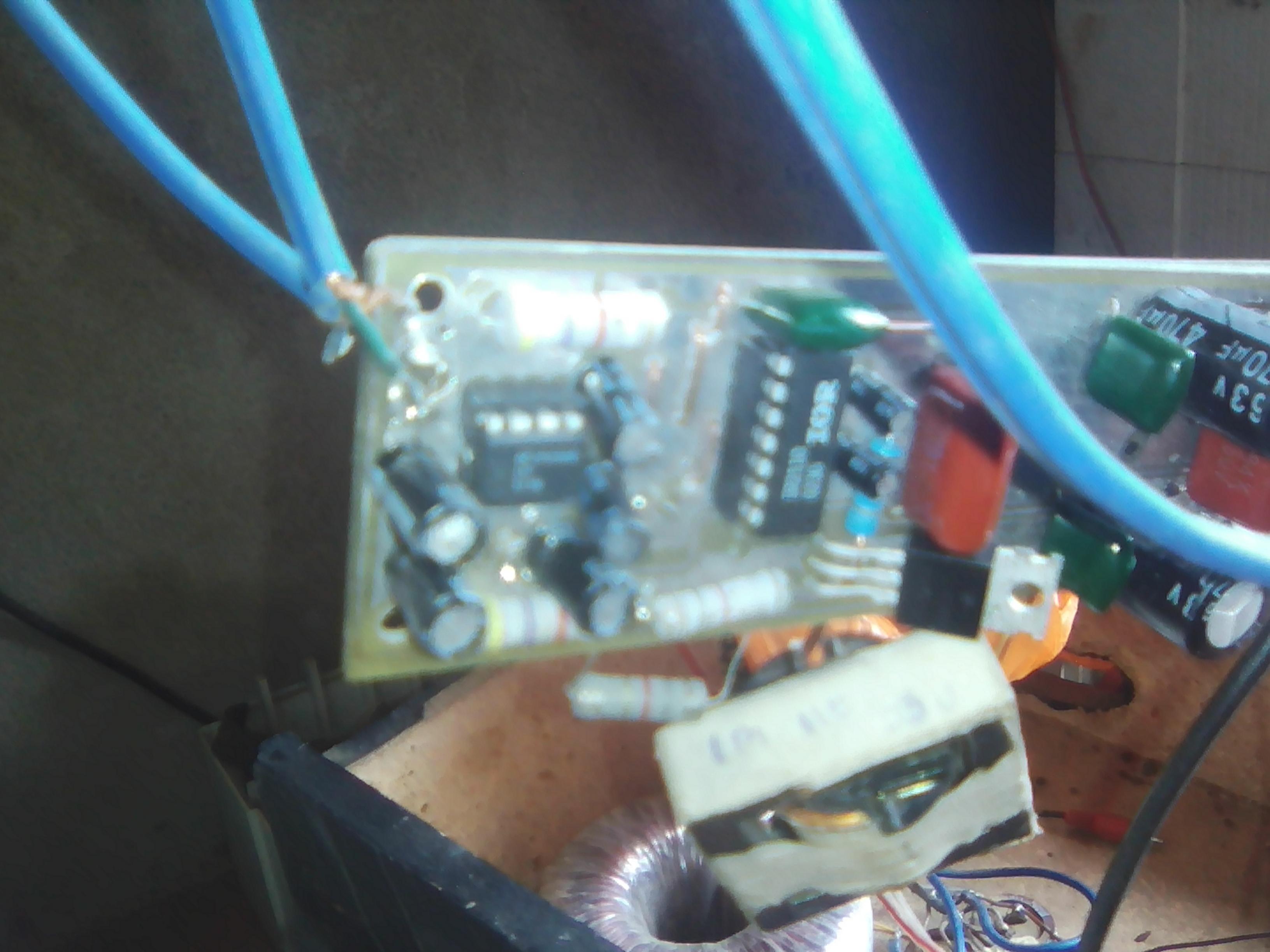

i thank GOD i tested the smps it is working great , the gate drive with transistors works very well. i used 3ohms load at +/-55 vlts ucd class d . the irf 740 smps power fets did not warm at loud playing (i did not mount on heat sink) .i listened about 2 hours loud music all was well.
i chose to use 450vlts caps instead of dual 200vlts because i find many in scrap circuits in my area. here are the photos of my project. i have made many boards. the below is my first photos experience .
the gdt is ee19 1:1 15turns the switching freq is 47khz i.e rt=15k ,ct=1nf ,discharge=33ohms

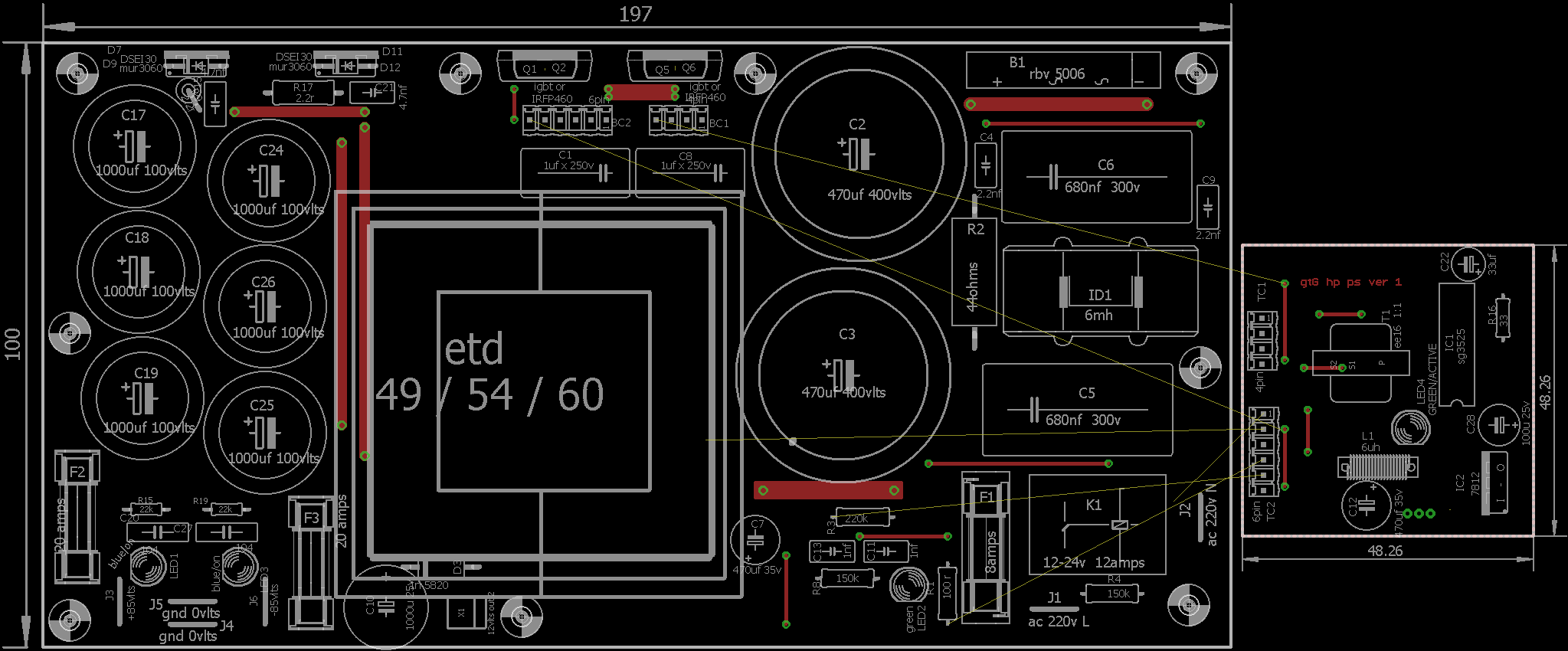

hi all more half bridge boards version for higher power handling .they have more banks in capacitor boards are hp 20cm x 15cm and mp 20cm x 10cm
ideas and suggestions are highly welcomed .have fun and post your builds

this smps works perfectly with irf740 and irfp460lc gdt is ee16 12turn primary and 12turns both secondaries switching frequency used was 45khz. the above 2 fets worked well without mounting them on a heatsink just warmed abit when used load at loud spl note: i did not mount on heatsink . but when i used irfp460a or igbtIRG4PC50/40 they produced a lot of heat within seconds of operation . when increased the switching frequency the igbt ran abit cooler but heat was still too great even though i mounted on heatsink.

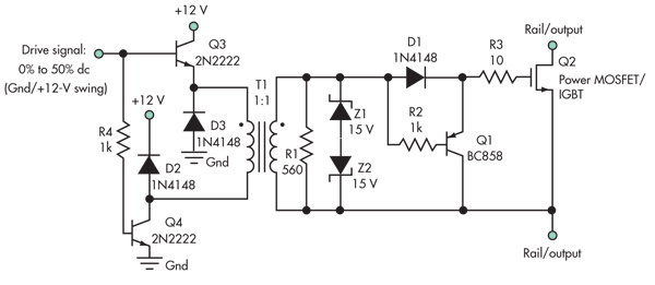

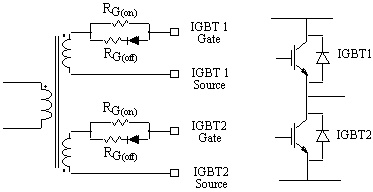

IGBT GATE DRIVE
The drive circuit might need some modification for IGBT, the gate source resistor value is very important 10 ohms seems high.I am attaching photo of gate drive for both MOSFET and IGBT that I am using might solve your problem with IGBT , I have not checked datasheet for the device you are using but will take a look there could be other problems. like the device might not be for suitable for fsw you are using.
Checked datasheet, should work but gate resistor value might need to be lower try 5 ohms and increase as needed but no more than 10 ohms, the IGBT is a voltage device and the turnoff time is important, the photo's of the methods I used seem to work very well but I had to experiment with the values for the devices I used.
