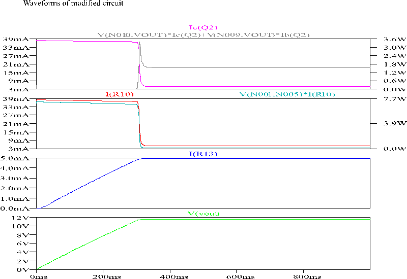

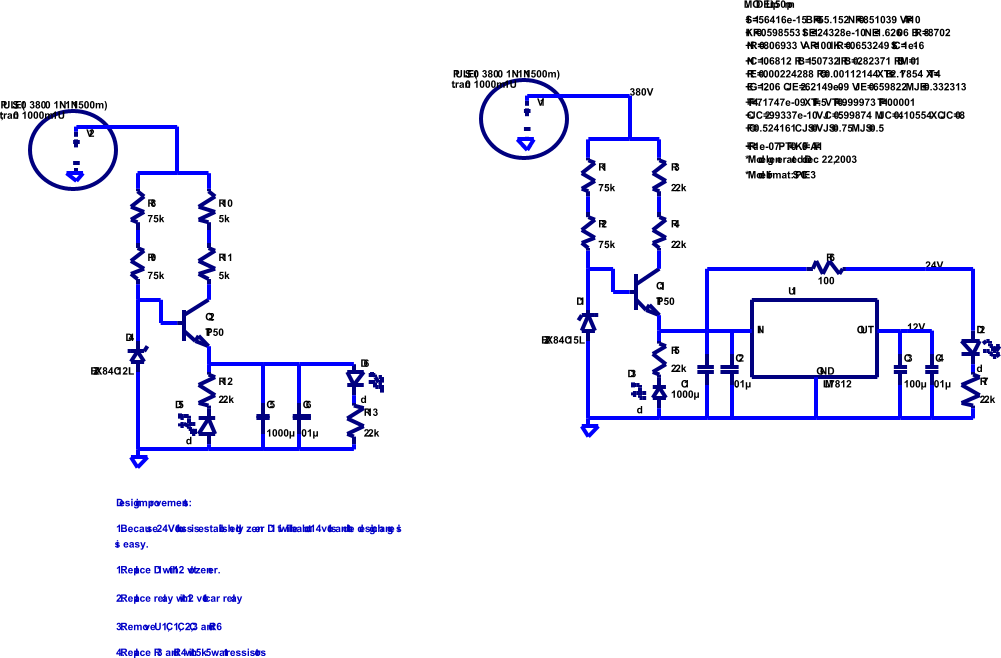

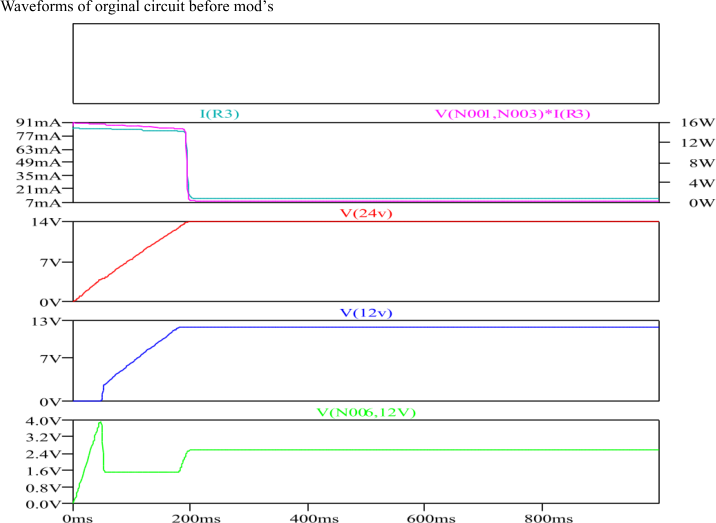

I don't belong to diysmps,as for your voltage adjust and other sections of your design use sources you can find on the web or simulate the circuits in question until you get them to behave and try to stay away from power grabbers like zener regulators that require more passive components(heat generators).A good free simulator is LTspice and its free the learning curve is short and has a excellent forum.I will post a simulation of your design shortly.Check your design before PCB layout, I would make the first one slightly larger to make it easier to find problems and allow room for modifications,I would layout a farm of pads along one side or a corner for design changes of circuits for prototype..small signal stuff.

the corrected schema according to how i changed my board after etching the first one

thanks chas 1. pls post pdf file some components are not visible. i will modify and post the schematic thanks again and GOD bless you .

If you have LTspice and would like simualtion files I will post them,also on voltage adjust
zener's are best choice for you now,I have simulated the circuit in your schematic I think there is a better solution,will post later.While not necessary you might want to include small inductance after output caps 30 to 50 uh wound on a single core onev and connected in both +/- outputs with polarity reversed.
