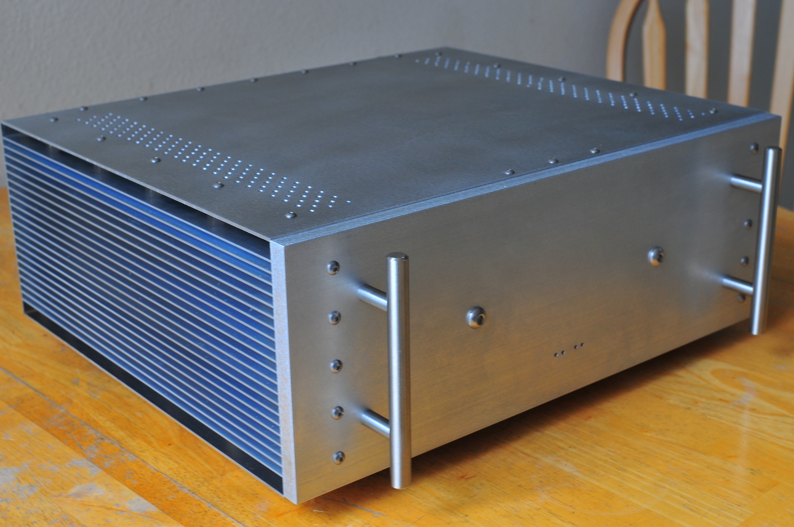

Dead silent!
......and a very good build.
no need for fan , if you make slot at (both) circumference(s)

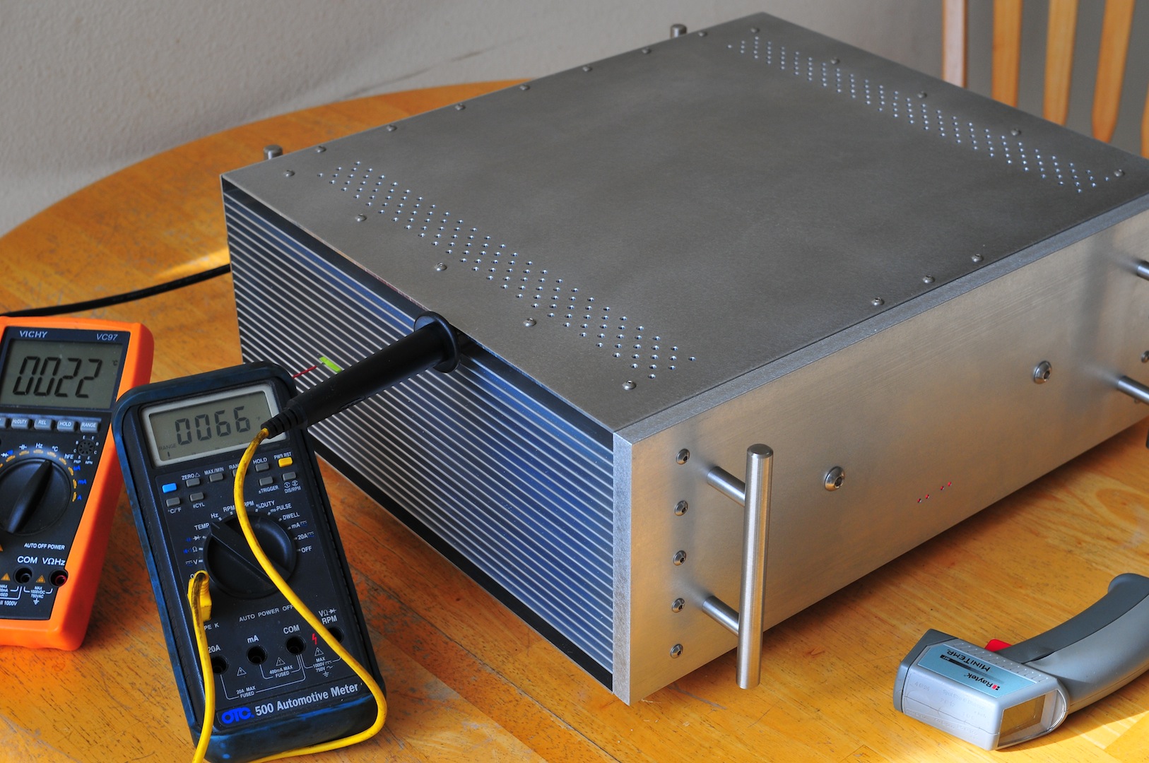

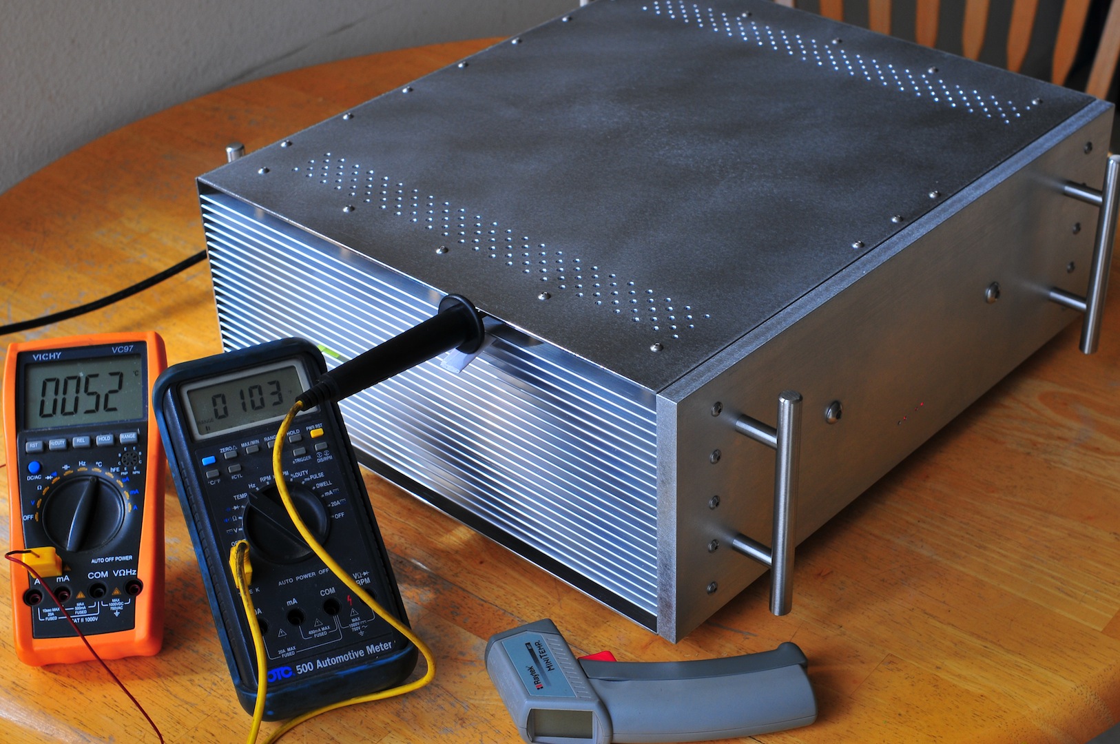

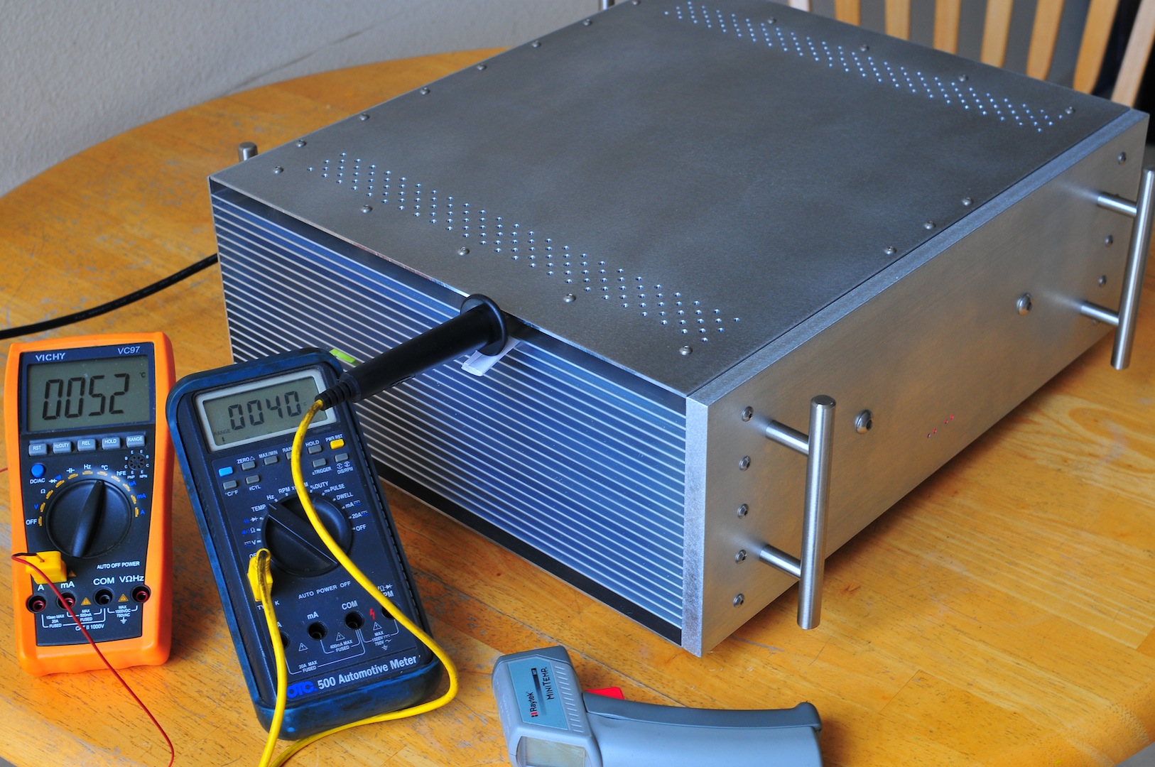

I take a quick look on the top plate, I can put 1/4" standoff to get better ventilation but the bottom plate as part of the structural, spacers going to weaken the whole enclosure. May be drill more holes on both top and bottom plates. I don't like slot because I don't have CNC mill. If by handheld power tool that will need a complicated jig to accomplish. Let me think about to see that what I can come up with a simple way to make a fixture that can tackle the slots.
ZM advice taken
5/16"-24 nuts were installed last night as suggested by ZM. There are 7mm gap create between the top and bottom plates. I fired up the amp this morning with one temp probe attached to the fin of the heatsink the other air temp probe placed inside the enclosure to monitoring the temperature. The temperature rise to 52-53C, inside temp up to 40C after 3 hours of idling. I feel more comfortable while listen to music without the concern for the temperature.
Thank you ZM!
