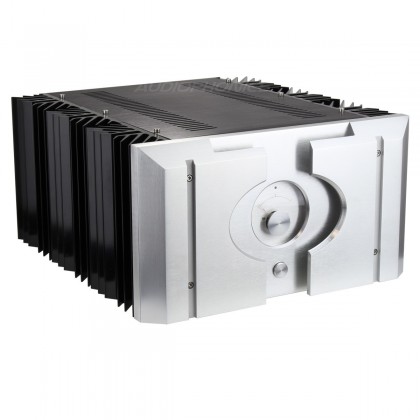

I am going to build M2 and I'm looking for chassis.
Could this one be suitable ?
The size of the heatsinks is 360 x 195 x 50.
Internal dimensions 240 x 360 x 188.
Boitier DIY 100% Aluminium ventile avec Vu-metre & dissipateurs 396x360x195mm - Audiophonics
Could this one be suitable ? ........
not taking in account that case is certainly non-authorized knock-off of PL chassis ........ you can squeeze (thermally) 4 channels of M2 in it ..... and still having some leeway
