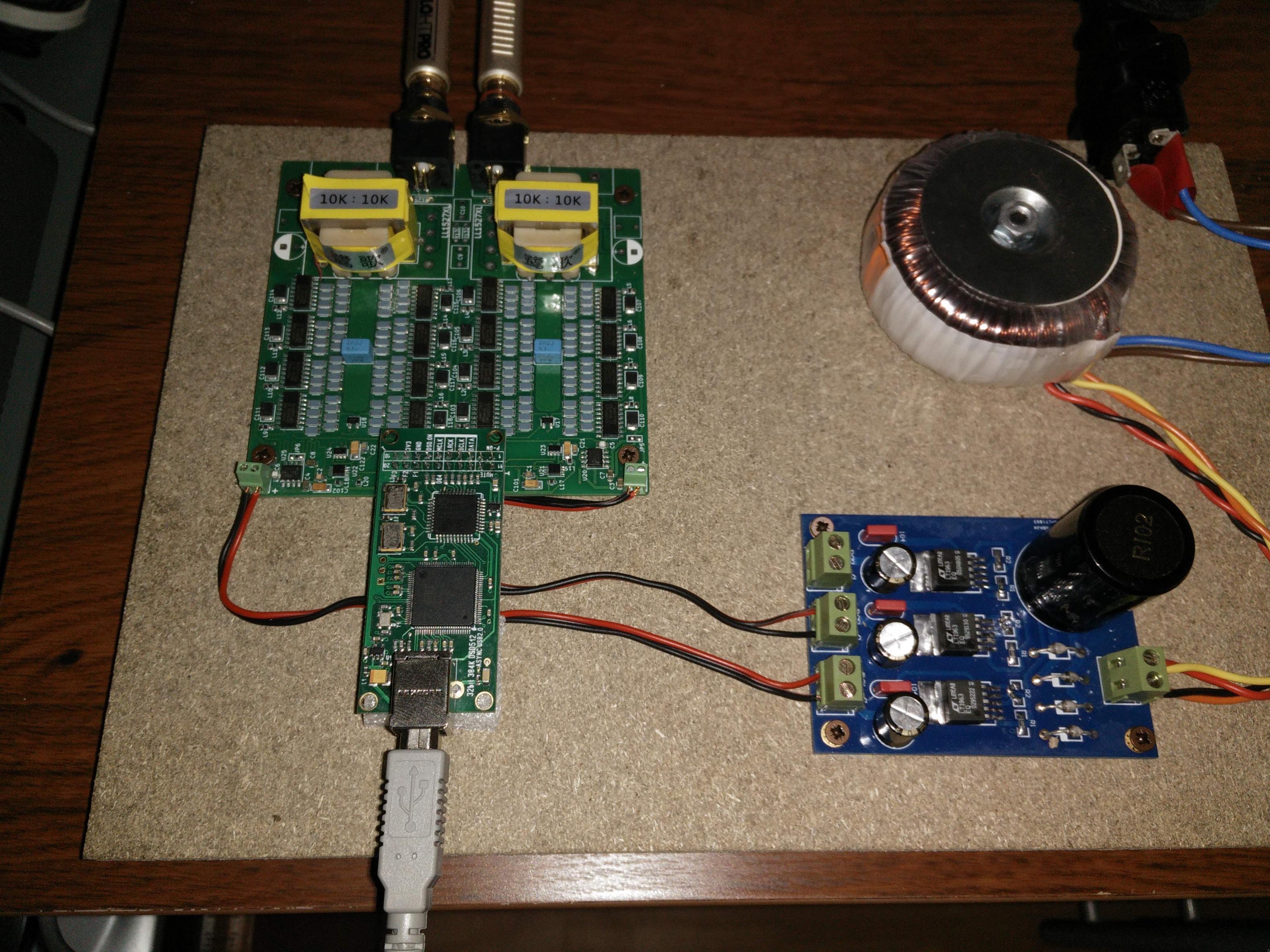

my dsc 2.6.2 is working.
Do, my BBB is rev C. I think all will be Ok with all revisions.
Since rev C has 4GB eMMc (instead of 2GB), I'd recommend to use SD with older revisions.
