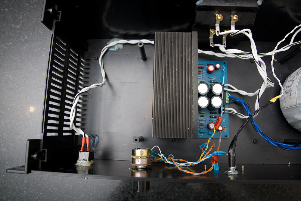

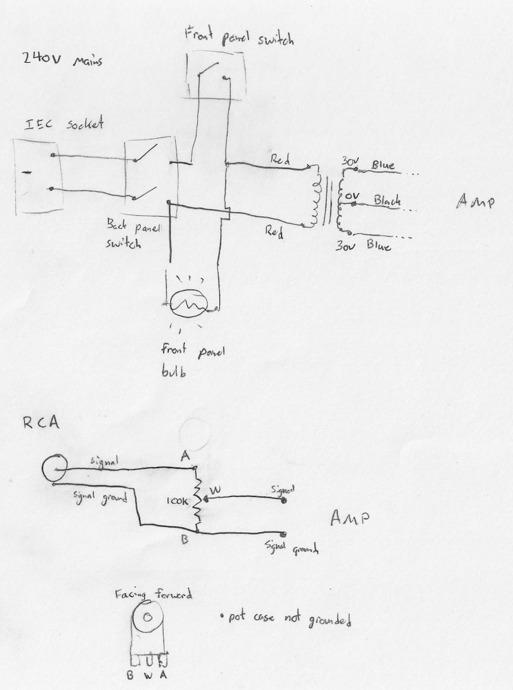

I've created a diagram showing the current case wiring scheme. I've also attached some up-to-date pictures.
From what I've read I should implement a "star" grounding scheme. I'm not sure exactly how to do this due to the plastic case. Exactly which parts in the attached diagram should be tied earth?

Star grouding means tying the different grounds together at a single point in a way that no loops exist. That point doesn't necessarily have to be on a (metal) case, though.
But since this whole thing is on just a single pcb, I don't see how you could have a ground loop. I assume there's just a single GND on that pcb to which both PSU- and amp-sections connect.
EDIT: I can't really judge from the pictures, but both LM3886 are electrically insulated from the heatsink, aren't they?
Why aren't both pots connected the same way to the pcb? From what I can see in the picture, on the pcb there are three holes for each of the pots to connect to, two of which have markings beside them. The white and blue wire are connected to the positions with the markings, while the orange looks to be connected to the unmarked position... Didn't you swap something on one channel (and perhaps with it a signal-GND)?
Actually, star grounding means that each "ground" point in your circuitry has its own separate ground-return conductor going back to the power supply ground (which is often between the main filter capacitors' "ground" ends).
In practice, they don't all have to be separate. But you definitely don't want your amplifier inputs' reference-ground points sharing any length of ground-return conductor with any ground-return conductors that might carry any fast-changing or large currents.

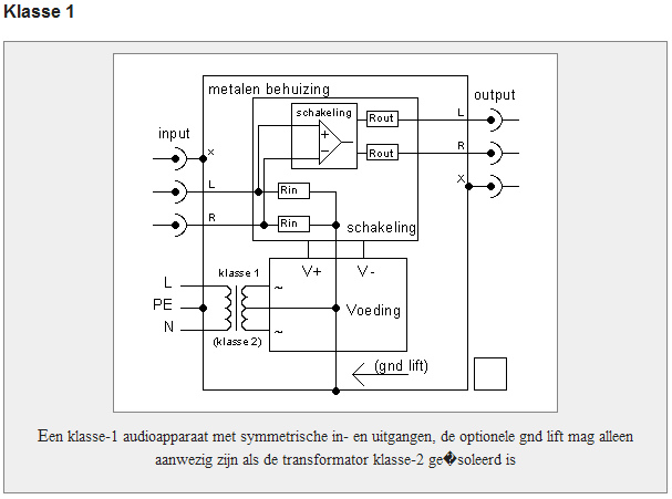

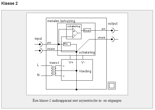

Appliance class I devices have fundamental insulation only. The metal casing of these can be connected to PE. These can be recognised by the earth symbol and a three conductor power cord.
Appliance class II devices have either fundamental insulation combined with extra insulation or reinforced fundamental insulation. These devices must not be connected to PE. Recognisable by the double square symbol and a two conductor power cord.
In audio equipment, usually only (professional) equipment with symmetrical in- and outputs are constructed as a class I appliance with PE. In that case the X of the XLR-sockets are connected to the casing (and thus PE).
In consumer audio equipment with asymmetrical circuits constructed as a class II appliance, PE MUST NOT be connected. Not only because regulations say so, but to prevent interference with audio circuits as well. That's why they come with a two conductor power cord only.
In electronics factories PE is called "dirty earth" for a reason. All ESD protected areas (EPA) are connected to a separate earthing system dubbed "clean earth". PE and clean earth interconnect at one point only.
The two attached diagrams are (partly) in Dutch, but you'll get the picture (schakeling = circuit; voeding = power supply; metalen behuizing = metal casing).
The subscripts read:
Class 1: A class 1 audio device with symmetrical in- and outputs, the optional gnd lift may only be present when a class 2 insulated transformer is installed.
Class 2: A class 2 audio device with asymmetrical in- and outputs.
