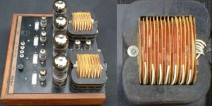

Progressive winding used to decrease layer to layer capacitance. For example: 10 turns forward, 9 turns backward (see picture attached). Another benefit of this kind of winding that it is possible to distribute very smoothly large number of turns in single section.
However, properly designed audio frequency toroids don't need it. In other words, its possible to avoid this increase of complexity without sacrifice of product quality.

Please note that progressive winding to lower layer to layer capacitance only tackles one of the capacitive components in a transformer.
The primary by itself also has a capacitive component, the longer the wire the more capacitance.
Therefore choosing a big core with "little" copper is IMHO always better than a small core with "much" copper (apart from nowadays catastrophic copper prices!).
With the big core / little copper combo the lower capacities and DC resistances (copper losses) make better transformers.
