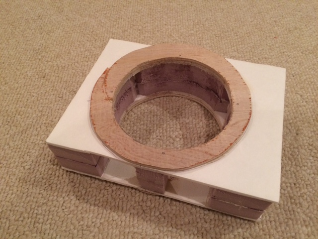

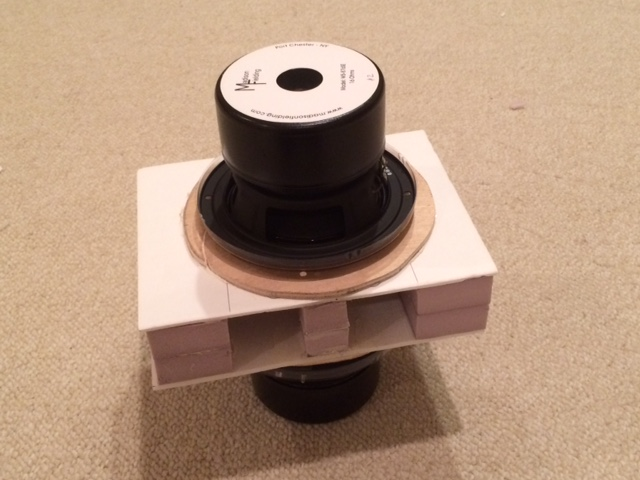

I ended up making the slot out of two layers of 1in thick pink XPS foam and two sheets of foam core. I then glued a 3/16in thick Sureply disc (left over from driver cutouts on another project) on top of the foam core for supporting the drivers which are rather heavy as they have huge magnets. There is no way the foam core would have supported their weight. Now I need to find some threaded rod and need to use a jigsaw to cutout the driver holes in the Sureply. There is a spacer block made of XPS in the slot to support the 4th bolt. I can make the compression ratio whatever I need by cutting the exit ports to the appropriate size. The foam is glued with hot melt to tack and Liquid Nails to seal and provide the main structural bond. It will take a few days to fully harden.
X, is your XPS slot curved in the back like the way I will be building? I would have thought that the XPS foam would provide all the support for the drivers and that the foam-core would not need to support any of the weight.
It's not curved (yet) because I made it by glueing strips of XPS cut from scraps as I did not have a large sheet that could be cut with a curve in back. I could glue little corner radiused fillets in to make it curved I suppose. The way the driver holes are located relative to how big the slot has to be to accommodate the surround movement, there is not enough XPS foam underneath just the 3 edges to support the compression of 4 bolts or threaded rods, and the final edge rests only on the thin sheet of foam core (covered with a thin ply disc). If the ply were rectangular then probably would have been strong enough to handle it. Anyhow,adding a small block may actually serve to constrict the chamber volume some and increase upper extension. My next concern is how to mount this so it is supported by the baffle and base without sagging or vibrating. My experience from my cardboard SLOB tells me whatever efforts one puts into sturdily mounting the SLOB assembly to prevent vibrations is important. It has a lot of energy in it, and it shakes things like you wouldn't believe. The motion is force cancelling but the pressure generated is not. The two wings that cover the side of the baffle are also subject to a lot of vibration from the tremendous back pressure wave. Those need to be braced as well. I wonder if I shouldn't just make a box for it to slip into and turn it to a ripole or double back a lot loaded system.

After cutting out the driver cutouts, it turns out that the inner chamber is now indeed rounded in the back. I should have not skimped on wood and just used a full rectangular pieces on each side. I am not sure if this is going to hold up with the weight of the drivers. The screws will have good ply to hold onto but the ply is supported by the thin layer of foam core (or the glue holding a layer of foamcore paper to the foam) in the shear direction if I were to place drivers side by side vs top and bottom.

A quick test with the SLOB assembly (no baffle) indicates that tremendous pressure forces are generated and the foam core/plywood/XPS rattles and buzzes at certain frequencies. I think this needs to be made with sturdy blocks of plywood. It really pumps out air through the exit ports.
You might want to take a look at the various PPSL threads in the subwoofer forum.

If you go for push pull, you cancel a lot of even order HD ( up to 25dB H2 and 10-15dB H4) and the motor inside the slot helps prevent standing waves due to internal dimensions of the slot. For push push better to model the slot with hornresp.

I was going to go push pull but that would make the chamber volume very large to be able to hold the massive magnet (although the magnet and basket take up so much volume maybe it's not so bad?). This would lower the upper frequency extension. Normally not an issue for subs but we are trying to use for upper bass low mids in the 300Hz to 400Hz range. I used to model these in Akabak and have found that the main thing to know is there is a cancellation null given by slot depth and a band pass overshoot peak before the null. A quick measurement at slot exit plane confirmed this: 415Hz bandpass peak and 560Hz cancellation null. This will allow me to use a 350Hz XO point with some EQ and a 2nd order LPF to achieve the desired 4th order Butterworth target for a Harsch XO. The TG9FD should be able to use a first order electrical and natural OB falloff to get close to the 2nd order Bessel target. For sure, the TG9 will be employed to move a lot given the shallow slope crossed at 350Hz.
good to know, thanks. I will build my version with dual 8" out of solid EVA (well laminated). Given what you are saying, I will overbuild it with maybe 20mm (or 30mm) top/bottom (2-3layer laminate) pieces and the curved 70mm x 40mm thick piece from my earlier photos. I think that I need to use either my normal higher density EVA or the cork/EVA for the top/bottom layers. I still have high hopes that the elastomeric EVA with drivers bolted down with solid threaded bolts going all the way through will work to control the vibrations and rattles. Busy this weekend, but I might be able to do something next week.

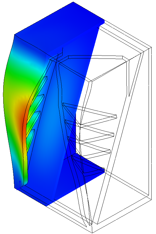

I am rethinking the SLOB. Maybe my KaZba would work better - dipole with higher upper extension yet good slot loading that is aperiodic.
http://www.diyaudio.com/forums/full...zba-dipole-k-aperture-z-baffle-dipole-19.html
I have shown that it can get 35Hz as an OB dipole with a pair of 8in drivers.
Mudjester even helped with analysis of bracing schemes:
