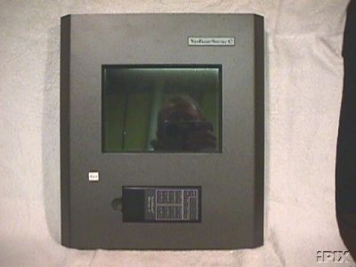

My ViewFrame Spectra C has stopped working after being left alone and unloved for about a year in its case. It displays the NView logo and occasionally shows DOS when the computer is booting up but otherwise just ignores the VGA input. I have all the right leads, have tried two different computers and two different leads (it came with lots.) Any ideas? As a State school teacher I want to use this in class now but it is resisting me...
Many thanks

Hi, can you guys help me out here a little?
I just got a nView ViewFrame Spectra C from a friend who also got it from a friend but didn't want it. So here I am almost clueless as to what it excetly is Figured out that its a projector, plugged it into my PC and everything.. finally got the projector to display what's on the monitor as well. But the display is very dark, hard to see. If i hold the projector up to the lights, I can see and almost read the texts on it as well. If i have it sitting on the desk, it looks as if the thing isn't even on. Question is... isn't this thing supposed to project out like any other projectors? I've got 4 projection lamps in the case but no idea where to put them... hmmm.. Sorta lost.. any help would be appreciated.
Projection panels are a lcd with a controller board built in, usually able to accept multiple signals. They are built to be placed on top of an overhead projector (the kind of thing used in schools) and the overhead projects what is on the lcd. What you have there isn't a projector as much as it is similar to a lcd monitor, both in laptops and as desktop screens. These are specially made to be projected with an overhead projector or using custom lighting and optics to project what is displayed on the panel. Unless you use an overhead or create your own projection box, it is pretty useless.

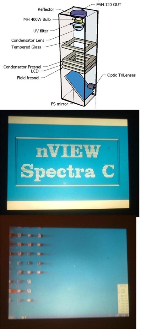

Hello, I’m from Portugal, i have one ViewFrame Spectra C whit this entries: 1 - VGA – (Digital and Analog), 2 – Y/C – (S-Video) and 3 – Composite.
When I plug thru the Composite, the image it’s very bad.
I try whit your squema, plug thru the VGA, and don’t worq.

My PC it’s 680x480, 60Hz, VGA mode.
Can someone, please, tell me watt to do?
pics from PC - TV/OUT to SPECTRA – Composit
Thank you very much for your time

Chet…that squema it’s WRONG !
The pinout for the DB15 Female it’s not like that…
My projector it’s working good, now I discover the pinout.

Re: VFrame Spectra C
Open it up and check for any leaking capacitors.
Electrolytic ones are known for that, particularly when an electronic device sits idle for a lengthy time.

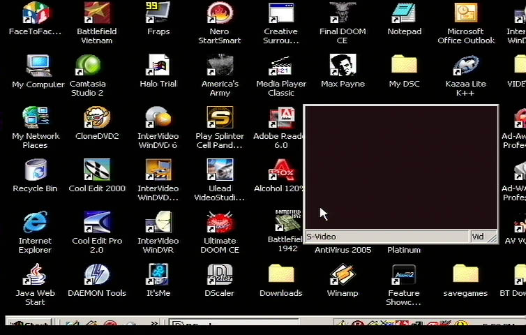

wow, that is some terrible tv output. Is that the actual quality your pc puts out, or is that the panel?
I attached a pic of my Radeon 9000Pro videocard connected into my MSI TV@nywhere tv tuner card with svideo, and with DScaler software.
The screenshot is unedited. The only thing I did to it is compress it into JPG. I think the quality possible with tv out is great.
"I attached a pic of my Radeon 9000Pro videocard connected into my MSI TV@nywhere tv tuner card "
Thats a shot of tv out going into my Tv in. Its taken using the scaling software - DScaler. It shows the quality possible. I didnt just press print screen, if thats what you mean! Its not a camera photo, its a snapshot i took using software, but its not directly the desktop, its the desktop on tv out!
KK, im kinda lost on what its got to do with anything thats all lol. If thats the desktop on tv out, i can garentee you that it wont look like that on a tv, especially if its old, tv's are crap, even for watching normal signal sources.
