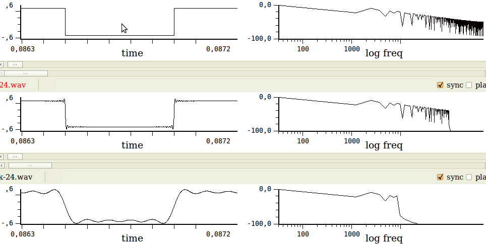

It will, since you are removing the higher-frequency sines "helping" to keep lines straight and edges sharp.
Let's make a little simulation. Let's approximate the analog world by very high fs, e.g. 1MHz. This will produce 10 seconds of 1kHz square at -6dB, 24bits, 1MHz fs, file w1m-24.wav:
Code:
sox -V -r1000000 -b 24 -t wav -n w1m-24.wav synth 10 square 1k gain -6
Its shape and spectrum is shown at the top of the included screenshot. Each period is constructed from 1000 samples (dots), fairly close to the analog reality.
We will limit the bandwidth from the original 500kHz (fs/2) to 100kHz rather sharply (window length of 10 thousand samples):
Code:
sox -V w1m-24.wav w100k-24.wav filter 0-100000 10000
The middle waveform already shows the "ringing".
Reducing the bandwidth to 10kHz only (while still keeping 1MHz fs):
Code:
sox -V w1m-24.wav w10k-24.wav filter 0-10000 10000
The bottom waveform is pretty far from the original square.

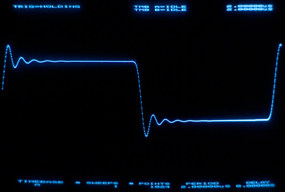

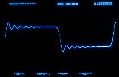

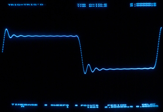

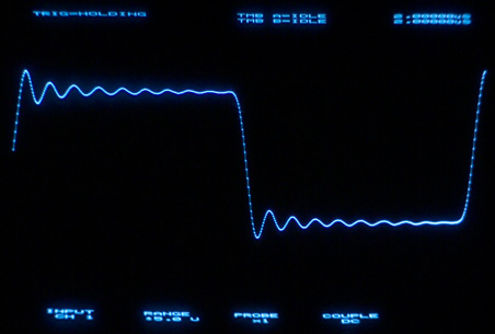

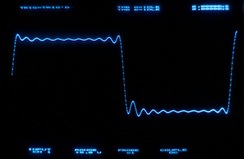

I did another test with a chesky CD: Square 1002,3 Hz
DAC Audio Precision digitally
DAC 128fs ADC
DAC standard ADC
4x os player Audio Precision digitally
4x os player 128fs ADC
4x os player standard ADC
A DVD player looked similar to the 4x os player.
Why does the standard AD converter have no pre-ringing on the os players ? Because the 1002,3 Hz ?
