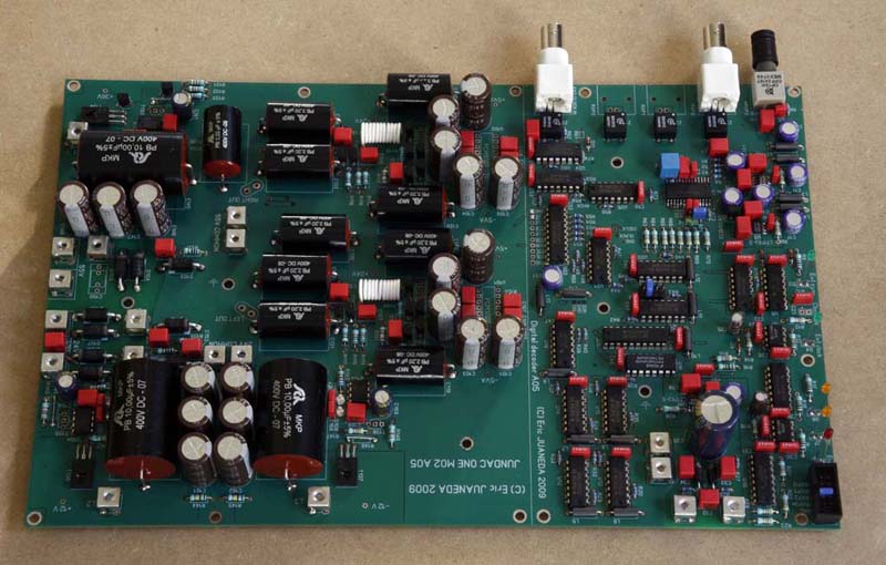

Hi everyone,
There is few DAC where you can adjust oversampling level. The Philips DVP 720SA does. I wrote article about listening comparison.
Listening digital filter
I could listen for a long time many DAC, Up-sampled with low filtering (DAX), Um-sampled with few TAP filter (Wadia X64) and now my personal NOS DAC.
Digital filter tent to foggs music. You loose details, add echo on music (sound depth) and loose natural sound.
Comparing NOS and conventional DAC is not easy, because in some case, digital filter rounds music and it might be very pleasant.
Anyway digital filter is ONLY one part of DAC. NOS or Up-sampled DAC with poor analog stage or poor power supply stills poor DAC.
See picture of my personal NOS DAC (digital decoder on the right and analog stage on the left)
Eric

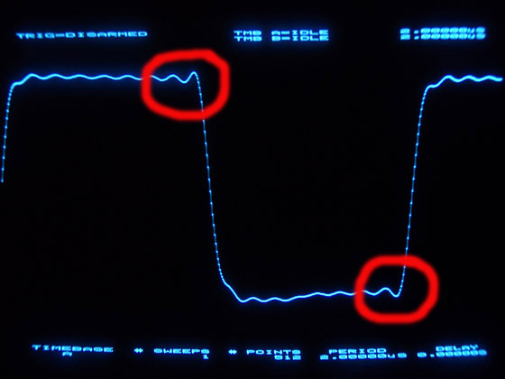

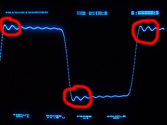

tritosine said:
Bernhard's filter is a relaxed version of meridians filter in analog realm. Meridian has the advantage of cutting down the "pre embedded" (!!!) pre-ringing , so they say.
Quotes from stereophile link posted in #33:
There is no ringing before the main peak, but then about 1.5ms of damped ringing after it.
...the post-ringing was both higher in amplitude and lasted a little longer than I was expecting.
The Meridian digital filter behaves exactly like my passive analog filter, when compared to the Benchmark and the Yamaha,
no pre-ringing but higher amplitude of post-ringing.
The Benchmark shows a symmetric ringing, (pre- and post-ringing),
while the Yamaha is dominantly pre-ringing.
The Yamaha's digital filter is a 20 year old design...
Most important:
While the absence of pre-ringing very likely contributed to the 808i.2's fine sound...
Seems to confirm that the sound of analog filtered non os is superior to modern "off the shelf" digital filters.
