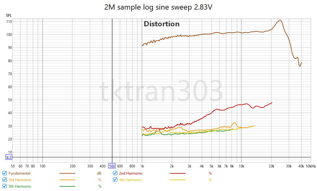

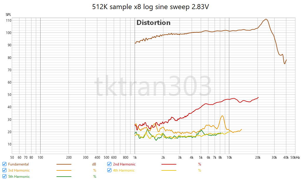

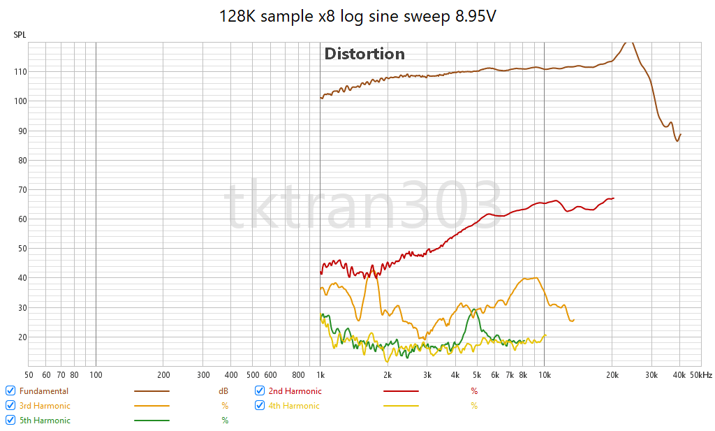

Noise sensitivity of different measurement algorithms - graphs
I tried the method I described in the "Measurement mics" thread in real life.
The results:
1. Old method, as per Matlab 2019b release of non-literal implementation of A.Farina 2007. Sine sweep turned out to be a "Log Chirp" from pre-historic era. Deemp of -3dB/octave is due to log sweep.

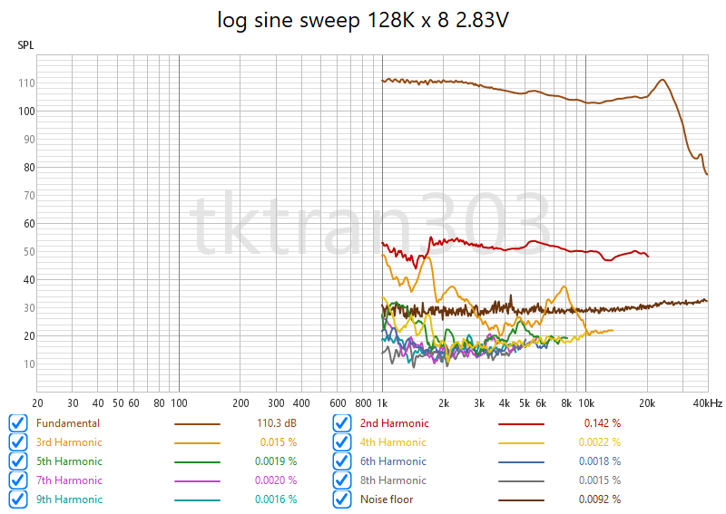

Are these Matlab routines without error now? At my time at University that was not the case ...
2. New method, without noise RIR reduction. No deemp. Quite a difference on low frequencies.
Frequency response is wrong here? Only the de-emphasing? Sorry but it's hard to compare measurements when they are obviously different ...
(Never do this in a meeting with group leaders or R&D leaders. These are often pretty intelligent people, detect such flows on the go and will immediatly throw back your results)
But a great example of better analysis giving significant better S/N at low frequencies!

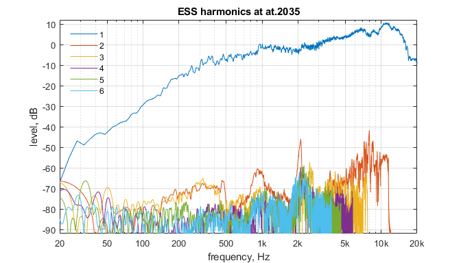

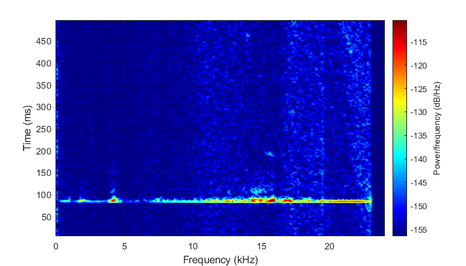

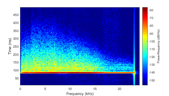

3. Here I run into a problem with the denoising of harmonic responses: I do not know what is important and what is not.
Let's look at the Spk+Room main RIR spectrogram: You can not see the 2kHz 2nd harmonic presence in the RIR spectrogram. You won't see anything on the 3D waterfall either.
Now, let's look at the 2nd harmonic IR spectrogram: You can clearly see the long decaying tail on 4kHz. That means this driver rings on 2kHz with distortions for quite a long time.
Let's look at the 3rtd harmonic IR spectrogram. It is clear that the distortions do not follow exactly Xms after the main ridge, there is a blip delay at 7.5 kHz.
I am not sure if looking at further harmonics, like 4th, would be interesting for anyone except stubborn perfectionists:
As "Standard" subband denoising like EM-84 could throw away the details that may be important, I would like to ask for opinions on what information you would like to see, and what can be scrapped as noise.
First and most important - I need a logarithmic frequency response! You quickly see when someones background is not Audio when they show a linear frequency axis :geek:. The problem is you missinterprete errors and problems or don't even see them with linear axis (this often happens with vibration measurements).
When your noise reduction has (significant) influence to the harmonic ... you have a picture, not a measurement. These graphs are very hard to judge (I only use them for vibratoin measurements if needed). What when you make improvements to your speaker and distortion is reduced 15% ... no way you can see it here.
Sorry to spread bad vibes here ... but these are points which need improvement when you want to design/develop better measurements for audio devices! And we all could need them!

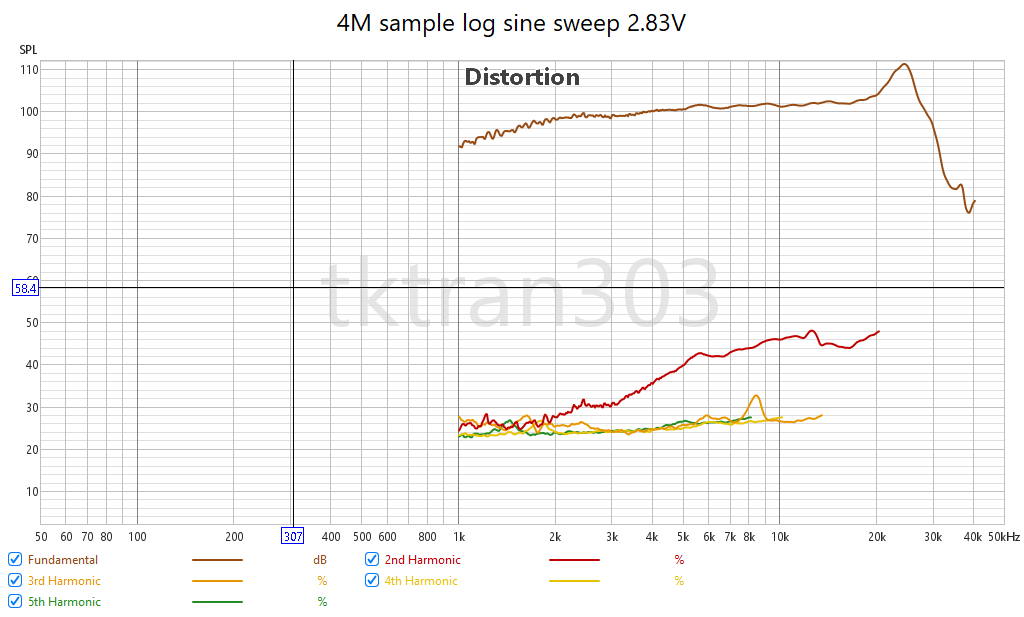

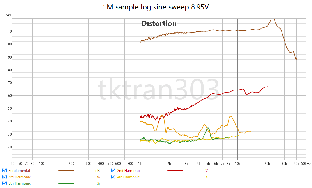

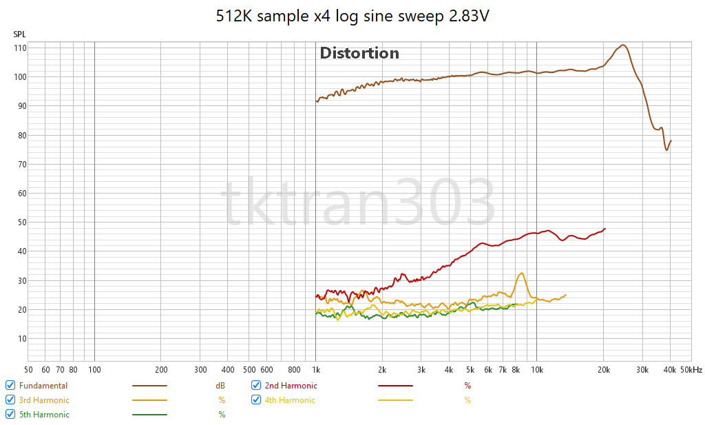

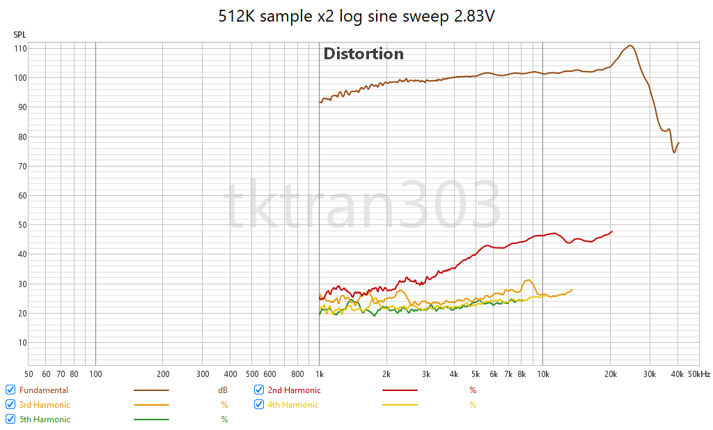

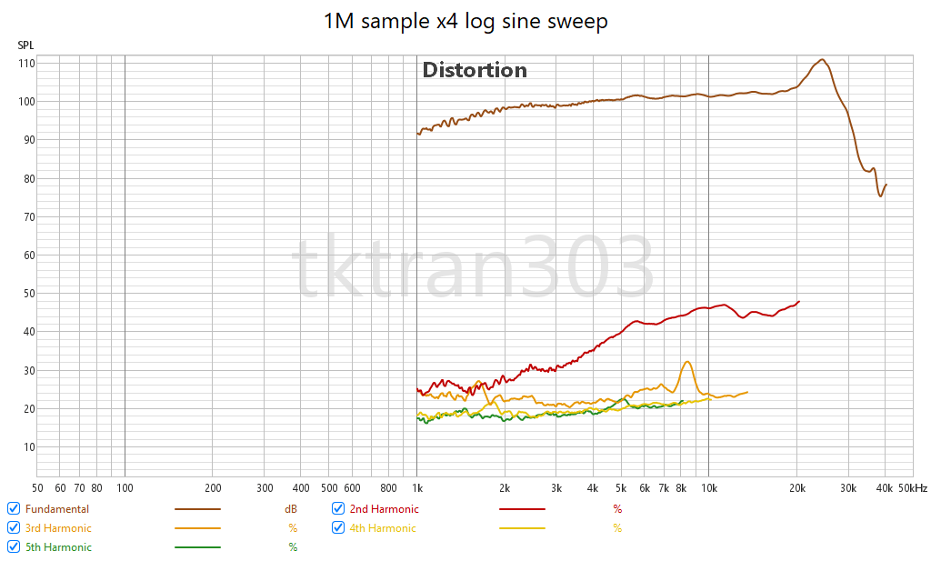

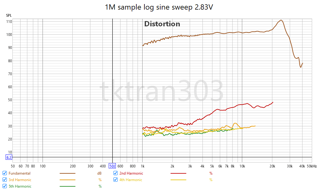

Looks like REW doesn't benefit from longer sequence length after some point. But averaging works perfectly and does what it should.
You also see that higher measurement signals gives improved S/N.
It yould be helpful to have the same y-axis at all your measurements you compare! (e.g. 10-120dBSpl) I was wondering why noise floor went down at your higher level measurements ... it doesn't, scale changes ...

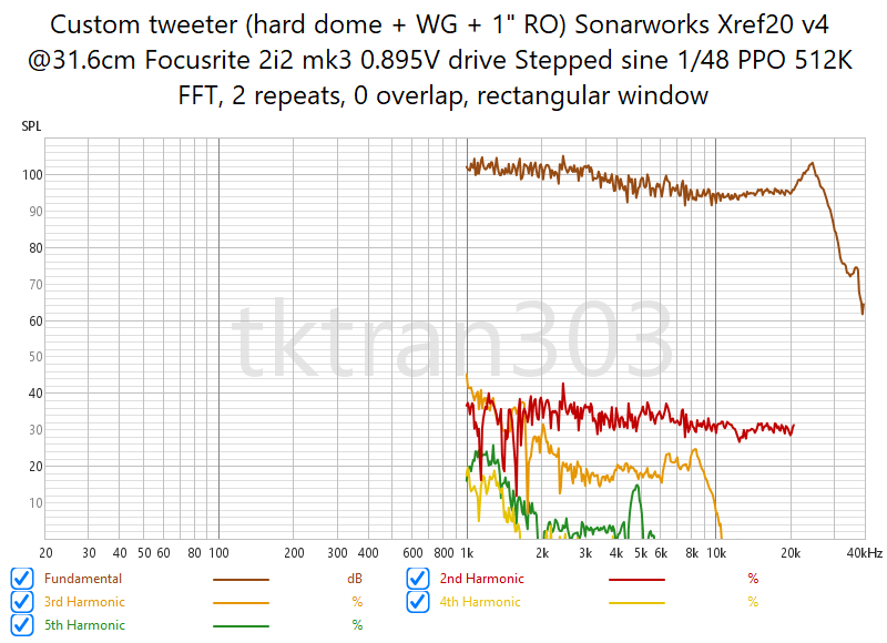

Stepped level sweep.
Stepped level sweep. An old but standard measurement signal and analysis. 31 dedicated sine frequencies and you measure the level.
Yes, ok, but, where is the "sweep" ?

I did address that. In the "old days" when I was starting, the sweep was analogue. We swept the frequency up by hand at first. Then we had voltage controlled oscillators that could sweep with a sawtooth wave (linear sweep scale) or log sweep (log scale). These were both continuous sweeps.
Today with digital sources we step the frequency in discrete steps. Maybe today we could synth a continuous (not really, but it would appear to be continuous) sweep. But for all intents and purposes, the stepped "sweeps" we use today amount to the same thing. We can reduce the step size much like you would with sample rate. However, this is not necessary if your step size is small enough.
So for all practical purposes, it doesn't matter if the sweep is analogue or stepped the way industry commonly does things. It is pointless to argue on theoretical grounds if you compare the results to real world, applied results. So if you are simply looking for an explanation, there you go. Both methods explained from a guy who did it all three ways. Of course there is a fourth. We set a frequency by hand and recorded the number, then the next. I did it that way too. We also had an instrument that had a variable capacitor driven by a motor to vary frequency in a sweep. Cool instrument, did it that way as well.
So there you have the entire history of sweep type measurements and I had to use each method as instrumentation progressed. The differences between the methods as time progressed saved time and gave more accurate readings.

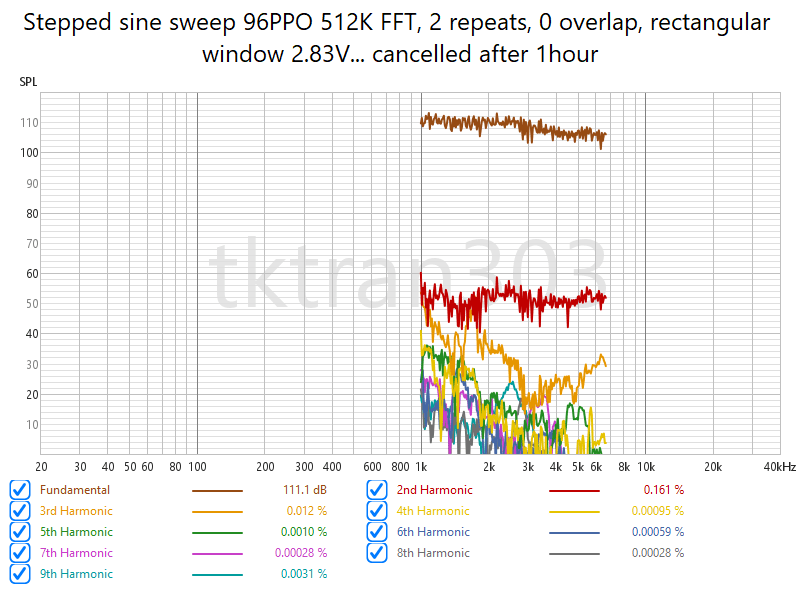

You describe a stepped frequency sweep.
I did exactly. I guess some may calculate the DAC values for a real sweep and send that to the DAC, a lot of work for nothing and you couldn't tell from observation. You would need to capture and process that output to determine what they did exactly.
It doesn't matter how they accomplish it. You wouldn't hear individual steps because the step values are so small. How it's done depends entirely on the test equipment used or the program itself. I doubt one is any better than the other. So at the moment we're talking about minor things that really do not matter today. A stepped frequency would probably be more accurate at each frequency point - depending.
Having synced analogue sweep with a horizontal display was a memorable method, but the horizontal position never was extremely accurate. They used a tuning cap being rotated slowly via a motor. The vanes were never 100% "linear" vs rotation angle. But, it was more than good enough at the time. Even a VCO may not be as accurate as people might expect. Digitally done? Depends a great deal on hardware and the firmware / software. Nothing is perfect. Not unless you get into the silly expensive test gear anyway. But for our purposes, it is more than close enough.
Then of course, everything shifts with temperature, humidity and air density if you are looking closely enough.
some may calculate the DAC values for a real sweep and send that to the DAC, a lot of work..and you couldn't tell from observation. You would need to capture and process that output to determine what they did exactly.
Not "some", all the modern analysers do this. Prof Farina published the technique in 2000 and it made previous methods effectively obsolete.
It is time efficient, robust to many problems, and the calculations can be done efficiently, to list just a few improvements.
Before you comment further you should read Farina's papers, they are available on-line.
The REW documentation also discusses this, it does offer a stepped sine option but cautions that it's "much, much slower".
So you can tell from observation, stepped sine is used mainly as a fallback option for extreme cases.
The swept sine formula is >here< for you to check (and a reminder for @IamJF!), as well as a detailed explanation.
