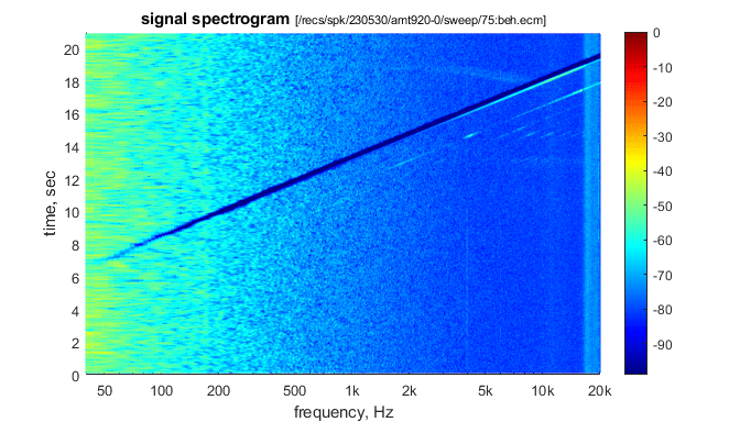

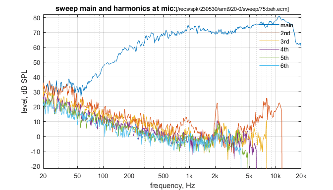

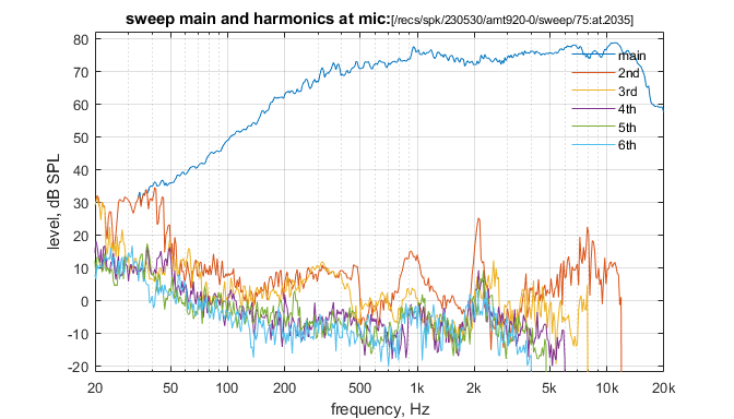

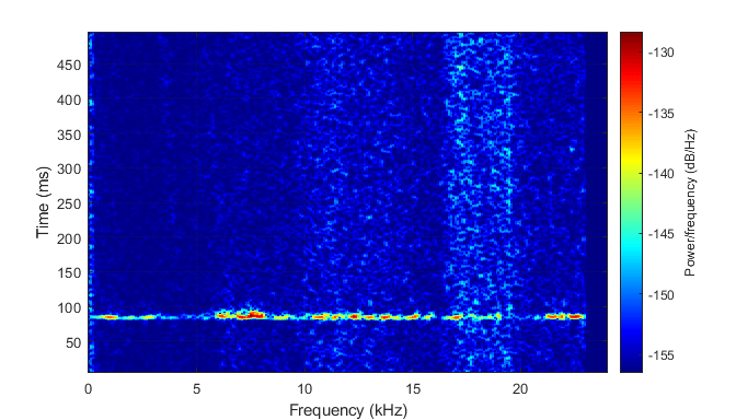

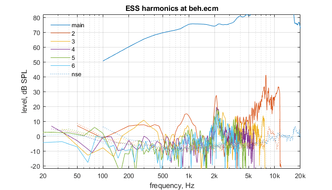

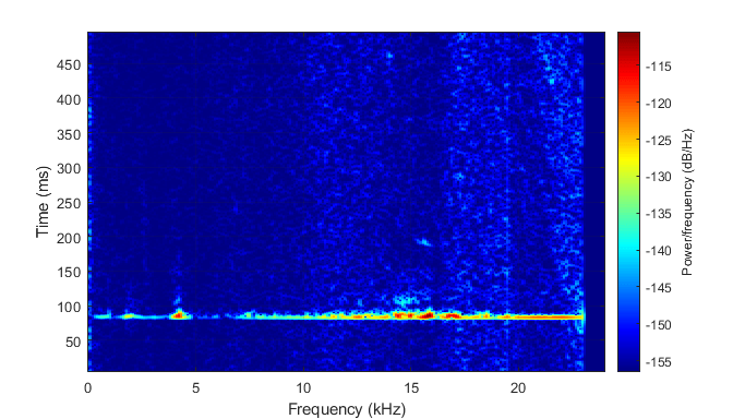

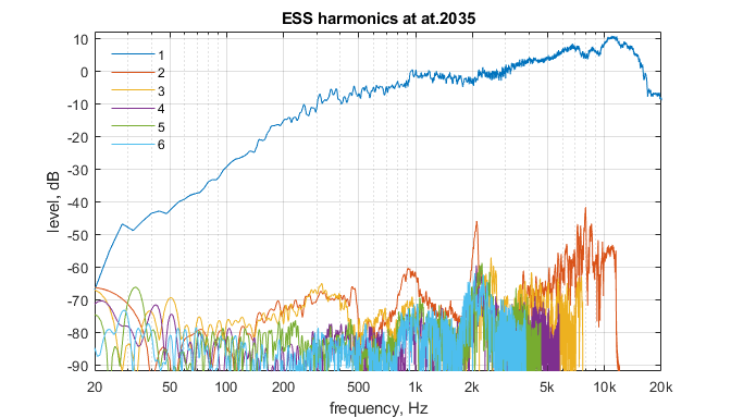

I tried the method I described in the "Measurement mics" thread in real life.
The results:
1. Old method, as per Matlab 2019b release of non-literal implementation of A.Farina 2007. Sine sweep turned out to be a "Log Chirp" from pre-historic era. Deemp of -3dB/octave is due to log sweep.
2. New method, without noise RIR reduction. No deemp. Quite a difference on low frequencies.
3. Here I run into a problem with the denoising of harmonic responses: I do not know what is important and what is not.

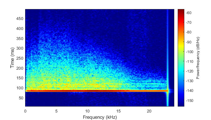

Let's look at the Spk+Room main RIR spectrogram: You can not see the 2kHz 2nd harmonic presence in the RIR spectrogram. You won't see anything on the 3D waterfall either.
Now, let's look at the 2nd harmonic IR spectrogram: You can clearly see the long decaying tail on 4kHz. That means this driver rings on 2kHz with distortions for quite a long time.
Let's look at the 3rtd harmonic IR spectrogram. It is clear that the distortions do not follow exactly Xms after the main ridge, there is a blip delay at 7.5 kHz.
I am not sure if looking at further harmonics, like 4th, would be interesting for anyone except stubborn perfectionists:
As "Standard" subband denoising like EM-84 could throw away the details that may be important, I would like to ask for opinions on what information you would like to see, and what can be scrapped as noise.

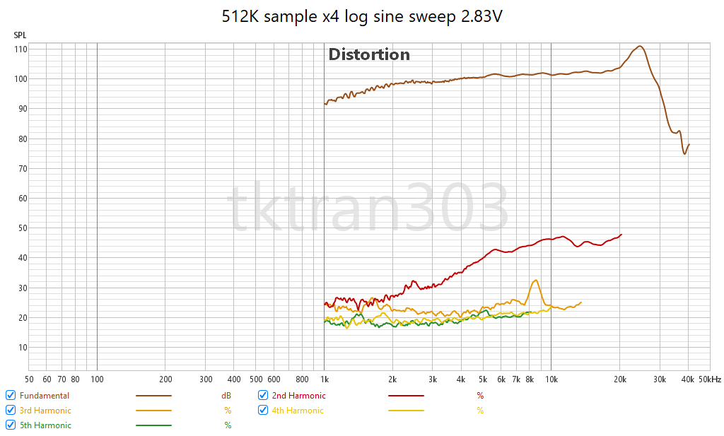

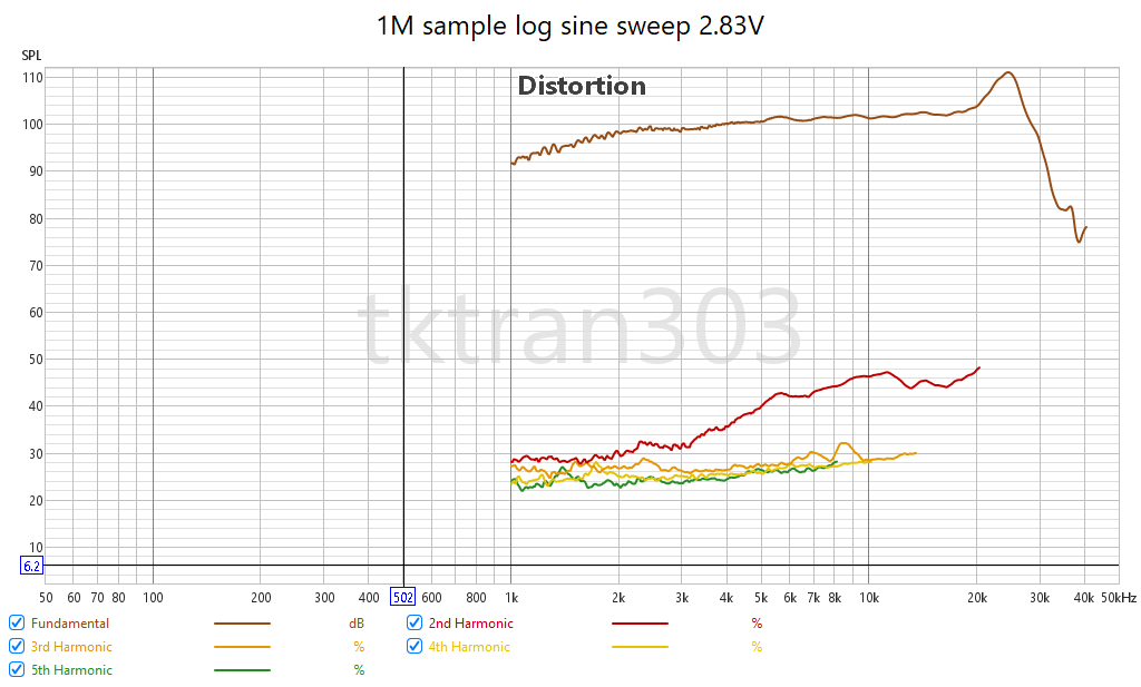

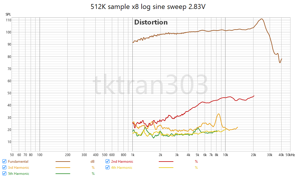

... sine sweeps, and/or the use of multiple sweeps to reduce the noise floor?
If so, I have some data that I could share. Perhaps @Dave Zan could enlighten me as to when I need/not need to use them.
It is now clear that the best use of time is one, extended sweep rather than multiple sweeps.
For example, a 4M point sweep will outperform 4 summed 1M sweeps and take no more time, or less because of start-up overheads.
Multiple summed sweeps may have been a useful work-around in the days of slower CPUs and more limited memory but are now mostly obsolete.

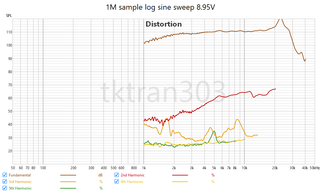

That’s not what my preliminary data shows…
My previous post was written before you added the visuals so I've asked for it to be deleted.
Now I'm surprised and confused, it does look like the summed shorter sweeps perform better than the equivalent extended sweep.
All I can think of at the moment is some kind of numerical precision artifact, that the summed sweeps allow for overflow and use double precision or some similar implementation issue in the code.
Or I misunderstand the Farina paper (or Farina messed up ;) ).
In any case, my compliments on your careful work, I'm keen to see if anyone has a better explanation.
