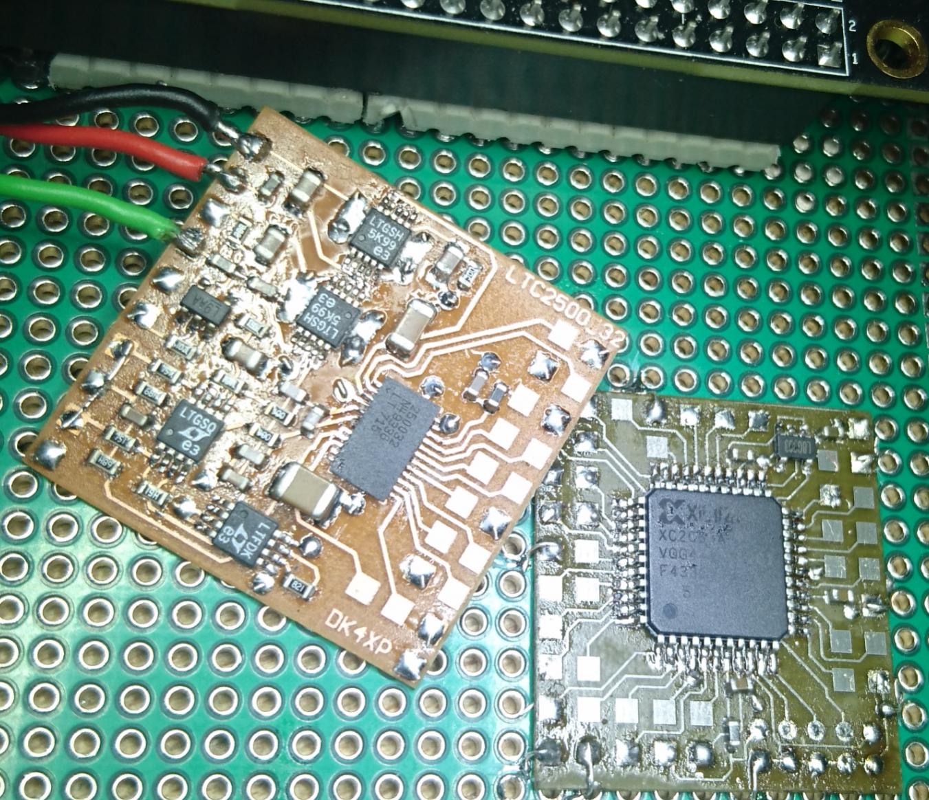

Maybe it's time for me to cook up something that works good enough to be usable. There are plenty of frequency synthesizer chips out there that go well into the GHz region, so why stop at 6 meters?
Those of us in the wading pool will have to wait for the PCB's; 0805 or 1206, please ....

I'm surprised at what's happened to the size of some parts since I was away from SMD assembly for about 5 years. Things that I would need to make a radio have shrunk from small to where is it. How do you hand solder a SAW filter when it is the size of a 0603 chip cap, but has 8 pads on it? The multiple conversion plan that I have, and the ultra low phase noise LO generator both need saw filters, lots of them.
Don't panic; that's not much worse than the 24 pin + exposed pad ADC
on my self-etched board. Resistors & most caps are 0603, ADC has 0.5mm pitch.
(1MSPS 24 bit ADC LTC2500-32 to be married to a Beaglebone Black to
collect, store & FFT the samples.)
