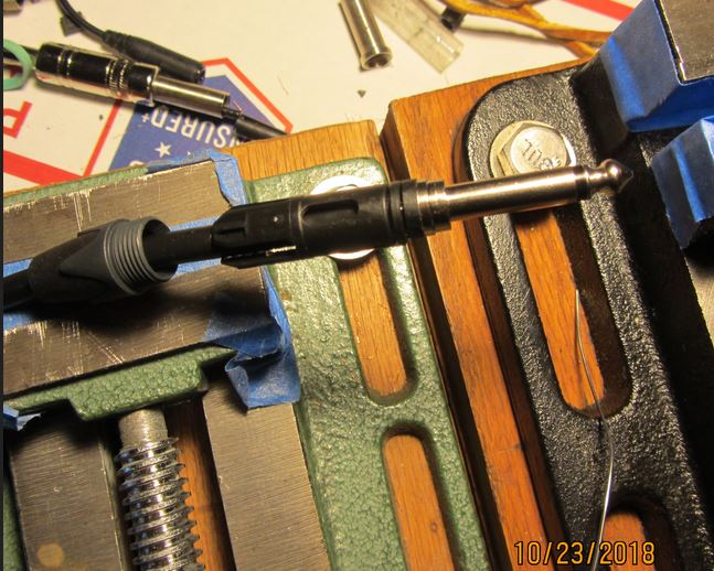

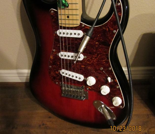

Ham coax for audio:
I measured some cable pairs found locally and in thrift stores. You can get them for as low as .50 cents.
Anyway the stereo 10' Monster cable measured 340pf and 380pf (two sides)
My MFJ 259B has 10pf internal capacitance so I subtracted 10pf from readings.
So 360 /10 =36pf per foot. But 10-15pf is from the two RCA connectors.
Then I measured Vampire Cable's stereo pair. Its 5' .
170pf -10 -15 is 31pf per foot. It beats Monster but if cables are stored in high humidty thae absorb water. We don't know the history on these samples.
I measured a 'pawn shop' 20' cable with 1/4" instrument plugs. I purchased it new and it has been stored in low hudimity.
Its a wooping (1250pf. -10 -15) /20 = 62 pf per foot.
Then to bring to a studio next week, I made a 6' RG62 B/U (belden 8255)
I measured with two Neutrik 1/4 connectors 114pf. / 6 = 19pf per foot.
Its less per foot if connectors are subtracted, pretty close to 14pf spec.
Don't think I'll do the rg8x as its spec is 30pf / ft so so no gain there.
Here are some pics of the RG62 cable. Its quite flexable with a stranded inner wire.

buddy and self were listening to some tracks and discovered the cables make huge difference.
The interconnects should not make any difference if the driving source has a low output impedance. CD players, phones, iPADs and other devices where the headphone jack is used fall into this category. A line stage or preamp should also if it was competently designed.......
The two places where cables really matter is the turntable, and as you illustrate, an electric guitar. Here the cable capacitance works with the inductance of the guitar pickup or phono cartridge to create a resonant pole. Any series resistance in the coil winding determines the "Q" of the resonant pole.
