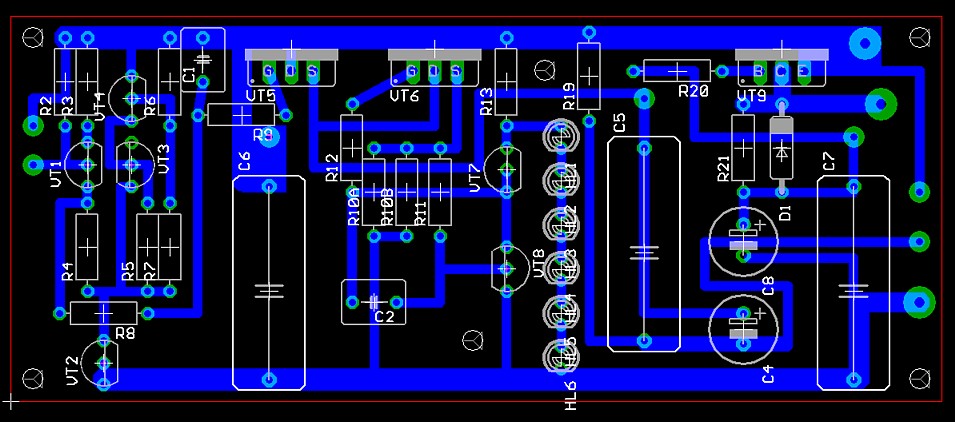

Hi Vladimir,
Since this is a no NFB amplifier, it would be interesting to see a 1kHz tone spectrum. Could you please make one.
Regards.
Hello, Miklos
I ask to excuse me, but I do not play with spectrum measurements. I consider a high quality system as the main instrument relevant to estimating audio quality. IMHO.
Hi Vladimir,
I understand, but you make all kind of other measurements.
Besides may be some other members think differently about evaluation of audio equipment. You presented your creation. Thank you. Now if I want to make up my mind about it, I would have to build one and measure it, while you already have it. It would be is easier if you would make the measurement.
Regards, Miklos
Regards, Miklos
Hello, Miklos
I am grateful to you for the PCB efforts, this could make assembling a bit easier.
Now I have inserted the No NFB Preamp board into the integrated Son of Follower. At the same time, the preamp itself, with the few Ohms output impedance and excellent sound, worth wide use, and I understand that PCB is needed for this. Thanks for your support.

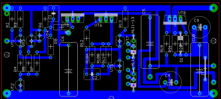

I made some corrections to the board.
It was a mistake at VT3 emitter connection and I turned around VT9.
The board a little bit longer now.

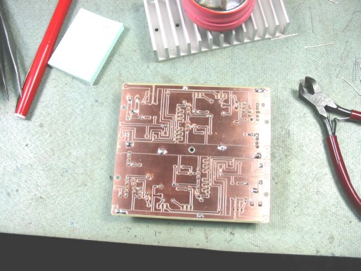

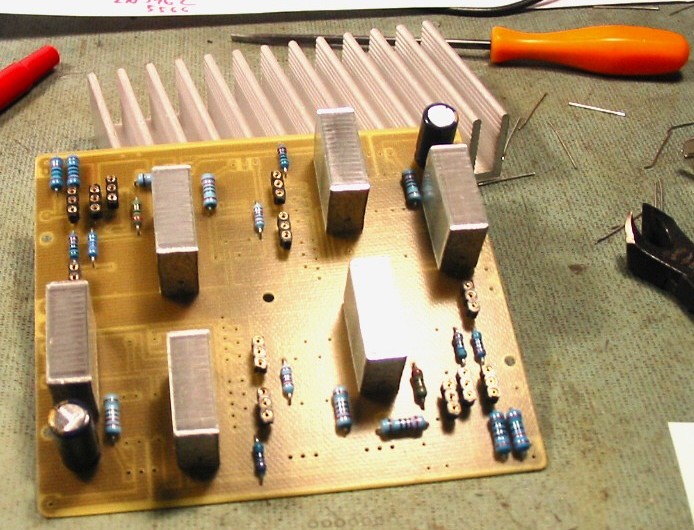

Hello Miklos,
Very nice board.
Im interested how your board looks from the side of components, what technique do u use to sign the placements of parts?
