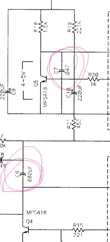

do you have 1n cap connected between base and collector of little bjt in output CCS?
BillWW said:
We decided the .001 UF was way too much. The 10 pF seemed the best we had tried, but the channels both seemed somewhat unstable with oscillations.
Any ideas? With no compensation caps you can see the very first photo Mark posted with a ringing peak on the leading edge. When we tried anything else, it seemed to be very unstable.
Any ideas on what to do or check?

Re: 1nF
yup;
1 nanofarad from C to B of Q4 in Babelfish schm
NP sez that this cap is for preventing oscillations in CCS
ceramic is more than good for that,in fact-maybe best solution (think RF)
if that doesn't help,problem is somewhere in your physical layout of pcb and parts,not actual schmtc

Re: Square wave ringing?
Put a resistor in series with the 10 pf. cap. Try 10 ohms.
Maybe just put a pot in there to see what is best.
BillWW said:Mark and I worked on the Aleph 3 jfet conversion late in the evening, before I needed to go home.
We found the amp tends to oscillate with any compensation cap. We tried the .001 UF and also 10 pF and 15 pF.
Regards, Bill
Nelson Pass said:which compensation cap is that?
they think on cap across 220K feedback resistor
I think that Bill's "abused" amp needs compensation in output CCS or even ~1n from gate stopper of lower output mosfet to output rail,known from some iterations of Alephs
but-first,I'm sure that his amp need pair of new pcbs.......or ptp from start...
