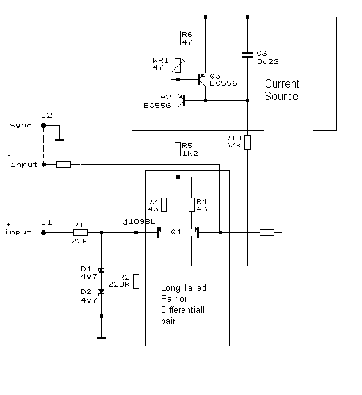

jfet as current source
Choky,
I have tried all three (irf9610, zvp3310a, and j176 jfet) as a current source and will only use the j176 now, because of how much of an improvement it makes. I can only guess the linear nature of the jfet and also lower capacitance of the jfet makes a huge improvement to the detail of music.
I only directly swapped out the irf9610 (200 pF) vs zvp3310a (50 pF) and noticed a great big improvement in the highs, although the low frequencies were worse with the lower transconductanct zvp3310a.
I further tried the j176 as a current source and that sounded much better than the zvp3310a.
I also swapped out the 9.1 volt zener with an LED for a voltage reference and that was the icing on the cake.
Before I lost my left channel, it really started to sound like a triode tube amp more than any other solid state amp I have ever heard.
I do not know what is going on with the various current sources. You have previously stated it does not matter on the sound quality due to a current source is a current source, but not to my own ears which I go by.

Re: jfet as current source
you can claim contrary only if you are convinced that each time you set same amount of current with changed CCS active part;
If you are sure with that fact-I believe you,but that puzzles me;
if you are not sure-there is cause of sound difference
in any case-I'm glad that you make progress with better sounding amp

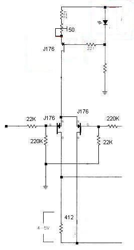

to BillWW:
I hope that you'll not be mad at me if I attach your sketch here....
I'm little confused with values there.......
I don't see any problem with using J176 as CCS part,but:
If we presume that you have at least 10 mA through first Diff pair J176 ,to achieve ~ 4Vdc at 412ohms resistor,then I have some doubts about value of 221E+50ohms pot above CCS fet......
if I=Vled+Vgs/R
we know that I must be at least 2 x 10mA
then R=Vled+Vgs/I = 2V2+0V3/0,02 = 125 ohms ,roughly...........
something starving here?
maybe you just need to find sweet spot for each part used (mosfet or jfet ) but without starving anything........
next time try to measure all values in all nodes ,to be sure that you will have enough parameters for later thinkin' and rethinkin'.....
hehe,food for thoughts .

Choky, You are correct. I had to play with the values to give room for adjustment of the dc offset.
I did not eventually use a 221 ohm plus 50 ohm pot. I just stuck in a 500 ohm pot, but forgot to show that in my above layout that I e-mailed you.
I did initially run into a problem adjusting the dc offset with the higher 221 ohm resister plus a 50 ohm pot, so that was why I later just placed a 500 ohm pot to allow for using all mosfets such as the irf9610 and zvp3310a as a current source. The various fets deviated so much that 500 ohms seemed to be a better range for all of the mosfets and jfet I tried.
At the time of settling with the j176, 412 ohms seemed to drive the output mosfets better into lower impedence loads. When it was at 470 ohms, it did not drive my low 2 ohm load very well in the bass. So, roughly 408 to 412 ohms seemed to give me better drive current into 2 ohms with my heavy biasing of my amp. Previously, with the preliminary 470 ohms seemed to make the bass sound very weak without a lot of authority. After realizing that, I replaced the 221 ohm resister and 50 ohm pot with just the 500 ohm pot and then I could adjust the dc offset fine.
Also, those considering an LED for a voltage reference, I found about 2 to 4 volts to be roughly the right value for the jfet. I have not completly finished that part of my experiment yet, before destroying my left channel.
Initially with the 9.1 Volt zener where the above photo shows now a LED, the Zener would not regulate to the 9.1 volts with the j176 jfet current source in place.

I think that you think on gate stoppers-they are here for preventing oscillations (gate acting as aerial )
you can leave it here without any harm....
regarding sort of CCS,you remember that I use two bjts in CCS....no problem with any voltage (hehe-ready even for mini Babelfish without any modification)....and I think that sort is even less noisier than Jfet CCS.......but-anyway -good enough .......
PS maybe you can try ,when you repair that channel,connecting second Jfet as I do-to mosfet source.......difference or not-you'll hear ...

Hey guys,
I got the Aleph 3 up and running last night with the jfet front end including jfet current source.
I still need to replace the zener with the LED for a voltage reference. I will have to do that tonight. I am very happy to have my beautiful sounding amp back. I missed it like a good friend.
I am eager to try the LEDs red ones, since I understand the lower brightness ones have very low noise. The green ones that I had were still better than the 9.1 volt zener.
So, I guess Saturday if everyone wants to hear the jfet Aleph 3 it should be available as long as Mark is home.
