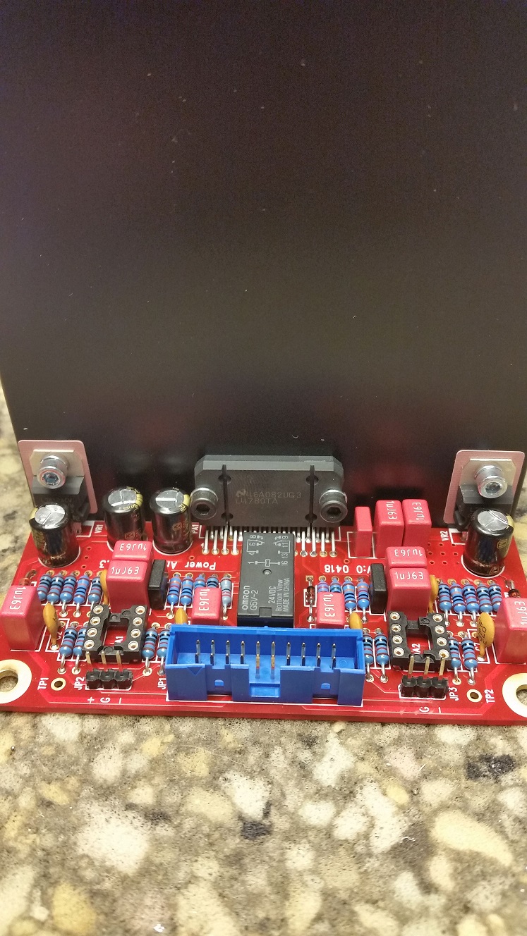

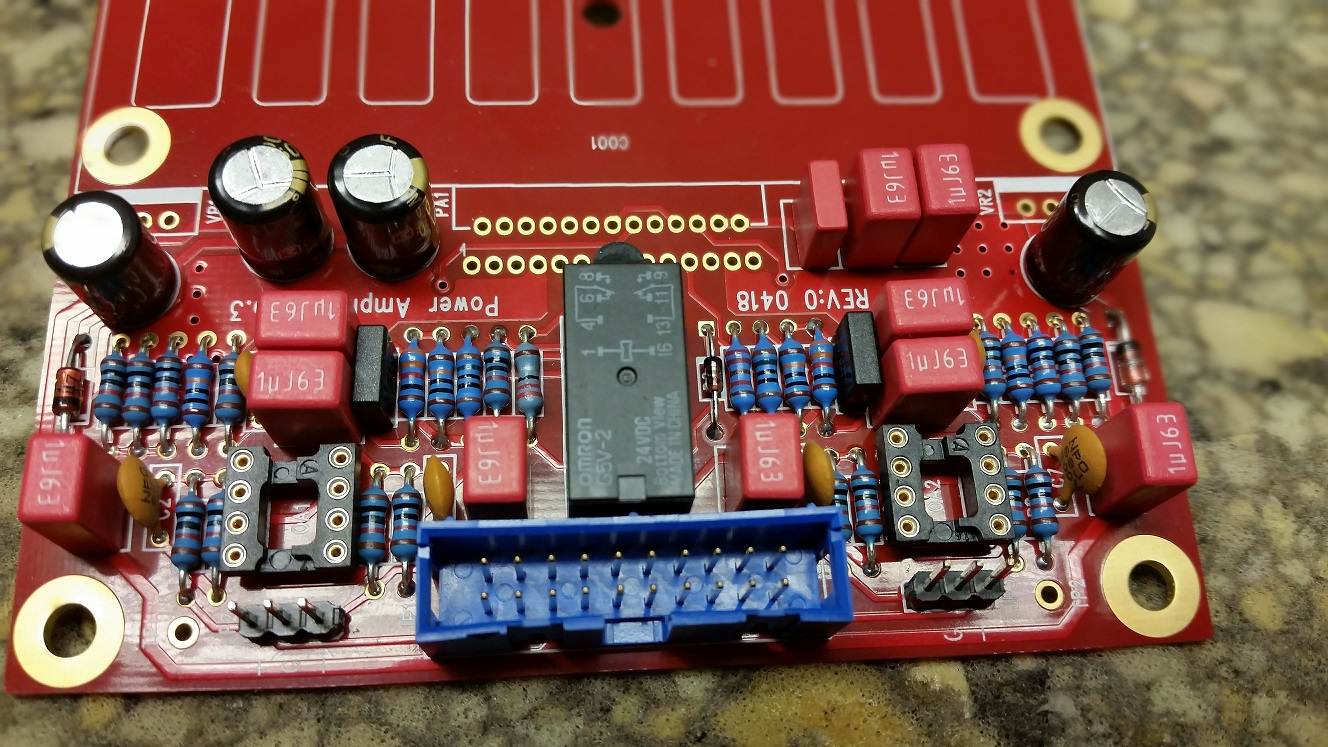

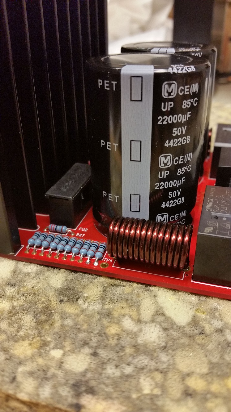

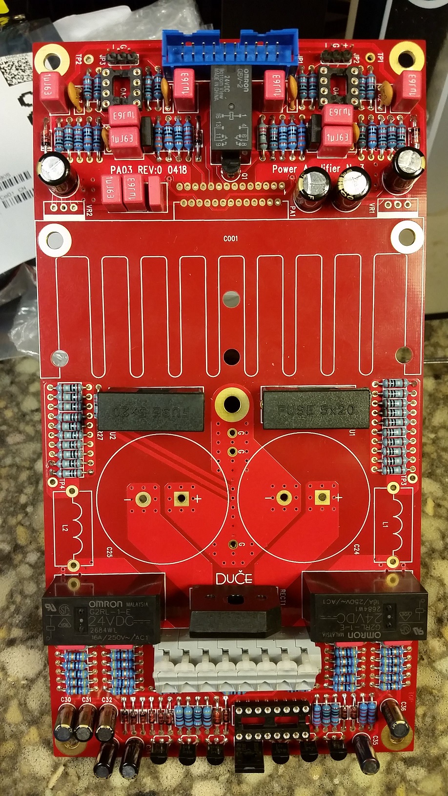

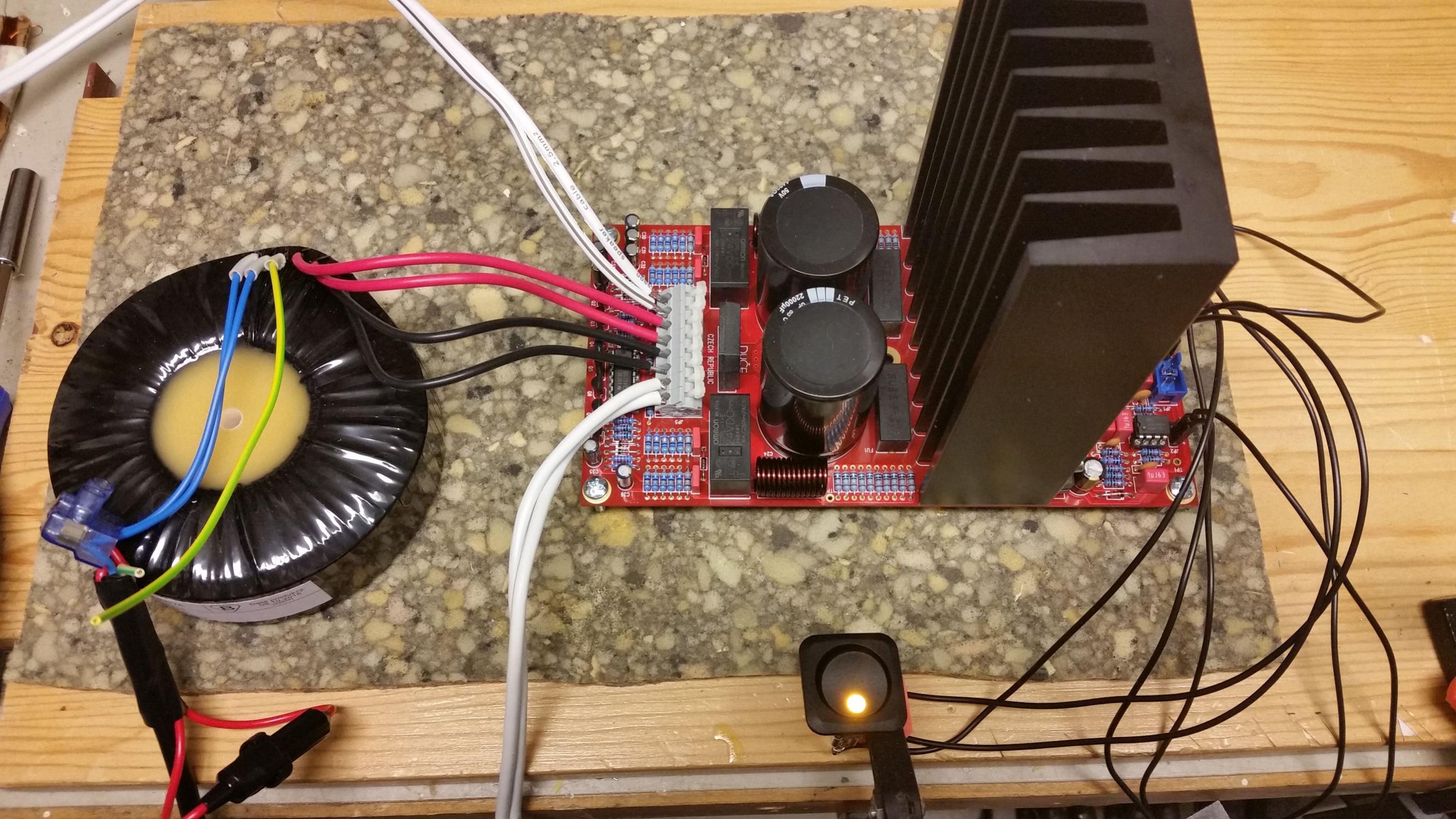

Ok here´s a few from me. Hope it´s ok to put them in your thread:)
To my build i choose a standing heatsink, have one more kit to build and my intentions is to build my own chassis as slim as possible and have to monos.
Maybe i can mill down the heatsinks from todays 15cm to 10cm so i can have even smaller chassis!? The heatsink after a few hours is barely warm and the heatsink now is maybe little oversized:)

Why not, good tip! You think it´s enough to cool the 4780 and the 2 regs with only 7,5 cm high heatsink? Maybe it´s easy to calculate?
look up the 3886 datasheet.
It shows how to predict the heatsink size required to allow the chipamp to operate at a maximum of 150°C
I recommend you double their heatsink size to allow all normal music and audio operation at very much lower temperatures.
eg if the datasheet says to use 3.0C/W then use 1.5C/W for one channel.
For two channels I would then use a 0.75C/W.
But a 4780 is two channels on a single heatsink interface. It needs a bit more cooling because of the interface area limitation.
Try the basic quadrupling (doubling for reduced temp and doubling for two channels) and see how your 74mm high heatsink compares.
