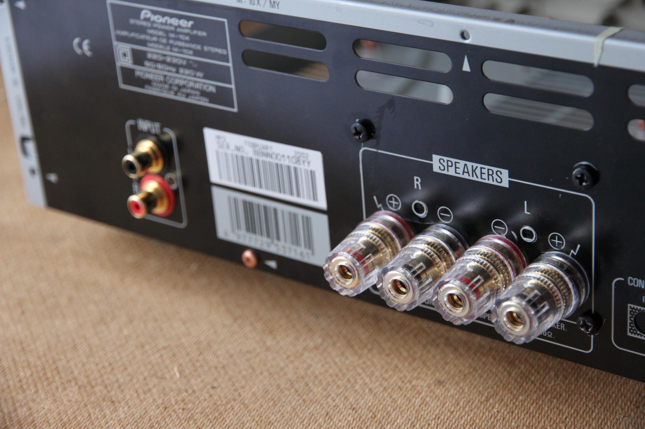

Okay, on a piece of chipboard the PA03 sounds wonderful. Time for some casework. I decided to look for a second hand power amp with plenty of room in the case. I checked the local thrift shops and websites and then I bought this old champagne colored Pioneer M10X power amp.
I removed the inside of the old amp. Whit the innards came out the RCA chassis sockets, the loudspeaker connectors and the IEC Connector. They were all integrated onto the old amp board.

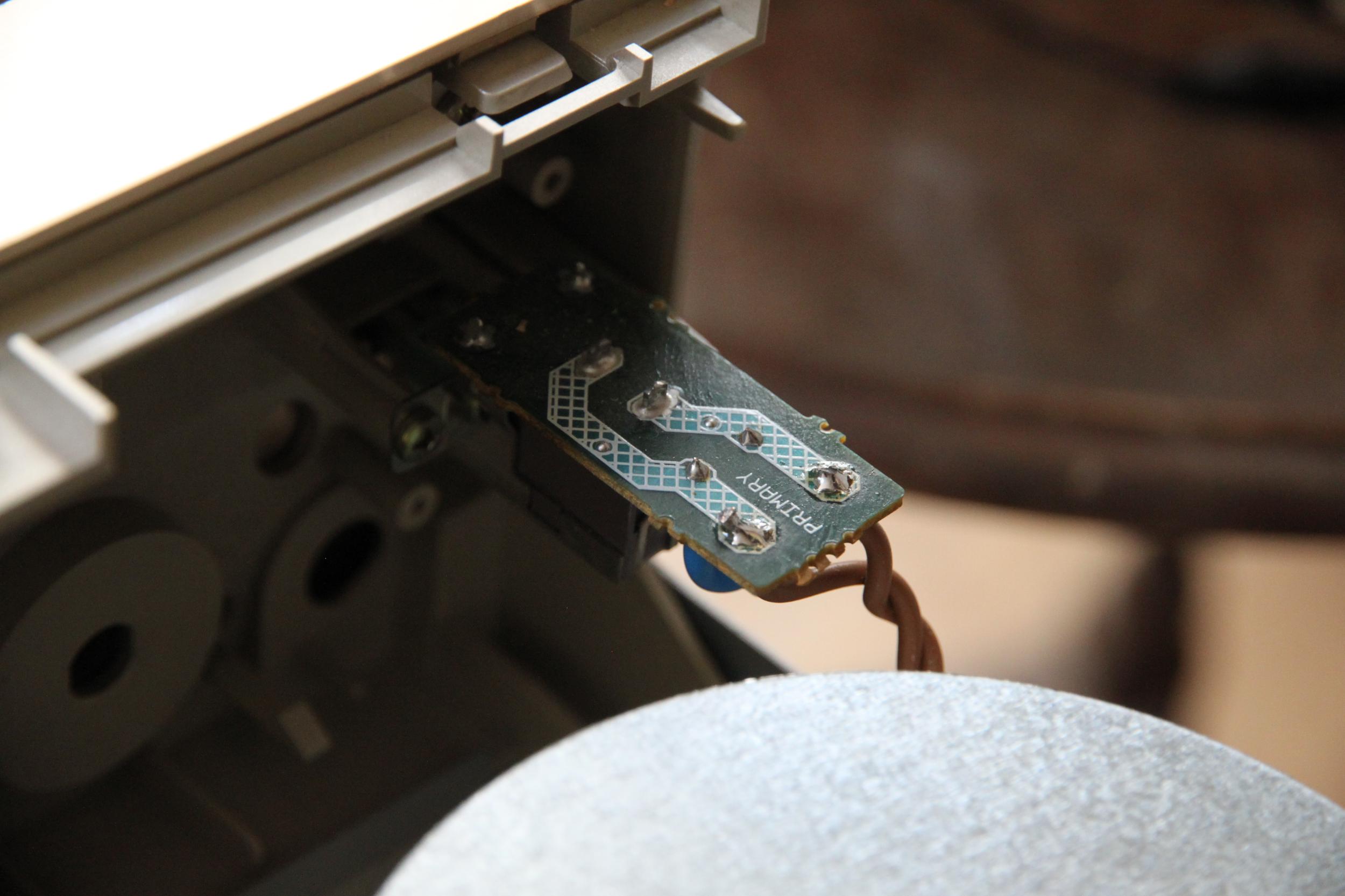

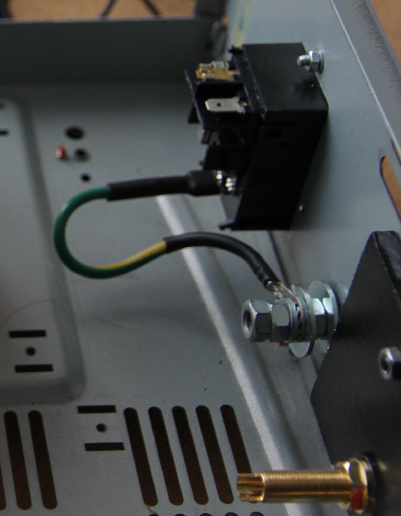

Originally the Pioneer was double insulated so it didn't require a safety connection to earth. Wikipedia tells me “This is usually achieved at least in part by having two layers of insulating material surrounding live parts or by using reinforced insulation”. Therefore I don't understand why Pioneer placed the solder joints of a live wire just centimeters away from the metal lid (see picture).

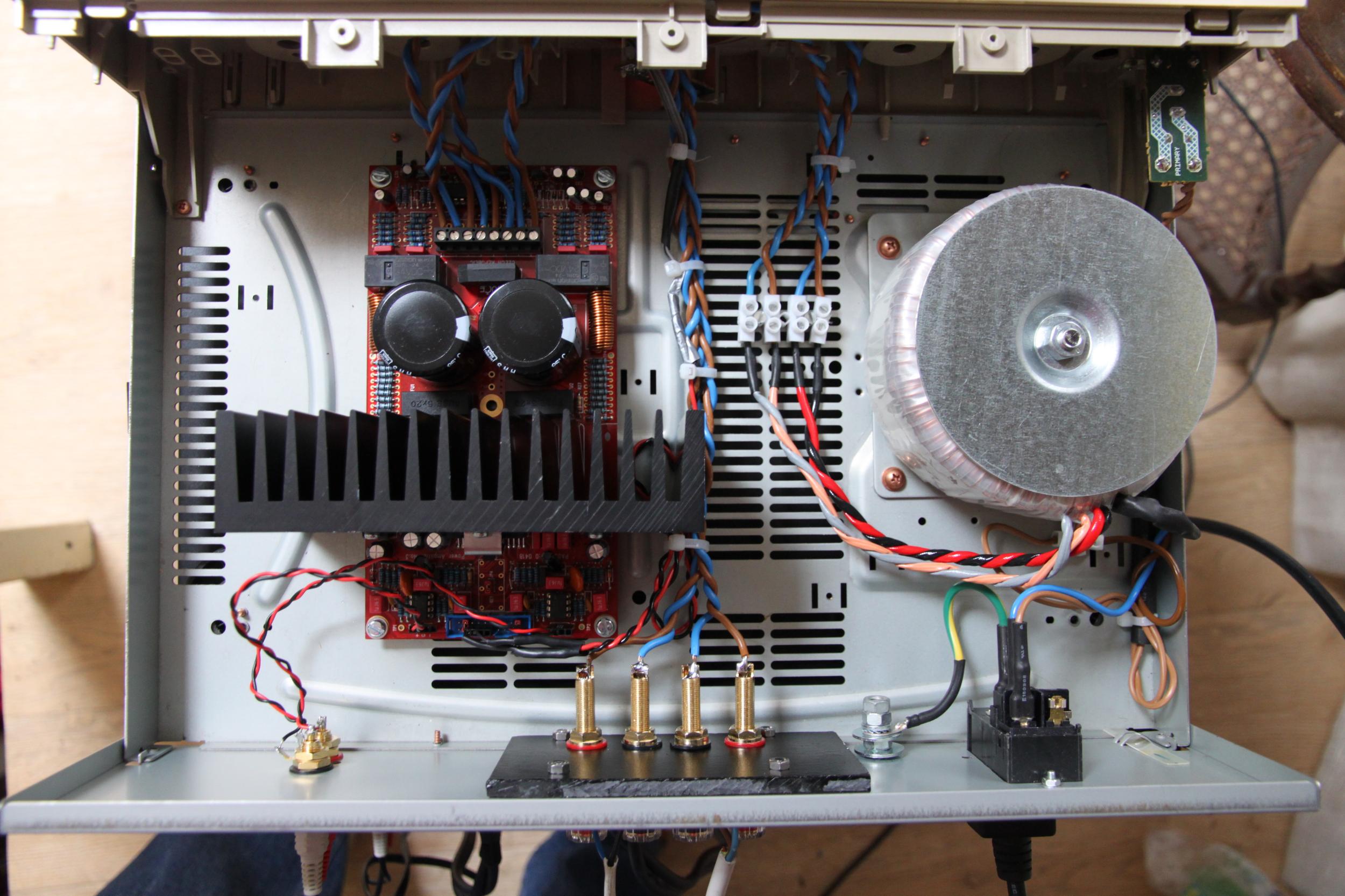

In the forums I have read again and again to go for safety first and have the chassis connected to electrical earth. So I put my Dremel to use and mounted a Schurter power entry with earth conductor contact, illuminated switch and fuse.(Protection Class 1).
For the earth connection I got valuable information from Rod Elliot's website Earthing (Grounding) Your Hi-Fi - Tricks and Techniques. He is demonstrating a safe method of connecting the earth lug. As you can see on my picture it's quite a contraption.
I installed new RCA sockets, insulated from the case and new loudspeaker connectors. As the loudspeaker connectors a very close together there is risk for a short. Therefore I chose connectors with an insulated outside.

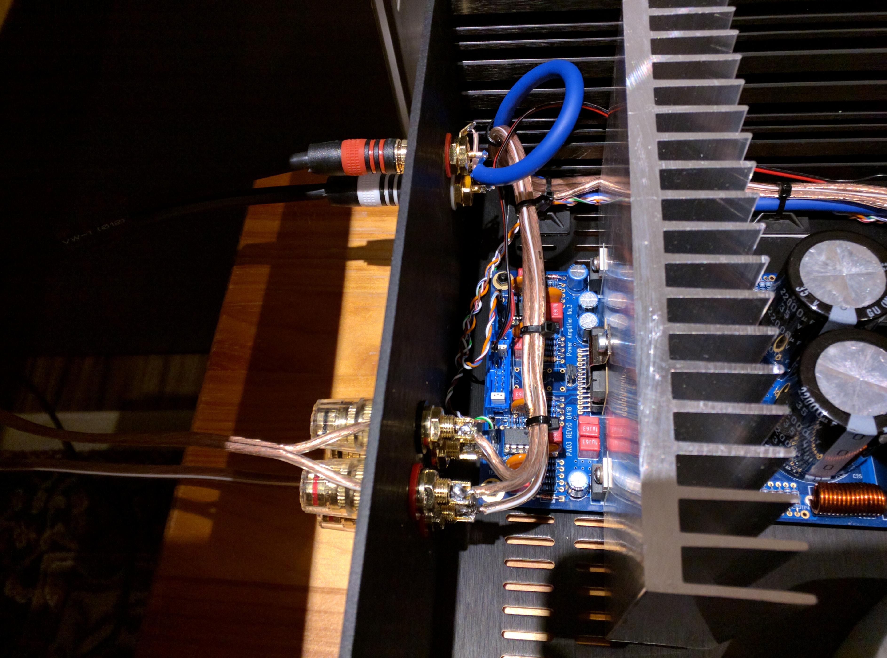

Mounting the power transformer and the PA03 pcb was rather easy. I am not a believer in fancy cables so for the interconnections I used ordinary stranded copper cable. I was unsure of the needed wire diameter for power supply and loudspeaker. I doesn't sound very sophisticated but in the end I used the wires from an old washing machine, diameter of the copper 1,5 mm. I think this will clean up the electrons and therefore the sound. :). I have to admit that all the brown and blue is a little bit boring. Besides, it's easy to make mistakes.
On the input connector of the PA03 module is a stabilized 12V DC available which can be used to energize auxiliary circuits. I used it to power the front led. I was very uncertain how to connect the RCA sockets to the PA03. Shielded or twisted. To tell the truth I am still unsure, but used twisted cable.

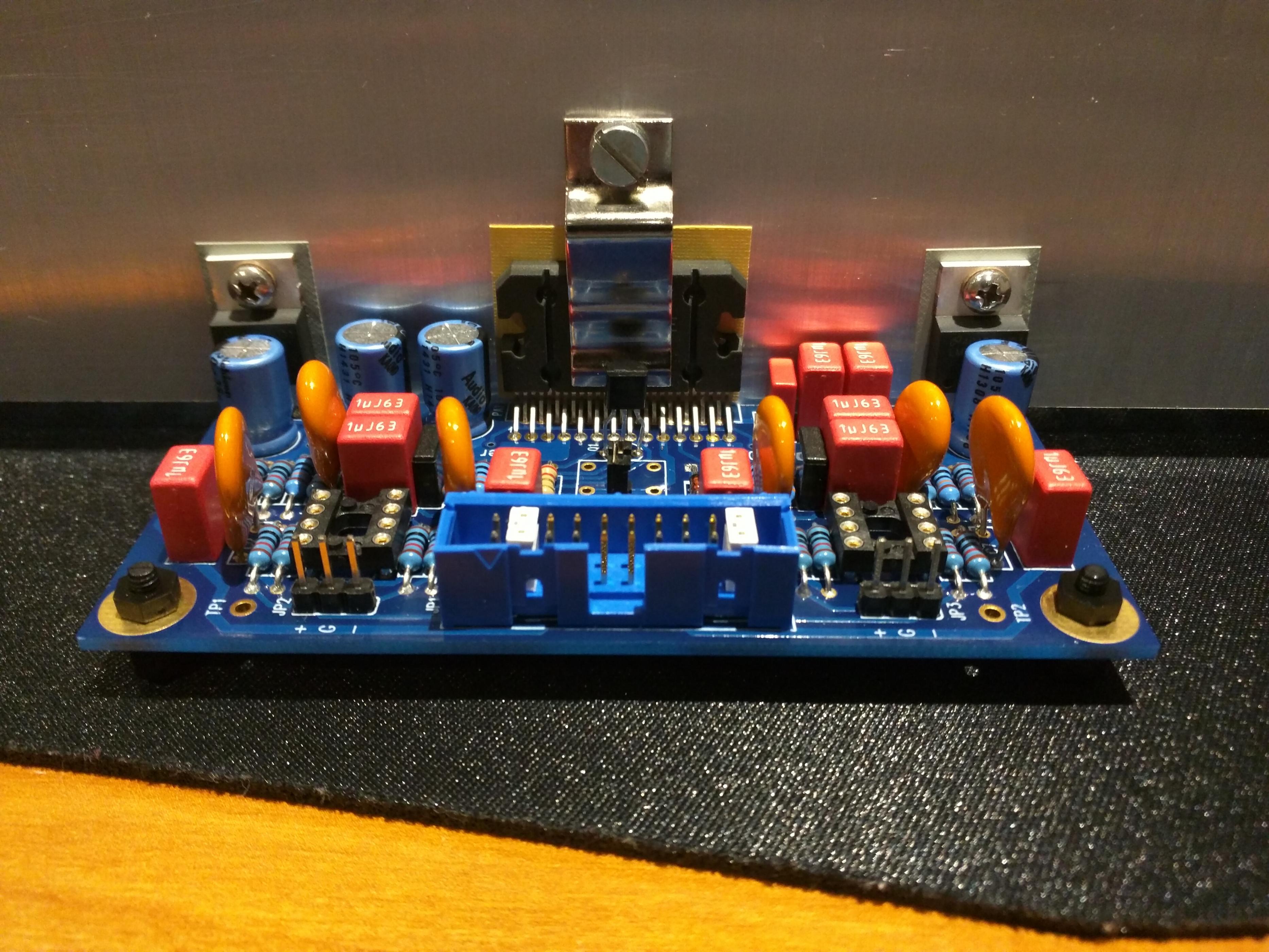

So I got mine all soldered up for the most part this weekend. I'm waiting on a wire-to-board terminal block as the one I got didn't fit correctly. So far so good though, I'm excited to give it a test here soon.
I think I may either build my own chassis or do a modushop one when the time comes.
Very good looking pcb construction so far. You won't be disappointed. Mine is the best sounding amp in the stable.

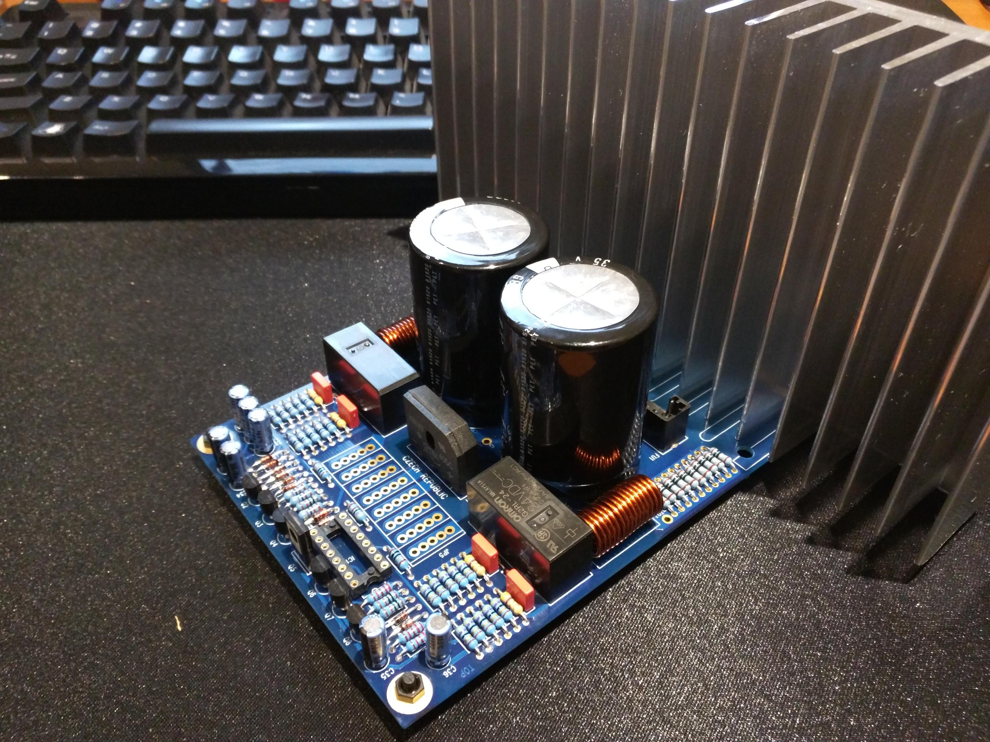

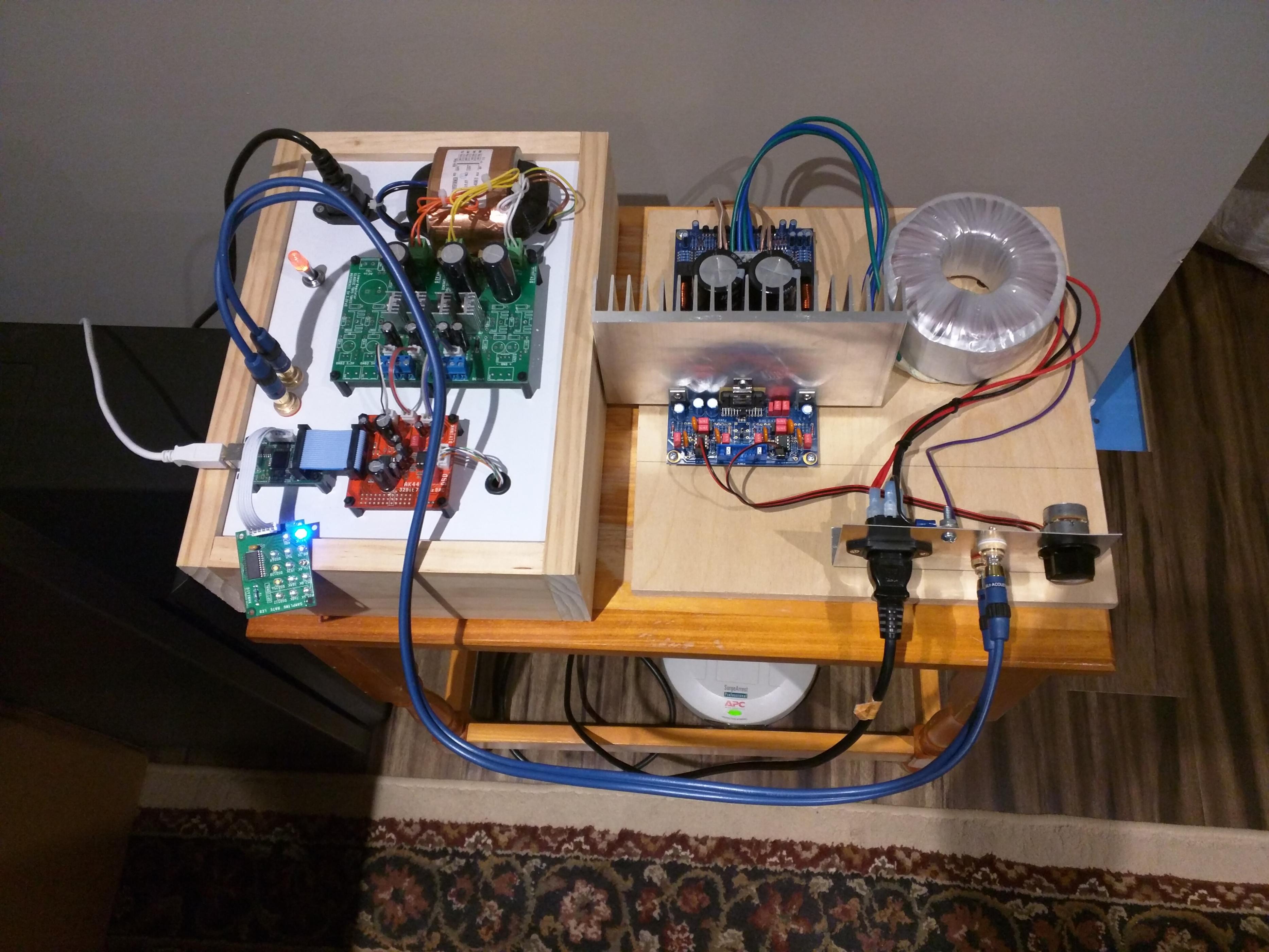

So finally. I had some time to get it all laid out on a test board and fire it up. All the initial tests came out spot on. I heard the relays click, and decided to see if she sings.
Sure enough, it sounds awesome. It's being fed from my DIYINHK AK4490EQ I built a couple months ago and sounds great. As you can tell from the picture, I'm in dire need of doing some casework.

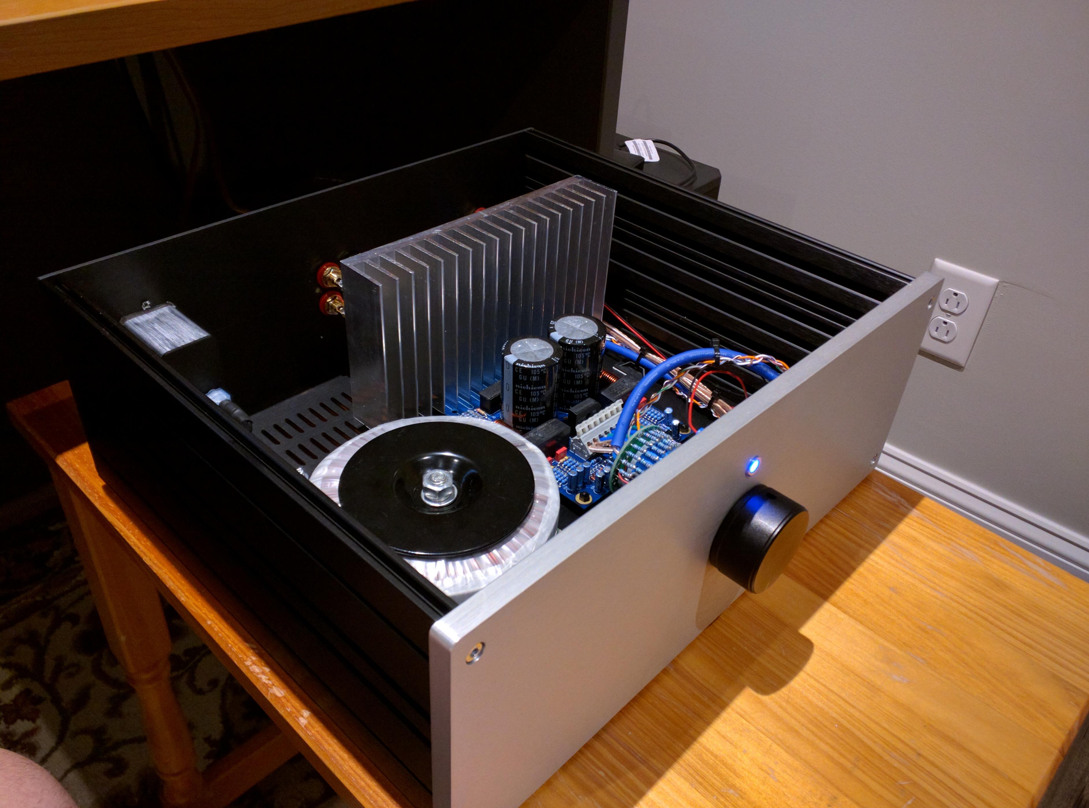

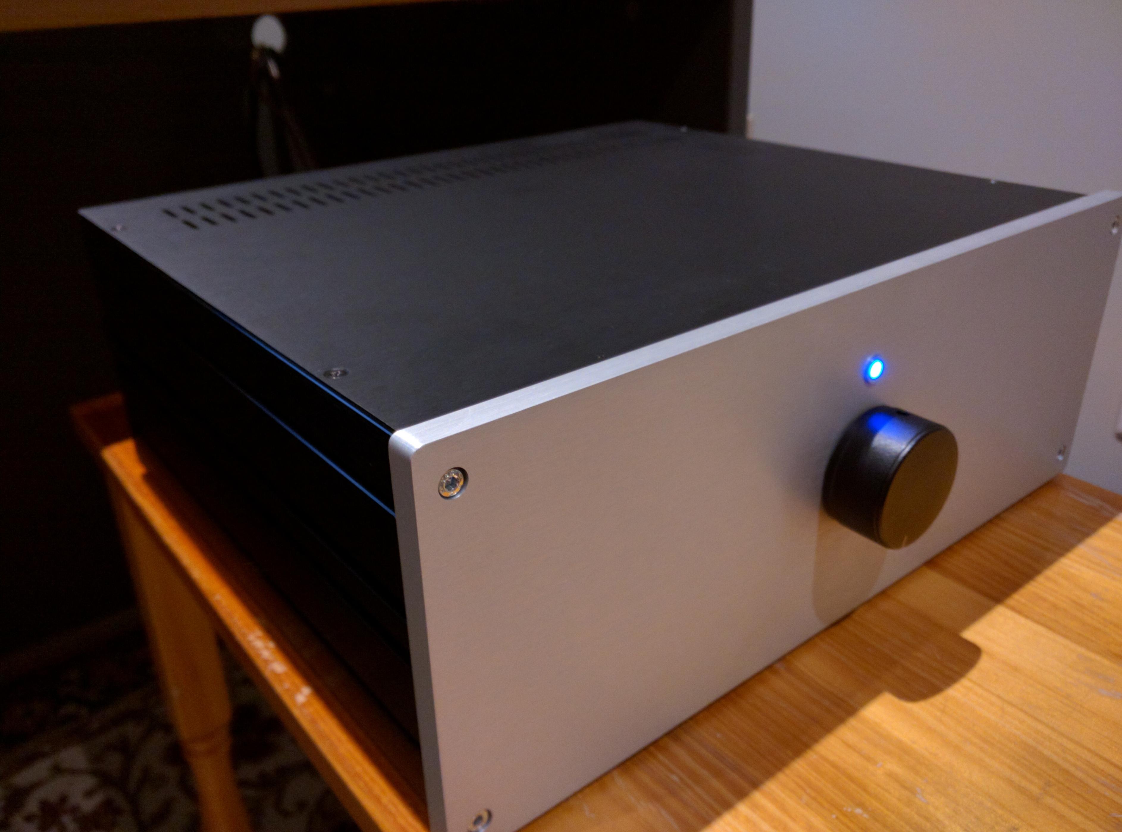

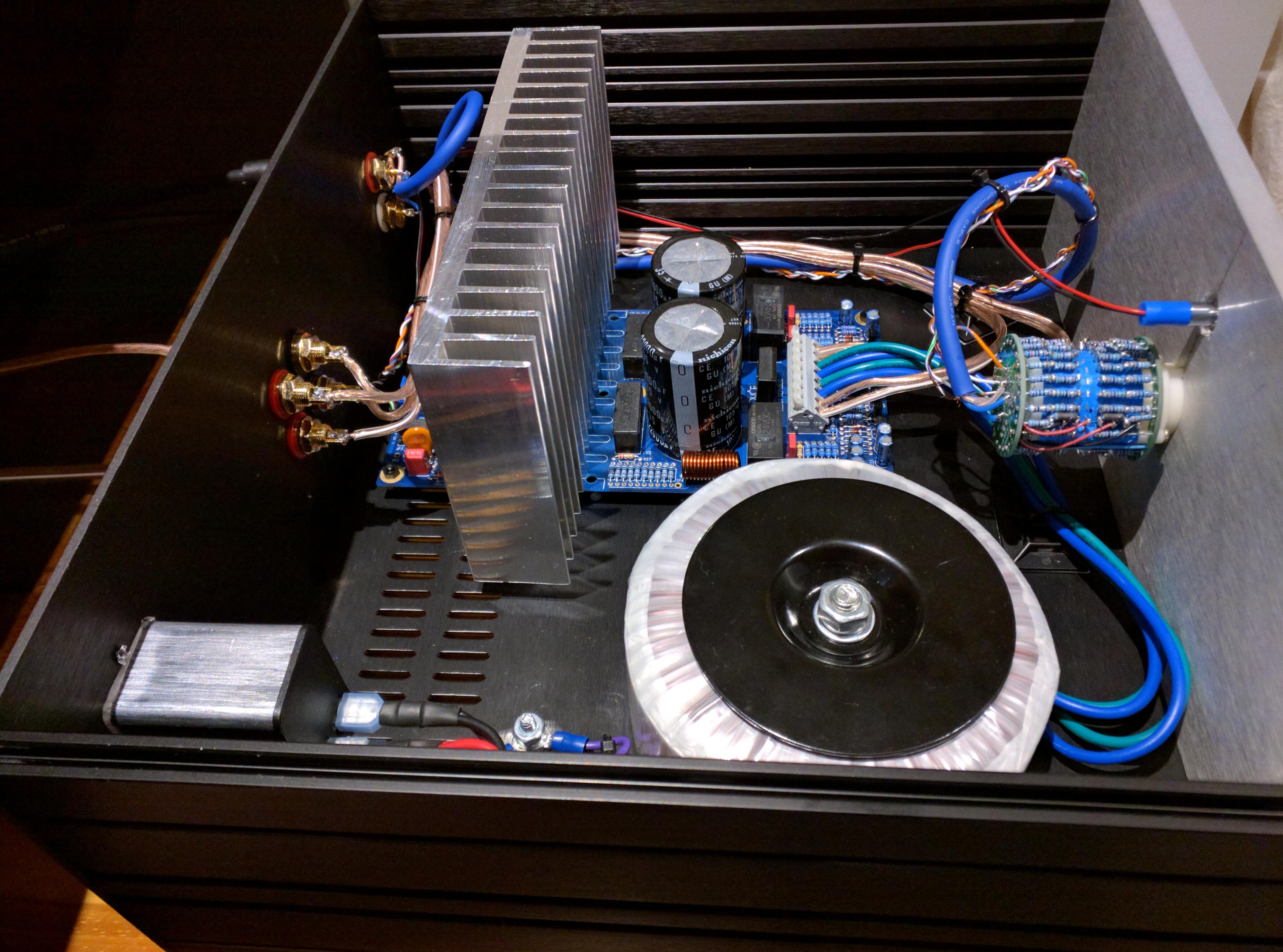

Had a fun weekend drilling and cutting aluminum for my PA03 chassis. I ended up getting the big Galaxy Maggiorato 3U from modushop and it fit the bill perfectly. I learned quickly that 10mm of aluminum is a lot of aluminum.
All in all, I'm extremely happy. It sounds a heck of a lot better than an old Sony AVR did. I figure it's time for a speaker upgrade now. Gives me an excuse to start another project I guess.

Great job on your build loafimus. Looks nice and clean with plenty of room in the enclosure. Now for the sitting back and listening to the crystal clear sound, and uninhibited music you'll enjoy. I can't get enough of this little unassuming amp. :) Great stuff.

No, I didn't solder the pot. I found it on ebay:
Valab 23 Step Ladder Type Attenuator Potentiometer 50K Log Stereo
