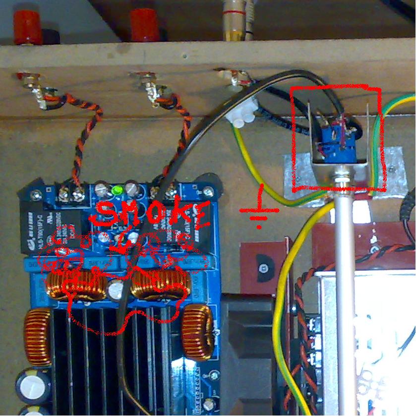

Thanks, that's exactly what I thought. I'm just trying to understand what happened to my amp before sending it back. Just in case the fault was mine I don't want to make the same mistake twice when the new board arrives. At this point I can think of nothing else that I did wrong. So, I'm presuming that there was a faulty component(s) on the board.
-Steve
I never tried that before, so your experience could be a lesson to us.
To be honest, I have to specify I'm not sure about the real cause...[I didn't try again!!!that smoke made me afraid!!]
I have to be more precise:
attachment.php
the pot I have has printed circuit terminals,but this one isn't on a board [I didn't have much money to spend on this, and in the shop where I bought some other material there was only this -good- stereo 50k log pot ]; the pot is on a grounded metal U...while I was working on the pot axis and knob, some of the wires around the terminals could have touched the metal support...so...ground loop?Short between LR channels?Really don't know, but however the result was not less than curious..

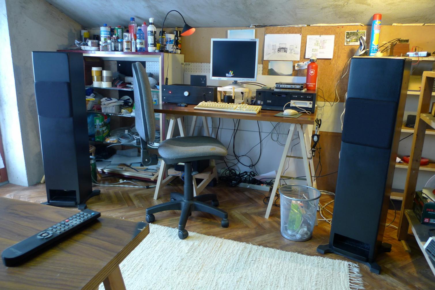

Just a little follow up.
I'ts now 5 months that I'm driving my speakers (inefficent and low cost TQWT's, but homemade) with a T2 powered by a Connex 300R SMPS, all unmodified, in a power-amp setup (no volume control - stock pot all turned up).
I assembled it all following the guide user Alkasar wrote and posted on a french forum. Very well done. This alliance worked from the beginning, rock solid, no noise or hum at all (the low sensibility of the speakers and the distance between the SMPS and the T2 may help), no difficulties in handling fast transients or long listening sessions.
Soundwise I'm not missing my Denon and Rotel integrated amps at all, much more muddy and less detailed in the low-mids section, where the T2 is still capable of delivering a firm and solid bass. The highlight for me is the reproduction of acoustic instruments (as a half musician): as someone said earlier, you discover much more instruments in your favorite recordings (and the capabilities of the sound recording engineer) never loosing the music as a whole.
Power wise i feel it's better suited for high sensibility speakers (>92 db or so), but I'm still capable to reach normal to high listening volumes with my 86 db speakers in an average apartment living room (maybe 20 sq. m.) without any distortion.
I'm very happy with the result, time will tell about the quality of the used components and of my assembling skills, but from a first impression the two modules are clean, well manufactured and assembled. The only thing I miss is the ROHS compliance, but this discussion should be made in a separated thread.
I would recommend it to everyone with high expectations and basic skills, wanting to improve his own listening experience.
But beware, it's addictive. Once your defeat the marketing voodoo of big companies and you start to understand the (few) important rules of sound reproduction and electronics it's very difficult to stop.
