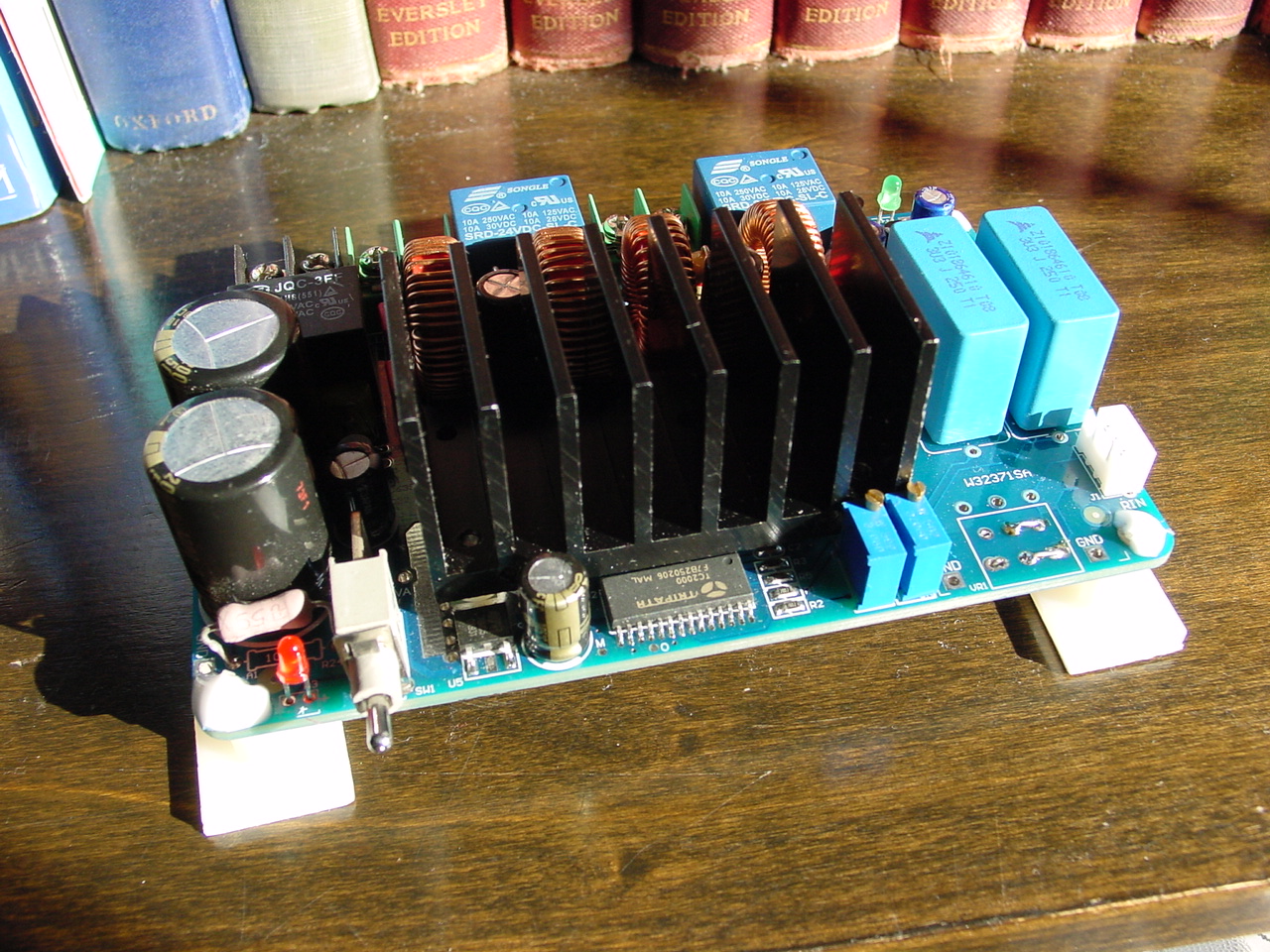

Not sure what you are asking, but if you ask why there is not pot, maybe it is so you can use externally mounted pots, like on a chassis. I have one here pictured that I took the CTR pot off and bridged the connections. Then I used external individual pots mounted on the faceplate as shown. Works very well. This is the T1 80 watts @ 8 ohms, just finished yesterday. I am quite pleased with the HiFimeDIY product, it is crystal clear and extremely quiet, black background as they say. Breaking in now. Thanks hifimediy!
As you say it worked before you put it on a chassis.
So maybe you have accidentally shorted connections.
Check speaker and power connectors.
This is of course what I'll do. Thank you for bringing me back to logic. First, I'll see if I can get the board to power up with the speaker output connectors disconnected.

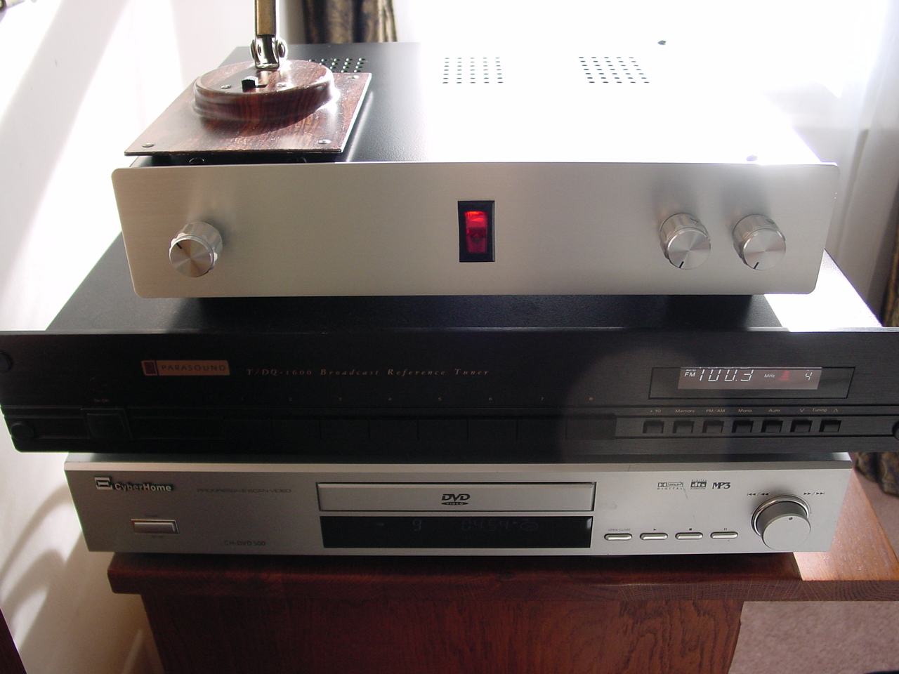

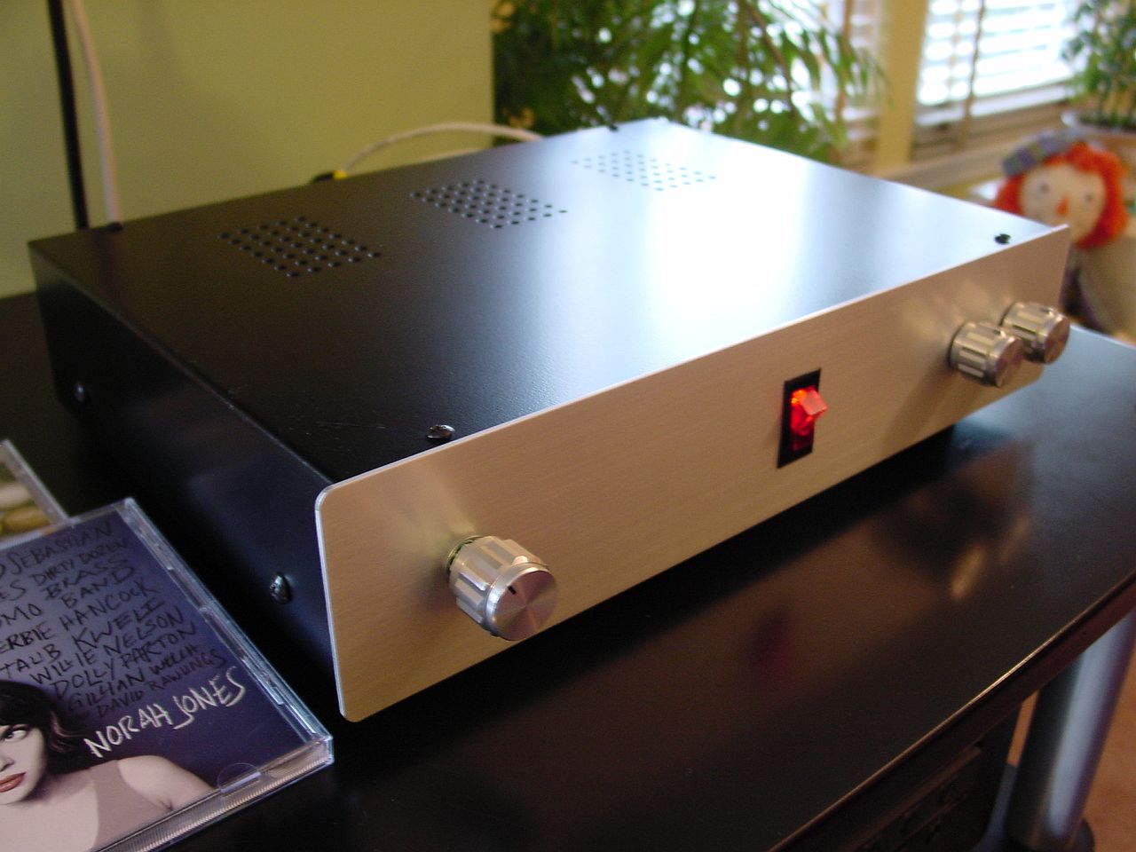

Beautiful build!
Will you be able to post some SQ comparisons to your Arjen amp? I'm sure lots of us would appreciate it.

Comparisons are hard since the HiFimeDIY is still breaking in, but in all respects it is really good. It has assertive bass, has the mids magic WOW, has the airiness associated with T-class, it is extremely quiet, and has lots of power. Detail and focus are coming in as it breaks in. Quiet a bargain for what it is sold for. Hard to tell you which one is better, from a DIY standpoint, if you do it right the HiFimeDIY will payoff big time.
Here is the setup now with one of the speakers. It sounds amazing.
I will post the linear power supply schematic later, it is 1/2 the equation for good sound.

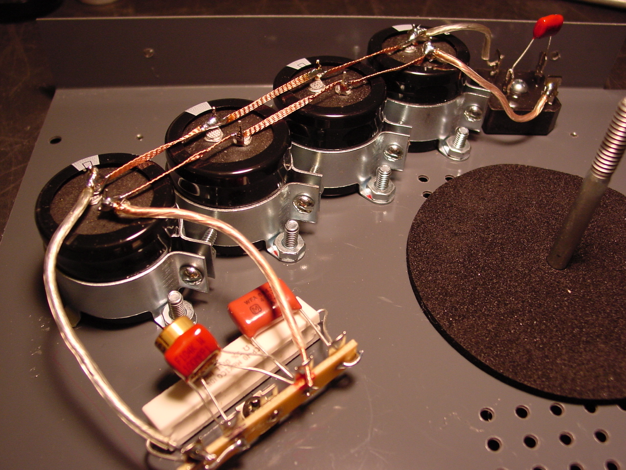

I find your comments on the linear PS interesting. Seems that I've read many time on various Class D/T threads that SMPS is usually preferred. Could you enlighten us some more why you have gone the linear route and if you have been able to do any comparisons with the Meanwell supply that is recommended for these amps?
Believe me I am not at all criticizing your choice of linear. My gut instincts have told me that a good solid linear with a lot of high value capacitor should be better than the noise creating switchers. It's just that it seems like I've heard many statements to the contrary. Confusing!
Thanks very much for your important feedback. And I look forward to your PS schematic.

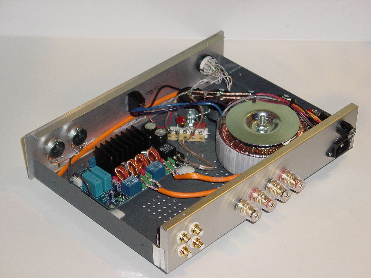

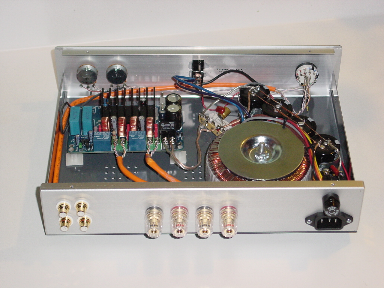

Update on the T1, it has met and surpassed expectations. I love the way the bass goes down low, what a nice welcome performance from a T-class amp. The mid continues to do its magic.
I basically follow something very similar to the advanced linear solid state power supply described by TNT audio: Solid State Power Amplifier Supply Part 1
You'll see the schematic there on Part 3. Now keep in mind this power supply is for + 0 - , since this amp only uses + 0, then only use half the schematic on the transformer secondary side. Meaning, no negative voltage needed.
Additionally, I do some AC line filtering that is common to PC power supplies. I use an X class capacitor across the mains AC and Y class capacitors on each main line to ground. Also use a bleeder resistor across the mains. I do not use chokes in order to no affect transients surge and do not use power strip with surge suppression. I got that advise from the head engineer at Grapevine Audio, he really knows this stuff quite well.
You can also see it better in this picture, I feed the amp right off the soldering block.
whaleman, can you please post a schematic of the PSU side of your build? Looks interesting.

Hi, I am everytime really pleased in looking at your finished amps. Very fine and solid workmanship.
But are these big caps after the torroidal really needed ? If I have not read wrong, these could disturb if the specifications which are choosen in class-D amps are too big. But indeed they look impressing ...
