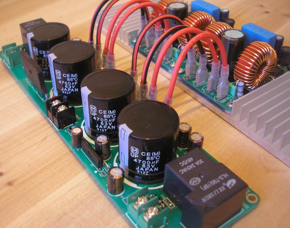

don't know how it sounds, but it looks good :) the PSU form factor is interesting and will make housing easy.
This has 4x4700µF. Isn't that too less for a linear supply at such power ?
I would go for 4x10 000µF. Should not increase cost much, but will surely provide a better power tank.
Hi, consider that most times we will use a SMPS, 4700uF is not a bad idea. And there is room to fit in bigger caps if needed.
now i am confused :confused:
This is a linear PS board, with rectifier and filtering+tank caps. Only needs a transformer and done. In this use case, caps need to be bigger.
If SMPS is used, there is no need for an additional PS board, correct ?
The only reason I can see to use this PS board with SMPS, is to benefit from the tank caps. But then, why bother with a board : simply wire one large cap or more in parallel up to the desired tank size.
Sorry, i just don't get the use case you have in mind for this PS board.
Can you share the schematic of the PS board ?
100% correct imho.
I agree with you. Notice that with SMPS you don't need large tank caps, instead they could create some problem to the SMPS for some reasons related to its feedback circuit.
