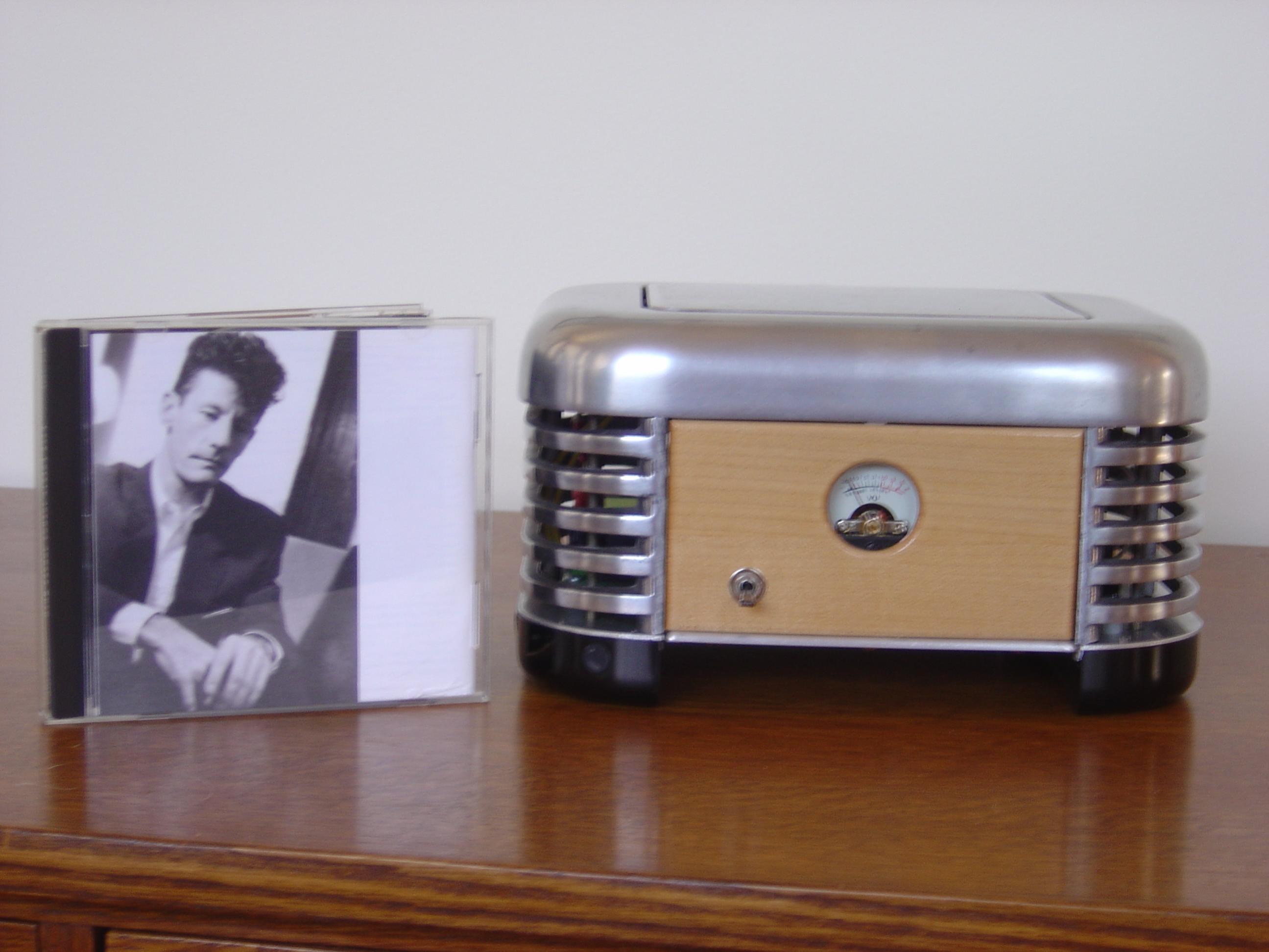

Amp and power supply cased in a hot plate/toaster oven manufactured around 1937. It was called a caulkins breakfaster. Cast aluminum required a lot of elbow grease to make it look good.
boone
This is one of the best I've ever seen !!!!!
+2
T2 Special + connexelectronics power supply - very compact!
I want one!

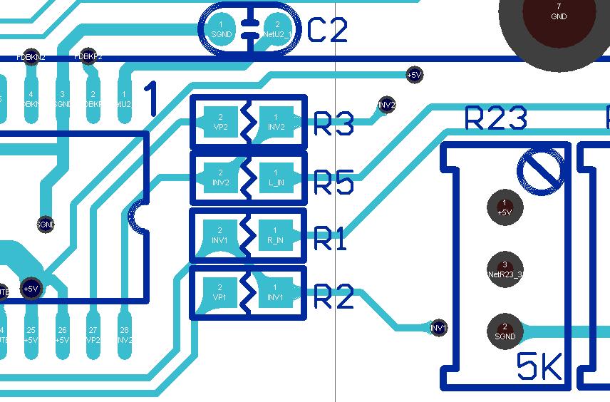

Hey, is there any chance I could save my Hifimediy AMT 2050 V1.2?
I desoldered R1 and R3 inpu tresistors(?) to increase the gain. Yes, I should have read hifimediys post which told me to change R2 and R3 and not touch R1 at all. The problem is now that the thin connection under the surface of the PCB going from R3 towards TC2000 is cut and with my solder skills i am not able to solder it back on. The original value of all R1, R2, R3 and R5 are 22k ohm and I liked the gain value when my resistors values were R1 22k, R2 56k, R3 56k, R5 22k.
If i remember correct those resistor pairs(R1,R3 and R2,R5) were in parallel/series. So my question is is it possible to let R3 be unconnected and change R1 to a value that matches with R2 being 56k and R5 22k?
Another question, does it damage the amplifier when my R3 was unconnected and the amp was on. The channel voltage showed 29.4V :/

Hi, I don't think un-connect R3 is ok, but your amp may not be damaged if just R3 disconnected. You can see from sch that R3 is a feedback resistor so it's quite normal to output high voltage when you open the feedback loop.
I will post a picture here below, may help you to repair.
Ok I'll have to try to repair it. Luckily i have two of those amps so got the other soldered properly. But what i noticed that, there is quite alot more "hiss" compared to the V2.0 version, is this normal? I swapped R3 and R2 to 56k ohm resistors. In my V2.0-board the equivalent resistors were 47k, if that affects?Hi, I don't think un-connect R3 is ok, but your amp may not be damaged if just R3 disconnected. You can see from sch that R3 is a feedback resistor so it's quite normal to output high voltage when you open the feedback loop.
My powersource is a 36V lithium ion if that matters. It should produce noiceless power iv'e understood correct.Ok I'll have to try to repair it. Luckily i have two of those amps so got the other soldered properly. But what i noticed that, there is quite alot more "hiss" compared to the V2.0 version, is this normal? I swapped R3 and R2 to 56k ohm resistors. In my V2.0-board the equivalent resistors were 47k, if that affects?
I think it's not normal. You can try again when you fixed it. And try to check the input connector/cable when you still have such problem.
