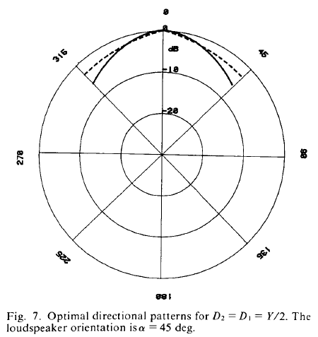

If there is a better model than Blauert then I will use that one, but in my searching I have not found one except a very complex model that would be overkill for what I am trying to do.
Isn't the model used in the Kates paper simple enough? Here's the ideal directivity for the 45° toe-in case (49° 3dB beamwidth):
I also noted a paper that derived the "optimal" directivity pattern. Then they created a DSP system for a pair of speakers to impliment this directivity. They showed a comparison of the predicted directivity and the measured directivity which showed the two to be completly different.
Yes, that was kind of weird. When I overlayed the speaker directivity plots and the ideal curve there was "some" discrepancy

I've read the Kates paper. The Blauert book post dates Kates. Why would I not use the experts curves unless there is more recent evidence that supersedes it? At any rate, I thought that I was clear that I am not interested in deriving the "optimal" directivity, that's easy to do, but pointless if one cannot achieve it. I want to look at how real speakers in real rooms work.
