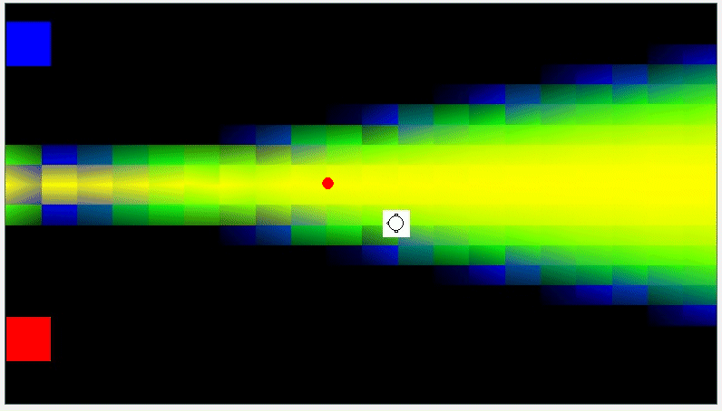

I've animated the pre-after toe-in pictures provided by Earl. The red point is the 60° stereo triangle sweetspot:
You see how it works better, the more you go behind the 60° stereo triangle

Semantically, I prefer to state it as working better with more toe-in rather than going behind the 60° stereo triangle. The image width will collapse if you go behind the triangle. You don't want that. You want to stay around the point of the triangle to get proper width of image.
The points I have been making are more geared to best sound from a center seat. Home theater needs for many seated people might alter these criteria for best compromise of intended use, depending on speakers used.
I said "You see how it works better ...". That's semantically as precise as it gets. Because I don't talk about the acoustical effect, but about the visual impression that one gets from the two pictures.Semantically, I prefer to state it as working better with more toe-in rather than going behind the 60° stereo triangle.
If it doesn't correctly represent, what happens to the ear, Earl probably needs to correct the graphical implementation.
If I were Earl, I would change the color scale to go from black over dark lilac to red, orange, yellow and white. This should allow to give a consistent impression of going from dark to light too.

In my software this change happens in real time for both the angle of the speakers and the seperation. There is an optimum, but your animation makes the point almost as well. At first I was surprised by how much the situation improves when the speakers are moved closer together. But then I remembered how strongly the effect depends on delay differences and it made perfect sense.
I have experimented with the forward and back positions and I agree that one does not want to be too far back of the point of the triangle. The stage width minimizes even if you are still in the sweetspot.
That would be the algorithm not the graphics. I admit that there may be better algorithms, I just havn't found them.If it doesn't correctly represent, what happens to the ear, Earl probably needs to correct the graphical implementation.
Rudolf
I read a very in depth paper on the use of color in graphics like this. The colors were precisely choosen to go from brighterst to darkest in a smooth and continuos manner and they do that. Now should "good image" be bright or dark? That is basically the only option available.
I remember that you put some emphasis on that - and rightfully so.I read a very in depth paper on the use of color in graphics like this.
It's like real life: The good ones are always bright and the bad ones always dark.The colors were precisely choosen to go from brightest to darkest in a smooth and continuos manner and they do that. Now should "good image" be bright or dark?
I believe the culprit is the diagonal shading of the blocks. To me it makes some "outer" blocks look brighter than the adjacent "inner" block. But that is just cosmetics.
