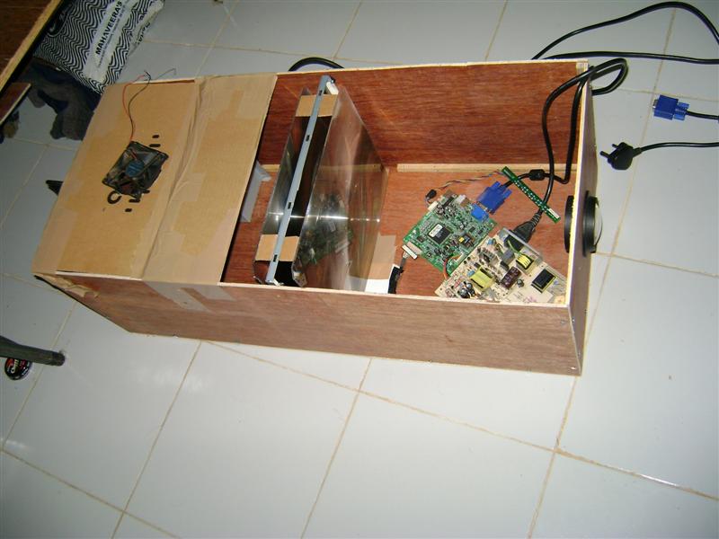

Hello all,
I have completed my projector build yesterday.
Components used ...
15 inch sharp lcd monitor
250 watts osram metal halide - single end
Ballast 250 watts (local make)
fresnel, triplet and reflector from an old OHP
Box - made with plywood.
I got a projection size of 100 inches with good brightness
Projection is visible with room lighting, but it's good only with all lights off.
I have not painted my pojector internals black, and tweakings are pending. Projection screen is normal wall with off-white paint.

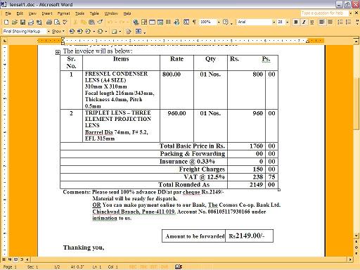

Prashant! Hi from fellow Delhiite!
u can try Lensel in Pune. I got a quotation from them for both the lenses and fresnels. Only thing is they dont have a good online payment system. see attachment.

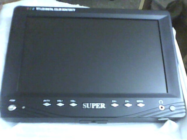

thanks auldthief for replying...

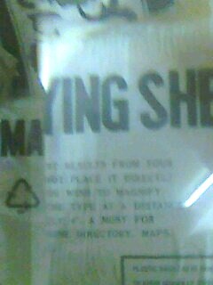

For now i've bought 2 sheet magnifer from ebay, n will be using then in place of fresnel. I've already stripped my LCD tv. But I m stuck with projection lens issue.
i m trying to use a regular magnifying glass as projection lens, but i m able to project a small part of my 7" lcd screen.
i will go out to buy a magnifier with bigger diameter. this is a small one.
