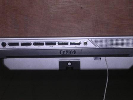

i will refine, block all light leaks,play a DVD, pause it, take pictures & then post it & then we will see. i know that VGA or XGA LCD image is going to be better but my purpose is to watch movies only.
as i told, screen door effect was evident only when i was closer than 5 ft. obviously i am not going to watch movie from such a close distance.

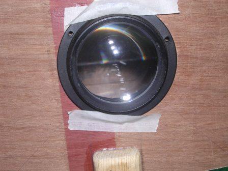

people will ask , why i am experimenting with smaller LCD when others advised to use larger one. 2 reasons,
i had a small fresnel which could accomodate a sceeen no larger than 5". now 5" screen i coudn't find & didn't want to buy new fresnel, so decided to go with smaller.

the images i have posted were running videos( did not pause them). they are ought to look poor. will post still images soon.

LCD; JXD multimedia player: rs 2000

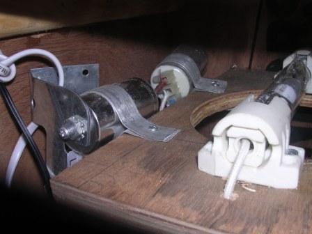

MH lamp 150 watt with assembly: rs 950

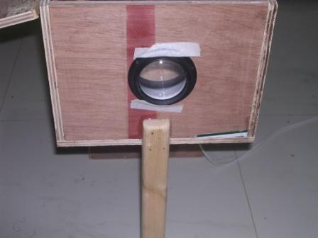

Box: rs 1800( had to get it done by a carpenter)

Hi upgraded my projector with new LCD
Hi all i have upgraded my projector with new lcd from a
