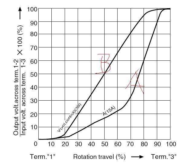

Hi roblenk,
Thanks for your sharing
For the problem you said, to my opinion, the VOL KIT just like a B type (also say linear type) POT, please refer to the picture below:

r2r- suspect steps
lu
this is defineately not a log vs linear issue
step 26 is half the volume of step 27 and doesn't change until i get to step 23 then it is at an appropriate volume louder; than 27-
this is tough to say but very easy to hear
another way of saying it ;
the transition from step 27 to step 26 should be a bit louder at each step- it is not, in fact 26 is half the volume of 27 and stays at that same level for the next two steps and then it returns to where the volume should be at step 23- ie discernably louder than 27.
is no one else having this problem?- ie it possible that there is a short in those relays? I can take the board out and apply air to it but it will be several hours of work- I'm hoping for an easier solution
