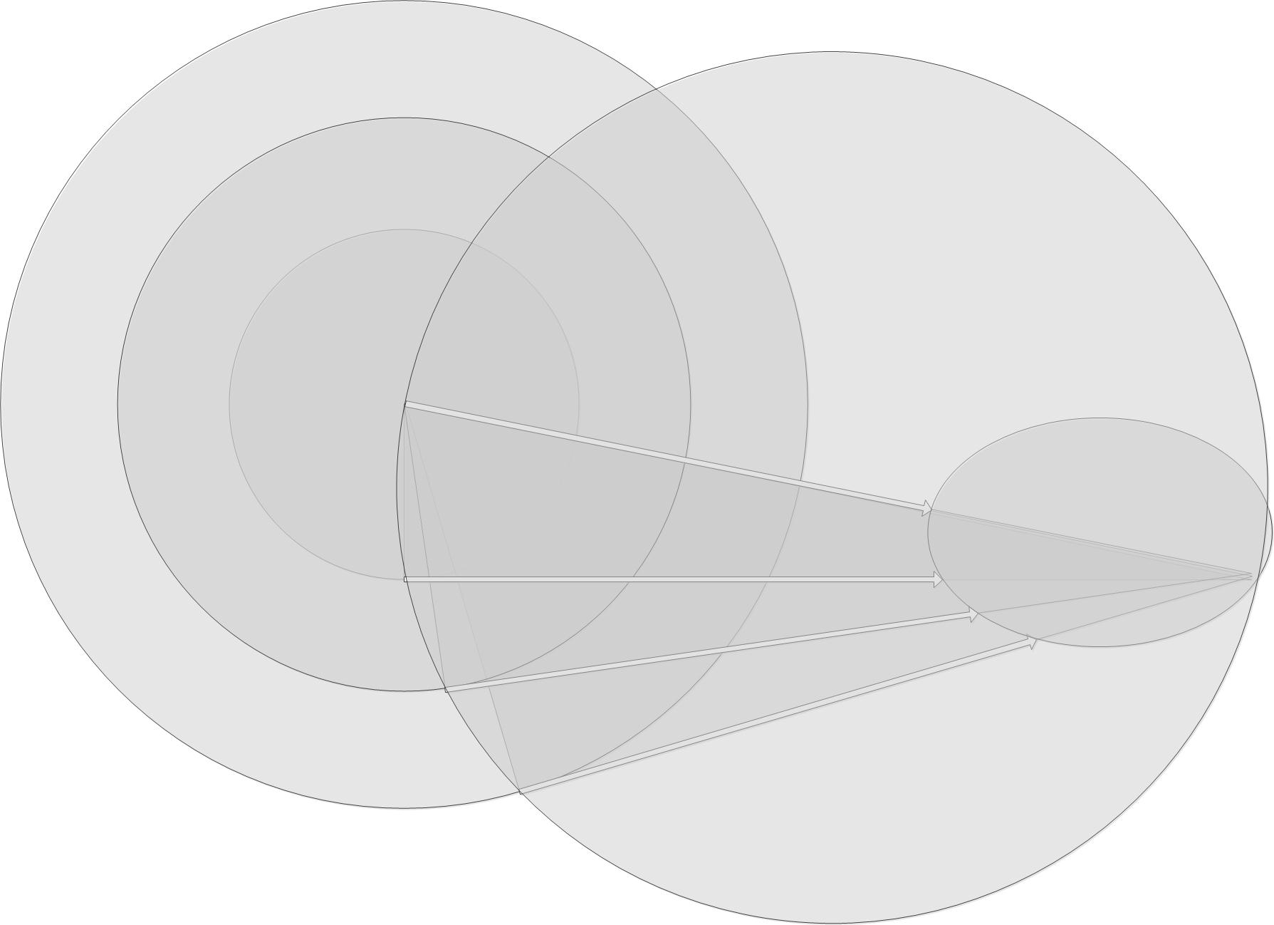

Arm path
I edited a possible arm path in Visio. The three circles at the left represent the inner radius (65 mm), middle (106.5 mm) and outer radius (150 mm) of an LP. The overlapping large circle (Thales circle) shows the path of the stylus. The three 200 mm long arrows are a randomly selected length of arm in three positions. The ellipse is the path of the arm anchor (vertical bar). I don't know how is the ellipse determined, it might be completely wrong.
A portion of the ellipse (from arrow point 65mm to 150mm since no need for the stylus to travel to the spindle) can be a portion of a circle which its center creates a pivot, and that's the concept of the Birch patent and somewhat similar to the Schroeder LT tonearm concept. Tom's tonearm requires no precise guiding mechanism as the stylus will find its tangency by the groove. Nice drawing!
@oshifis, the reply posted by directdriver is correct. The tonearm “guides itself” by means of the friction between both walls of the groove. Because the tip of the stylus has properties, there is a equilibrium between the friction at both sides of the tip of the stylus by the pull of the record. The balance is at right angles to the spindle. Therefore, when we increase the mass of the tonearm, we decrease the ability of the tonearm to react to the variable distance between the grooves.
