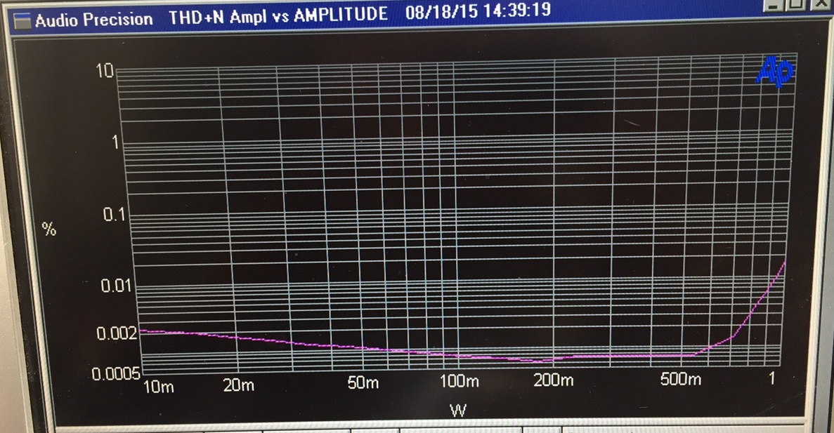

The PSU has been updated, with another RC filter stage and more local decoupling around the regulators and load, the PCB layout has changed to further isolate the PSU noise from the signal circuit, an optional feedback path has been added to control DC offset if you choose to use BJT output transistors and/or want to try different opamps.

As mentioned earlier in the thread, you could build a discrete opamp. Papa even has an article on how to do it - https://www.passdiy.com/project/amplifiers/diy-op-amps
You could also bypass the opamp entirely as 6L6 stated in posts 34 & 35.
If you want more of a Zen style, depending on how you want to use the amp I bet it would be a reasonable approach to bypass the op amp to make a unity gain amp, and feed it with a DAC attached to a Zen I/V stage with the gain increased as per the article.
Honestly, we can complain about the fact that there is an op amp in the design until the cows come home, or we can accept Wayne chose the best tool for the job, or we can work around it to acheive what we want. This is DIY after all!

Yes this project does use an opamp. You can put a socket in and swap to your hearts content. Or solder in two fets and drive the output stage or a small board with what ever you want.
I tried to keep it simple because for some people it is difficult to get two transistors biased up.(it was for me at one point) The skill level here is from very basic to very advanced so this is a basic project that should pretty much just work.

I'm looking forward to the flexibility of this design - Want to use Mosfet output? Sure. Bipolar? Sure! Fet-input opamp? Absolutely! Bipolar-input opamp? Of course! All-discrete? Use a discrete opamp!
And, due to the sonic transparency of a source-follower Class-A output stage, (and directly into headphones...) this should be a fantastic tool to listen to the differences in opamps.
