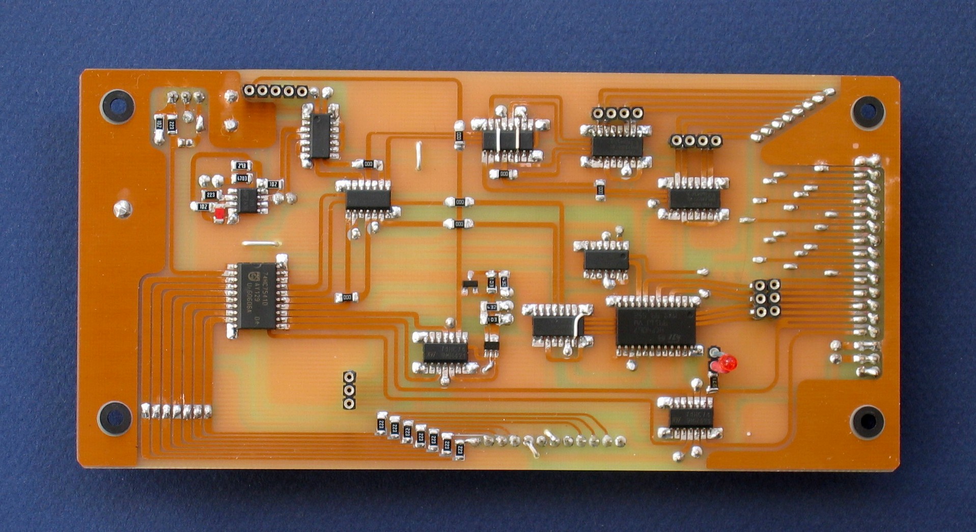

Because it seals too well, you should make sure the PCB is totally clean and dry before spraying.
I preheat the board to 60°C in an oven to drive out any moisture completely.
And also bake it at 80°C for half an hour after spraying.
This shortens the specified 72 hours drying time.
The resulting film is thin but very durable, and seals extremely well against oxidation.
We used this until we discovered that if you bake the photo resist of the PCB at 120°C for half an hour, its chemistry changes such that it is solvent (IPA) resistant.
This applies at least to the photo-sensitive PCBs from Bungard.
So we do a second exposure after etching to expose the solder pads, then bake.
You can see the result here (in dark orange).
