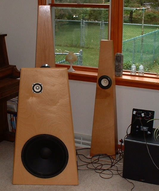

Hi Jim - Great Job!:up: Very interested about your end results and impressions as I have been considering something similar but adding my old pair of ESS AMT1's to the top end. It will wind up resembling Stig Erik's Bema 150 thread http://www.diyaudio.com/forums/showthread.php?t=142015
Si what I'm up to is Ess AMT1 top - FF85K mids - Alpha (maybe Beta) 15 inch on the low end - Bi Amp powered - passive x'over. BTW - what are you doing for your crossover?
XO’s, funny you should ask. I intended to mention this later, but since you asked...
I bought the parts for the HF end of the XO, but plan to try a Dayton (PE) plate amp that has a second order filter for the woofers. When I built a Triska sub (PE project) last year I bought the plate amp recommended in the project. It’s a 70 watt amp that has an adjustable XO with second order filter. With only a second order XO, I couldn’t get the sub to blend properly in any of my systems. When I tried another Dayton plate amp (240 watts) that I bought for an older sub, the Triska worked just fine--because that amp has a fourth order filter. Since Martin’s design used a second order filter, I thought: “Why not re-purpose the 70 watt amp? If it works out, I can use it with this OB project, then move the Alphas and the plate amp (plus another) to an H-baffle next year.”
The cost of the passive XO parts for the woofer is almost the same as the cost of the plate amp. If this works, I can avoid buying passive XO parts for this OB and the H-baffle. I’ll let you know what happens.

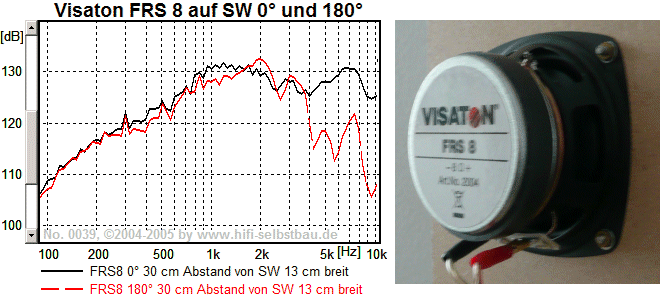

In fact I got the best performance from my 3'' driver (Visaton FRS 8) when mounting it exactly that way :cool::

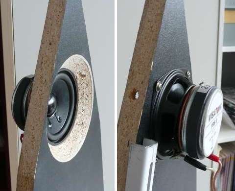

The only tricky part I found with rear mounting the FF85K is that like a lot of drivers with pincushion basket frames, there isn't a lot of margin at the corners. In any mounting panel thicker than about 6mm, you'd probably want a bevel, which won't leave a lot of material for screws, without using a separate mounting clip.
Rudolf, how did you mount the drivers in the OB pictured?
The baffle thickness starts with 4 mm at the driver cutout, which has a tight fit. You don't want to loose any mm there. The mounting screws have 7-8 mm before they brake through the 45° bevel. The pictured baffle is 16 mm chipboard, but for a lasting solution I would insist on plywood. That would ensure a good enough fastening torque of the screws.
With the rear mounted driver the front-back response changed to this (compare to post #477):

If I get any more excited, it might be hazardous to my health! With each build I have kept looking to get closer to the characteristics I find appealing in Lowthers, Maggies, Martin Logans, etc. These OBs are delivering on that. I know that these qualities are not universally appealing, as my brother found them to be just OK.
As to the design specifics: I have no way to quantify the effects of the beveled edge (it should reduce diffraction,) the side panels (which do follow the angle of the edge's slope and should have some effect similar to a shallow 'U' baffle,) or the 2x4 bracing (which should improve the quality of the bass.) I have never listened to this MJK OB in it's Rev 1.0 style. When building I just go on what little knowledge I have and a gut feeling for what might be helpful. It would be very interesting to compare my build with the original version. And if there is anyone out there in the upstate NY region in possession of the rectangular baffle style, I would be eager to get together and compare.
