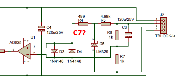

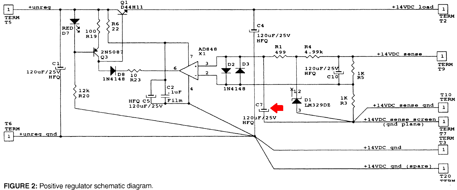

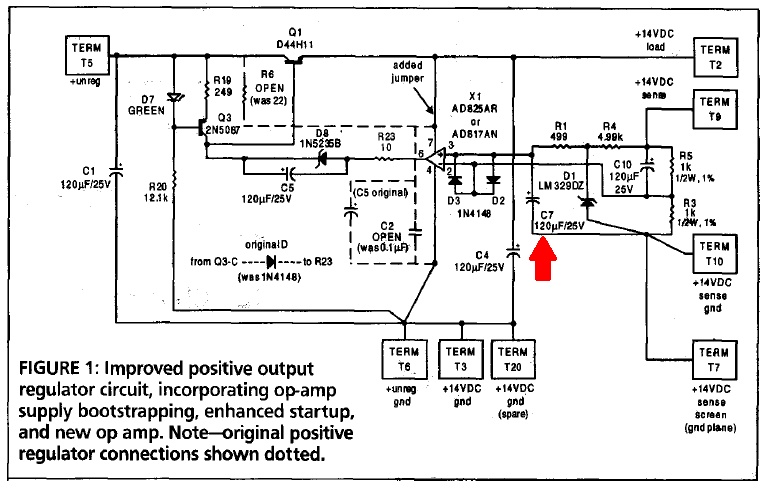

Jan, I suspect this was an intentional act rather than a mistake, but capacitor C7 from the original TAA Part3 article, is omitted from your PCB and your schematic. I imagined there might have been discussion about C7 on this thread, and indeed I did search for "C7" but found nothing.
Schematic snippets below for comparison.
-Mark

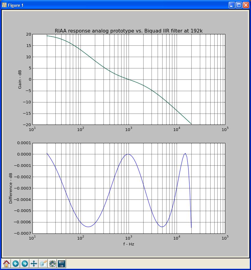

I'm preparing an article for the next issue on biquad digital filters for RIAA, crossovers, equalization, etc. Thanks to the last two issues of Elektor, I have been turned on to Python as a free development platform. Now it looks like I can provide a free software tool for filter development. Here is a screen shot teaser, +- .00035 dB do that with analog. :)

Mark,
Actually I recall there was, and am trying to recollect from memory here - it seemed to affect the sound quality for some reason.
1, It may well be that if the noise of the reference diode was at very high frequencies (inaudible anyway) then adding an RC filter may attenuate this noise downwards into the audioband or near it.
An FFT or looking on a scope for the freq. of the ref. diode noise might be a clue.
2, Their is leakage errors introduced by the capacitor here. This is well known and I have seen buffered references using additional op amps with much smaller RC networks using films/ceramics to deal with this issue.
I once seen a snippet of a schematic of a WJ design that bootstrapped the capacitors in this location to reduce the leakage errors. Low leakage capacitors will help. However I never seen the full article or explanation, or it may be in one of WJs books. Personally, I never liked the capacitor over the feedback resistors. This is to keep noise gain down by I think a factor of 3. But you can run it half wave - or lower source Zin for the main output follower.
3, Maybe the capacitor through its leakage errors when using the remote sensing can allow spurri in possibly audible without attenuation of any form?
I do not know being honest.
Possibly a worthwhile tweak is do what Doug Self does with his CCS in his power amps and split R into 2 for the main led CCS (that drives the output follower) in these designs and add a capacitor at the midpoint. A long gate J310 would help also. I was thinking this, because if your look at the PSRR/loop gain of the AD825 it is poor at LF albeit better in many other areas like slew rate/settling time and so on. It all depends on what input voltage you have and what you can burn etc.
Only thing I dislike in Jans new design is the lack of the follower or shunt arrangement after the op amp and before the output follower. There may well be a stability issue here however. That was the genius of the modded '95 design and WJ's EDN article.
