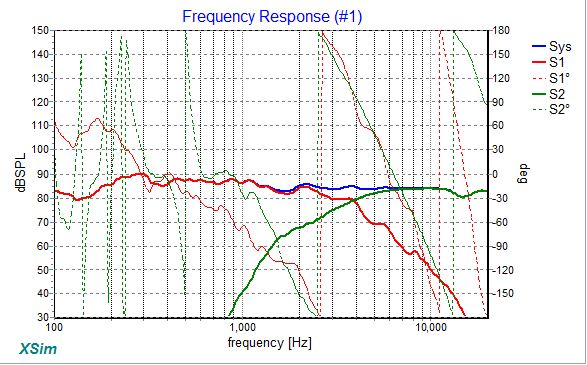

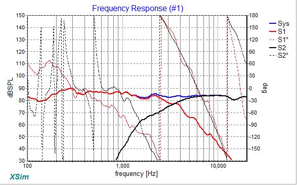

Following further listening with one or two recordings showing signs of being slightly 'shouty' at certain points on voice or trumpet I looked at the Xover again and reduced the midrange by 0.75dB or so by adding a few turns to the first inductor. I also realised I hadn't applied mic calibration to the woofer section. Its effects are mainly above 5kHz but it does make a slight difference/improvement to the woofer roll-off. The low pass roll-off slope now looks better and the occasional slight problem on those particular recordings has gone. Phase tracking through Xover is also marginally improved
Having lived with these speakers for a few weeks now I'm very pleased how little final voicing has been necessary...which no doubt highlights the importance of simulating from real measurements.
I'm considering air cored inductors but when I calculate the massive increase in wire length needed for these I have second thoughts. Years ago in an external Xover I switched many times between cored and air cored inductors (1.75mH if memory serves) and through listening comparisons formed a clear preference for superior clarity of the cored, however with smaller inductors this time perhaps the results could be different.
Attachments:-
Response v1.1(before) and v1.2(after)

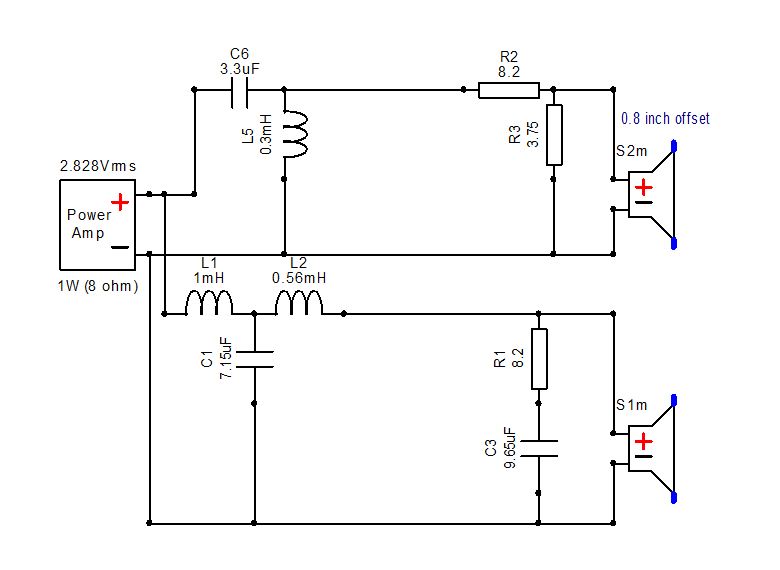

Crossover schematic

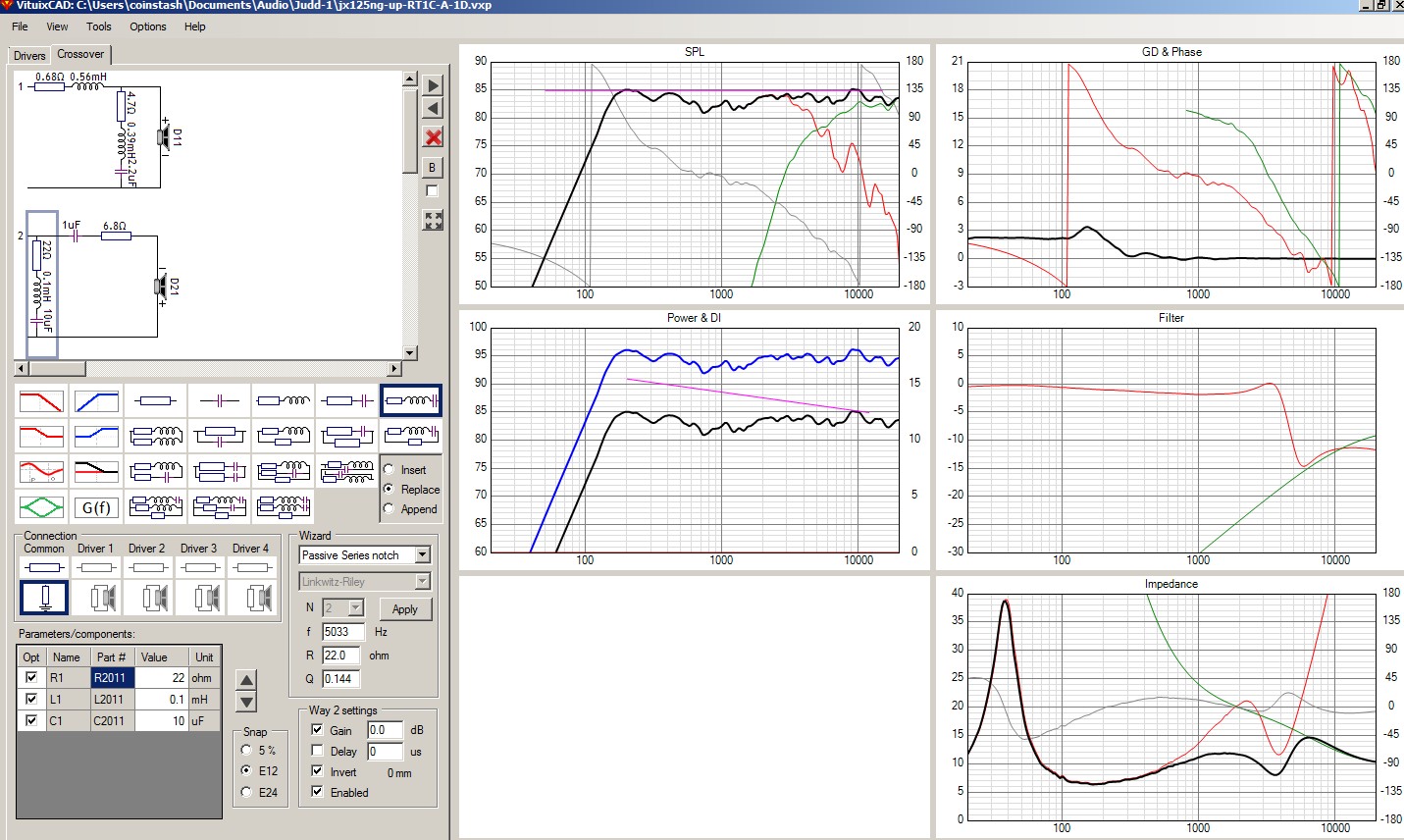

I'm building a surround system and found this interesting since we're going in similar directions. I went for the JX125NG with Hi-Vi RTC1-A ribbons. One suggestion I can make is that the impedance and phase curves could be flattened with a suitable network, otherwise it looks awesome to me. Since I've worked on electrostatic design your description of them sounding like the Quads is encouraging although I was expecting good things anyhow, having owned and/or heard many Jordans before.
Are your frequency response measurements exported from Holm without smoothing? Looks like you have a lot of reflections/room effects in there. If so, try using the 'complex smoothing' function in HolmImpulse before exporting as it implements variable width windowing which will reject late reflections.
After exporting to .frd the impulse response data is lost, so any smoothing applied in Xsim will only visually smooth reflection effects rather than reject them.
Haiku
Thanks for the suggestion. I might look at that again at some point but I was keeping half an eye on impedance phase too. One or two of my earlier Xover circuits had flatter impedance curves but compromised other design considerations which were important to me in this design.

Following further listening with one or two recordings showing signs of being slightly 'shouty' at certain points on voice or trumpet I looked at the Xover again and reduced the midrange by 0.75dB....
We now see what you like. Turns out, what you like is +6dB in the bass relative to the tweeter.
Why waste time fussing with the crossover elements when tuning follows listening?
B.
I assume that's rhetorical but I'll answer.
Who knows why, but apparently most of us find a falling response more listenable than one which measures flat and I'm no exception. This design sounds neutral to my ears.
Regarding simulation vs tuning by ear, why not use both. As a professional musician for 30 years (with absolute pitch) and DIY audio hobbyist for even longer these ears ain't bad. Measurements and simulations save time.

Here are the simulated charts and crossover network. The components inside the box remedy most of the lumpiness in impedance and phase. You might think this will sound bright but 15 degrees off axis it should drop at high frequencies. I may do something about the bass resonant peak if I decide to current drive them, but that would need to come after actual measurements.

TimA: The crossover is designed to kill a really nasty peak at 6kHz and was the simplest design that could achieve that.
