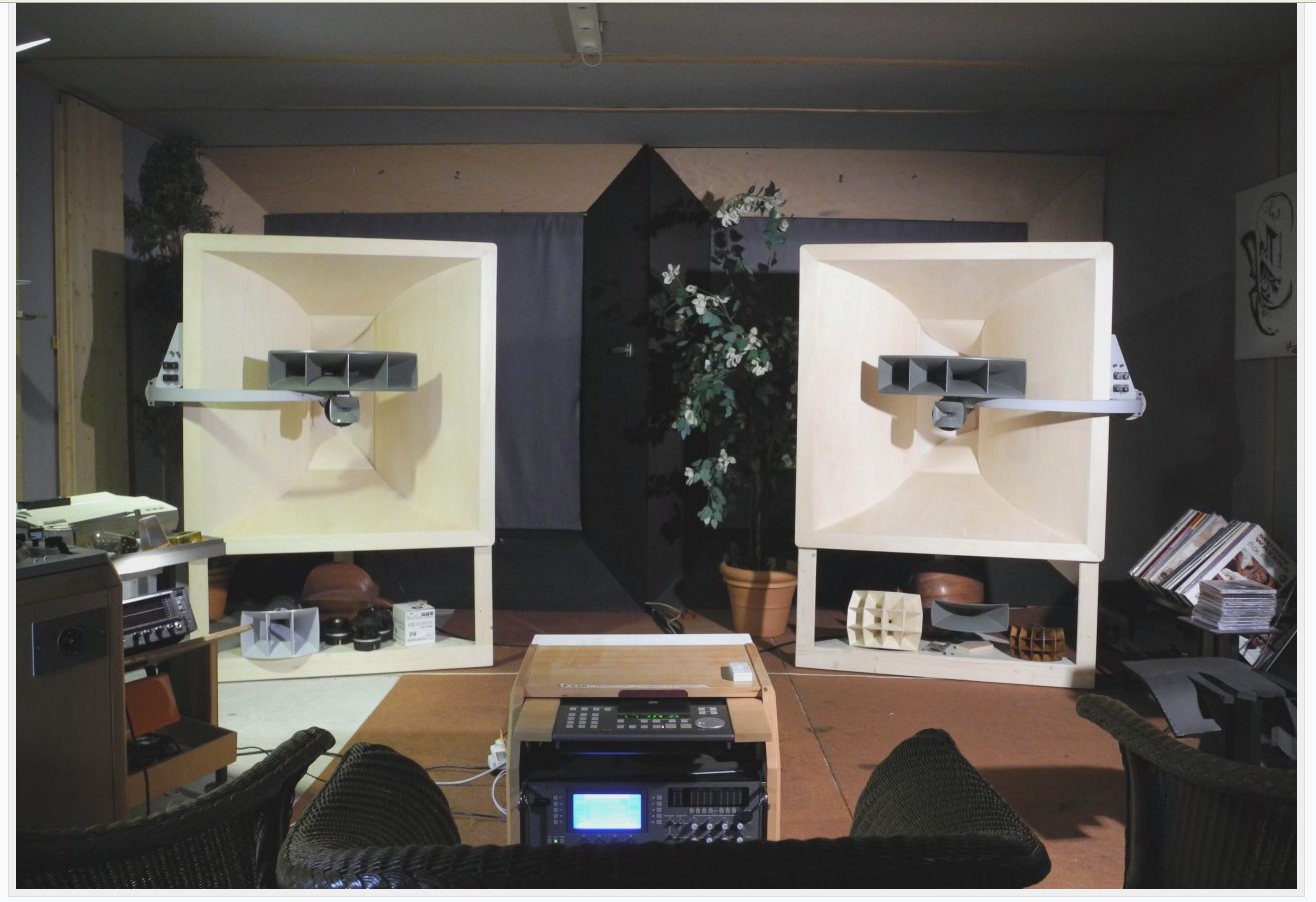

I have ABS plastic horns, that sound like if it was made of ABS plastic, and horns casted in plaster cast that sound like if it was made of stone - that does not improve on harshness BTW!
And now I have wooden horns, that sound like if it was made of wood. It was a few more weeks work, but is was worth it, and the sound is plus naturel. I plan to make every horn in wood from now on. It is nice to brush up on my wood carving skills from primary school. It is also a very therapeutic hobby, if one has any phycological issues, horn-related or not.
The smaller horns will be even easier. The giant horn was a messy start. I learned a lot during this first prototype.

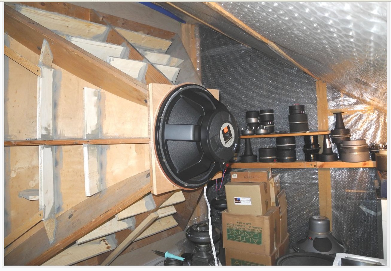

I have started to build this: Folded bass horn - The Paper Horn by Inlow Sound
But I am not sure if I should finish. Mine would use twin 12". There might be better designs out there, so build is on hault.

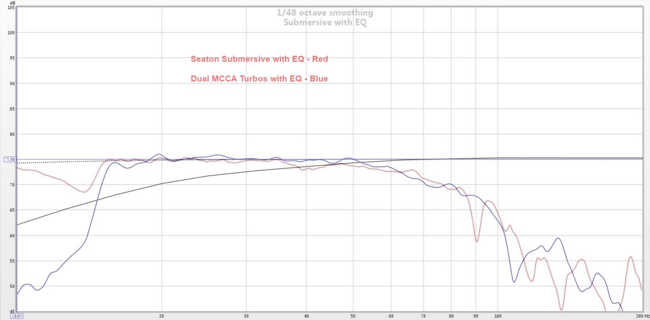

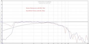

I was thinking of a regular subwoofer, but an awesome one, like the $2k Seaton submersive. Look at how deep it goes!
