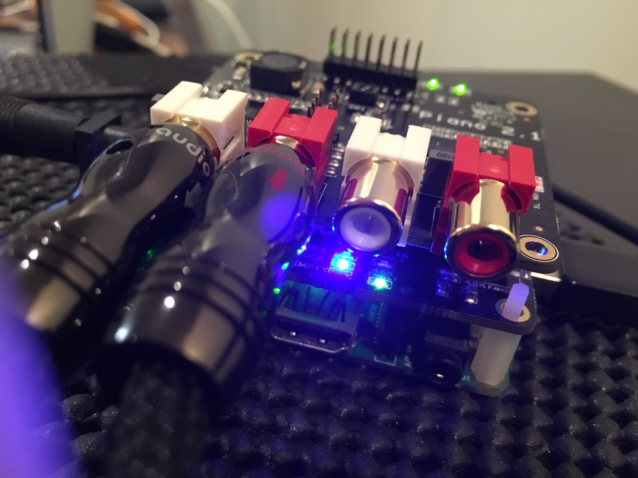

Hello,
Have it hooked up, FIFO looks to be working.
To start, do I need to use max2play to get the Dac running? It's 2 mute lights stay lit.
I'm running Moode 2.7, with Generic i2s selected, can Moode be used?
Also I have it's dip switch set to RPi compatible.
Thanks!

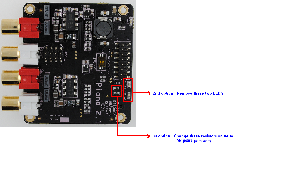

attached the 2 modifications for the Piano 2.1 (hardware to work on RPI)
