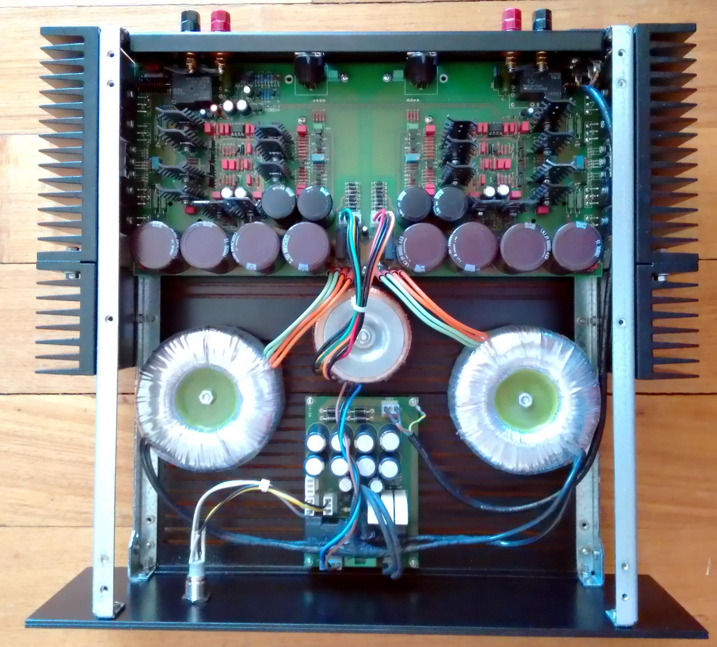

AW120 diy clone
Hi jorgovanko,
just a hastingly taken picture of the AW120 clone machine as it stands. As a matter of fact, I have a new chassis specifically built for the purpose by a friend that is more spacious and offers better cooling, so I will be transplanting soon.
As I said I have given up on the higher power clone due to costs and time constraints.
Cheers.

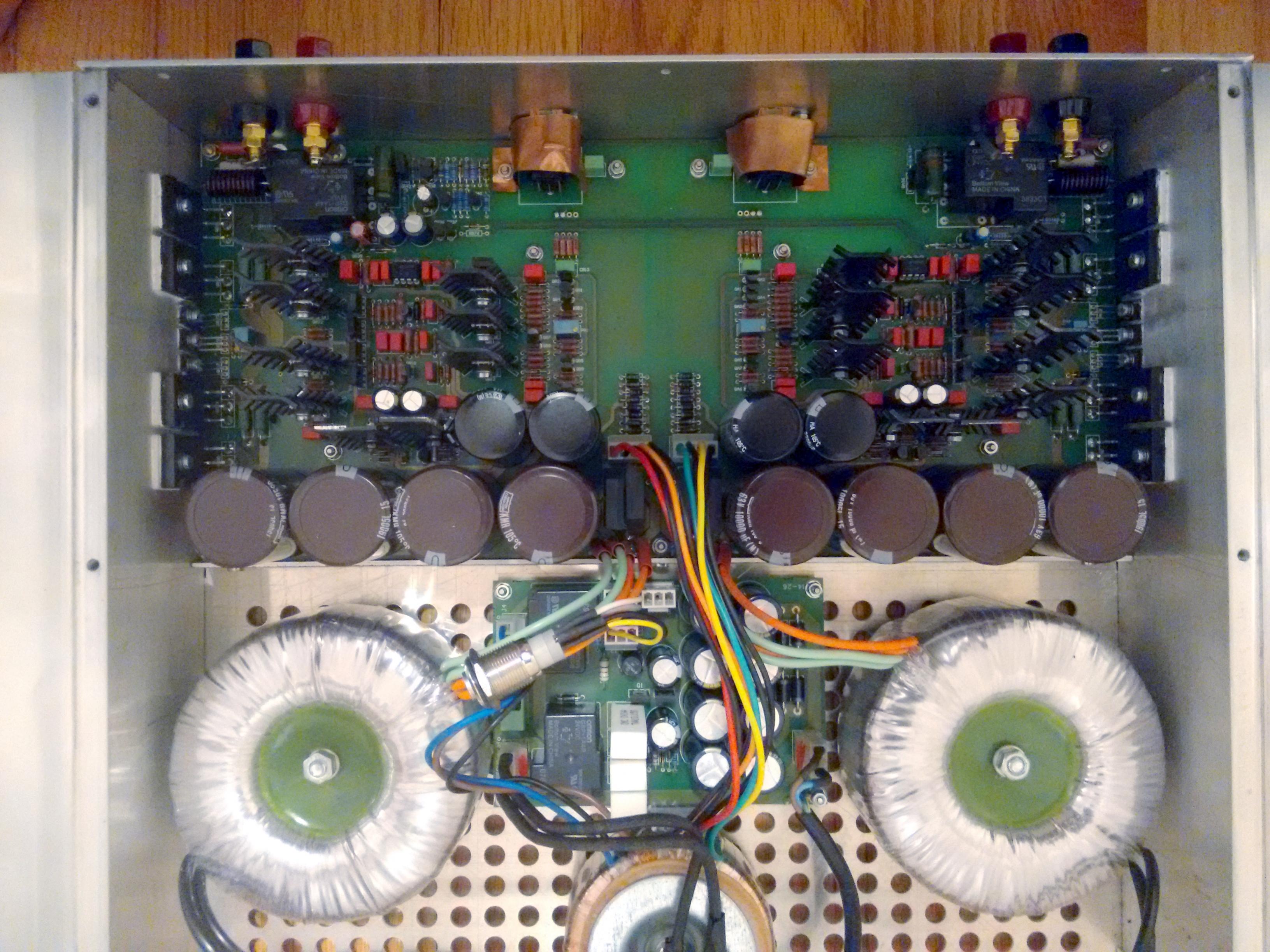

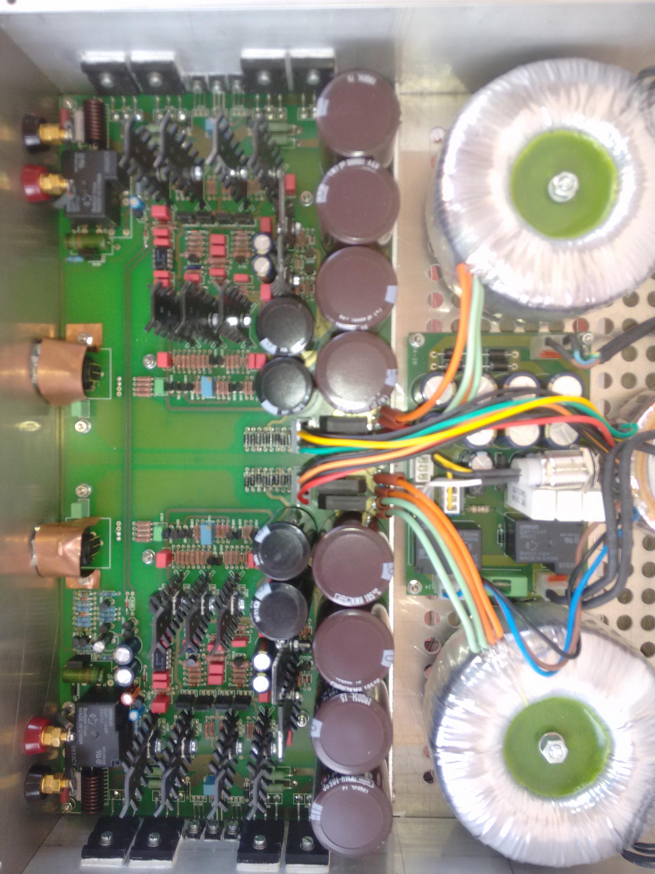

Thanks for the kind words jorgovanko.
The original pcb is deeper and has the trafo cutout in the middle, i.e. it is geared toward a shared trafo between the two channels (with isolated secondaries per channel). So I though I might as well go for separate trafos per channel, hence the newer pcb.
It turns out the idea of paralleled relays at the output is a bad one, so I have hacked the pcb to include a single higher-current one per channel.
There is also an extra pcb taking care of the trafo soft-start, bypassable mains dc blocking and soft power on/off.
The voltage gain stages have their separate power transformer.

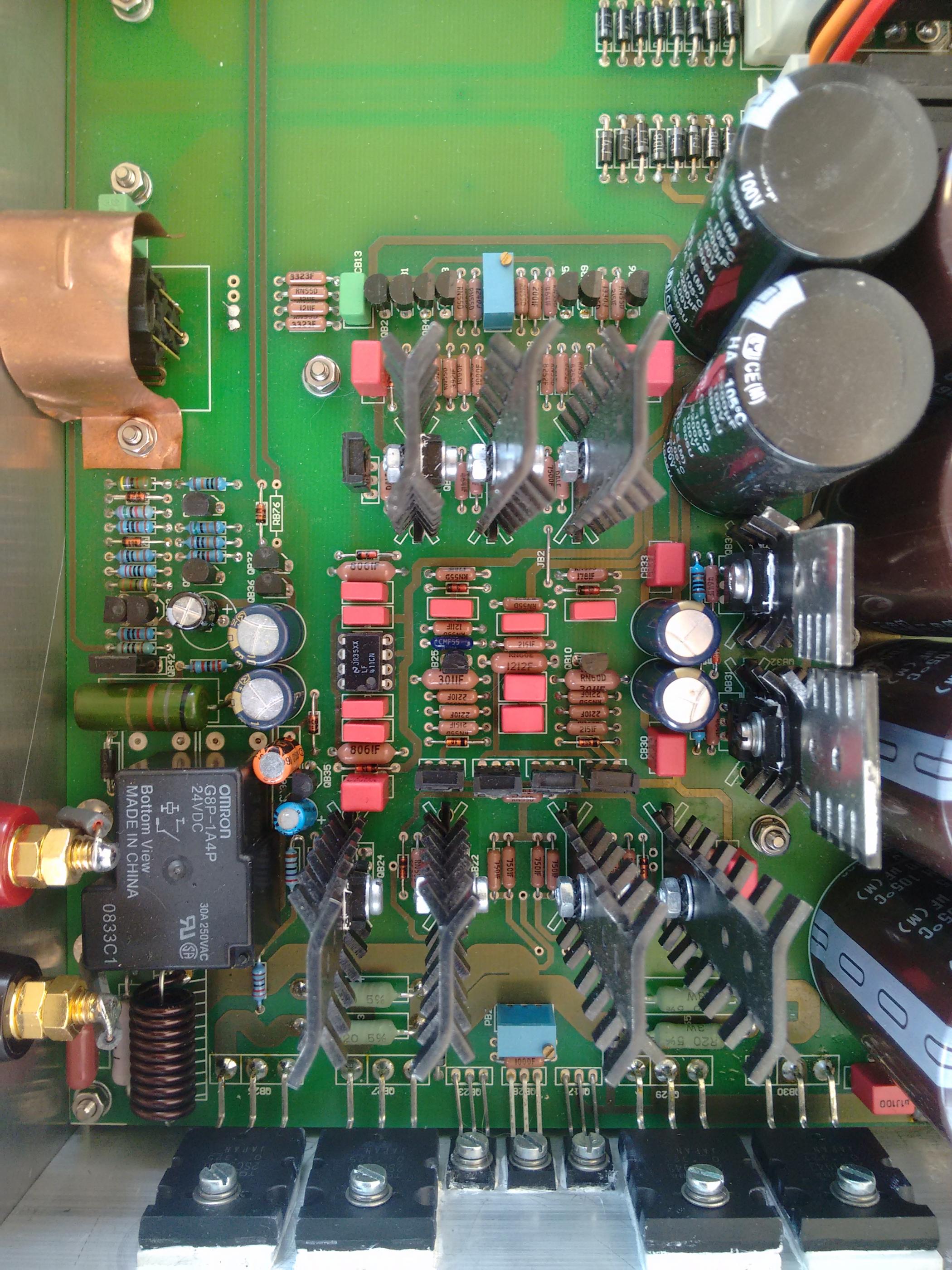

I worked over this weekend long times to make minor corrections to the schematic and pcb. The changes have mostly to do with the protection circuit which is my design. The two channels are now completely isolated using an optocoupler. Protection relays are changed to Omron G8P-1A4P-48VDC, now discontinued but still available and good enough to withstand an output transistor short without contact welding. Also the XLR footprint is changed to a better, shielded Neutrik part, type NC3MBH. Lastly I added some 23Amp capable Molex connectors for the power transformer board to wire connection and made some component shifting to allow for improved heat sinking.
