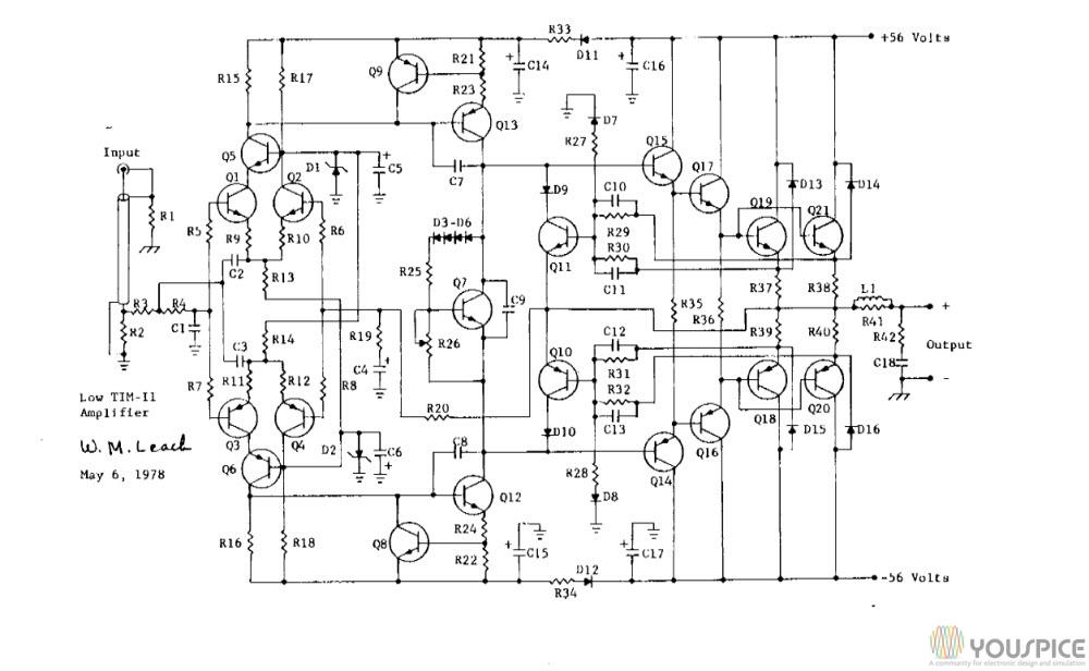

Can you show a diagram or model?In my designs, the sims show a flat phase response and THD20 is a few ppm for the super-power circuits and <1ppm for lower power. THD1 is all-zeroes in LTspice, which is <10ppb, at any sane useful power and less than 1ppm at super-power.
Hi Guys
I do my circuit and PCB design on an offline computer.
The circuits are all fully complementary, with comp diff amps that are resistively loaded and using a resistor-CS instead of active-CSs, followed by an EF-VAS. The VAS Re has a small cap across it, usually 100pF, and a small shunt cap to ground from the collector. Most of the amps use output-inclusive compensation. The small amps I built for home use have a CFP output with a buffer driving them. The front end runs off 24V rails and the output stage uses lower ones since it is biased hot. Two such amps drive the speaker in bridge mode to eliminate ground reference disturbance.
The high-power amps using 100V rails have a double-cascoded input stage - all BCs up to the EF for the EF-VAS,then D-gain-group 2SA1831-2SC3503s for VAS and predrivers. Usually 1302-3281 outputs, sometimes using 4793-1837 as drivers. I've designed these larger amps using a variety of output stages, including EF3, EF4, CFP and Quad-Comp-followers, sometimes with class-G multi-rails.
Class-G or H tends to have miserable THD compared to a straight linear amp, so I use a hybrid circuit that also simplifies the protection. The class-G using an EF4 and eight output pairs sims at about 3ppm20 at 2 and 4R at full output.
In all the amps, the closed-loop phase response follows the shape of the closed-loop gain. In built amps, I bandwidth limit the input and use a choke at the output. None of this is what I would consider noteworthy. My math skills are limited and my knowledge of Nyquist next to zero, so probably I'm doing things the hard way, but keeping things simple so i can understand them.

This is not good enough excuse to show schematic, picture talks many languages, English words only English.
Hi Guys
T117: Nothing to do with Lin or Thompson. More like an evolution of Leech. Fully symmetric - neither Lin nor Thompson are.
The circuit descriptions above are pretty straightforward. Like I said, there is nothing new in them just a lot of tweaking despite the fact that most of the values are also tired but proven. I'll see if I can get a schemo on a USB key sometime.

Understand you.More like an evolution of Leech.

I know Leach, but I am interested in your compensation. You said you used multiple compensation with no roller coaster open loop phase behavior.
Hi Guys
Here are some PDFs of some basic circuits I use. The input section is uncommited with respect to being inverting or noninverting, but that is inconsequential to the compensation shown. I said above that the compensation is usually output-inclusive mixed with some shunt to ground from the VAS outputs - pretty standard as far as I know.
There is also a typical EF3 output section showing the protection method I use. The bias BJT mounts on the face of one of the output devices for quicker response. Yes, there are no base-stops. I've never found a need for them and the output stages I've built never oscillate. Maybe I'm just lucky?
Not shown is the decoupling between the input section and output section.
