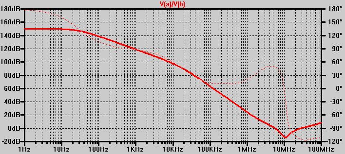

Your thumbnail plot is an open-loop response. I was referring to closed-loop response. I know you've looked at one of Dadod's CFA amps and was not too impressed. His designs always have the roller-coaster closed-loop phase response, and it is only recently that he has got THD figures down to what I consider acceptable. His current-conveyor preamp has a flat phase response, which I believe to be much more suitable, as Marshall Leech described back in 1978.

Dadod: Your link goes to a post near a schematic but no gain/phase plot or THD numbers.
Overall I like your designs. I just don't understand how such a roller-coaster phase plot can be conducive to good sound or good performance?

I don't see why you are afraid of that type compensation(two poles). The close loop gain has very nice phase behavior. By the way, the sound is fabulous.

Dadod: I'm not afraid of two-pole comp and use output-inclusive comp in my amps. My Q still is unanswered, though. Amps like your CFA s and the other guy's "amp designed during lunch breaks" both have a phase response that is never a straight line and goes up and down and up and down. Both amps have multiple compensation loops.
My amps have multiple compensations means also, but the phase response is flat within the closed-loop bandwidth. This makes sense to me. I'm not doing anything novel as far as I know.
I guess my Q boils down to just waning to understand the importance of phase response. I know about phase margin, rather it is the shape of the phase curve I question.
