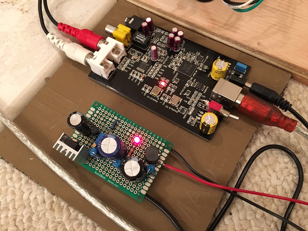

Hi all, i ordered one of theese boards from ebay, the red one with 3 small XCO-s. It worked fine from usb, but when i connected external power (5V from a 7805) the main regulator near the dc jack blew up, and there is a short between 3,3v and gnd, i traced it down, it is the U4 chip wich feeds through an inductor to the xmos chip, and connected to U5 chip. I cant figure out the part number of the chip there is DX JRUW written on it, i did not found it in smd catalogs, and google neither. Can someone help me out?

I'd like to use this to see what can be done to improve sound quality, without spending more than about the same as the board cost to start with, but am thinking of:
1. Adding an ultra low noise regulator to the main input and feeding it off a 9V linear PSU.
2. Swapping the electrolytics for better quality components (maybe with higher capacity for the power rails.
3. Replacing the very simple 3.3 V regulators with lower noise versions on boards.
4. If budget allows, replacing the clocks with TXCO's
5. Other tweaks discussed in this thread.
Regarding point 5, it would be good to get some more guidance here. some of the posts that describe the tweaks aren't easy to follow for those (like me) who are unsure of what they're doing.

I have removed the power selector switch and am fitting an ultra low noise voltage regulator to feed the 5V bus. Does anyone think there would be any advantage in replacing the 3.3V AMS1117 regulator, next to C53?
