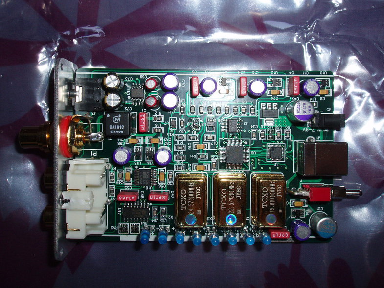

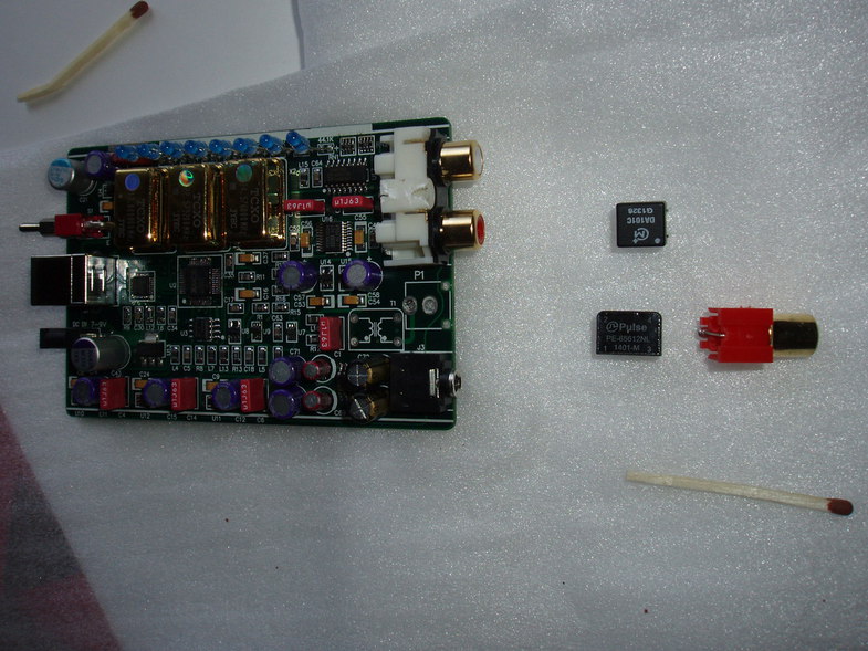

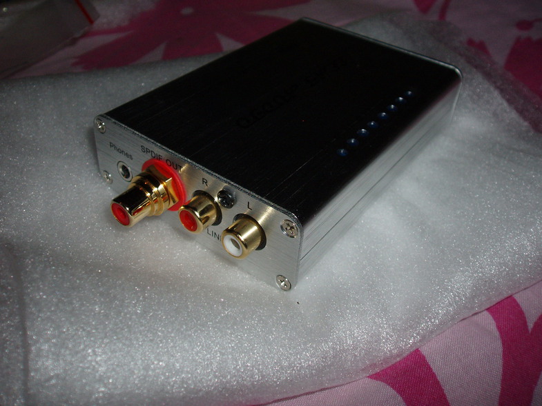

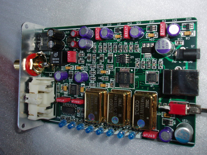

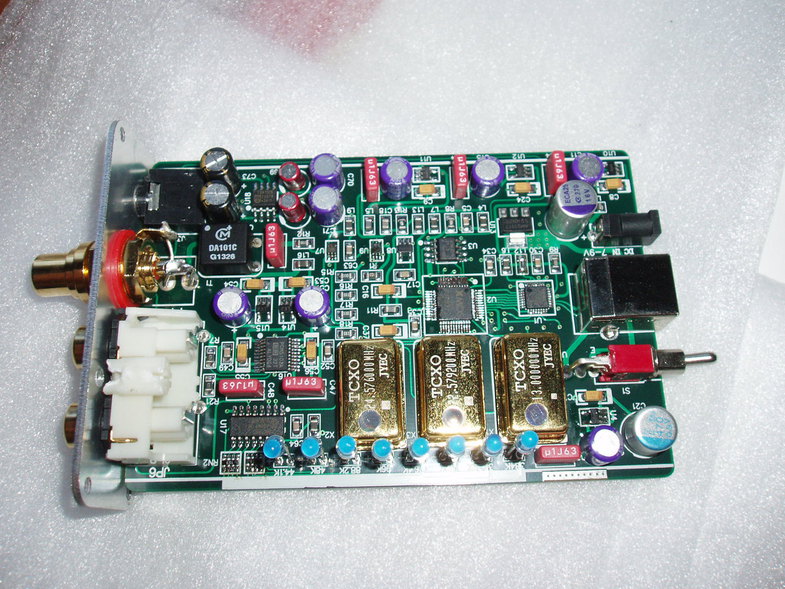

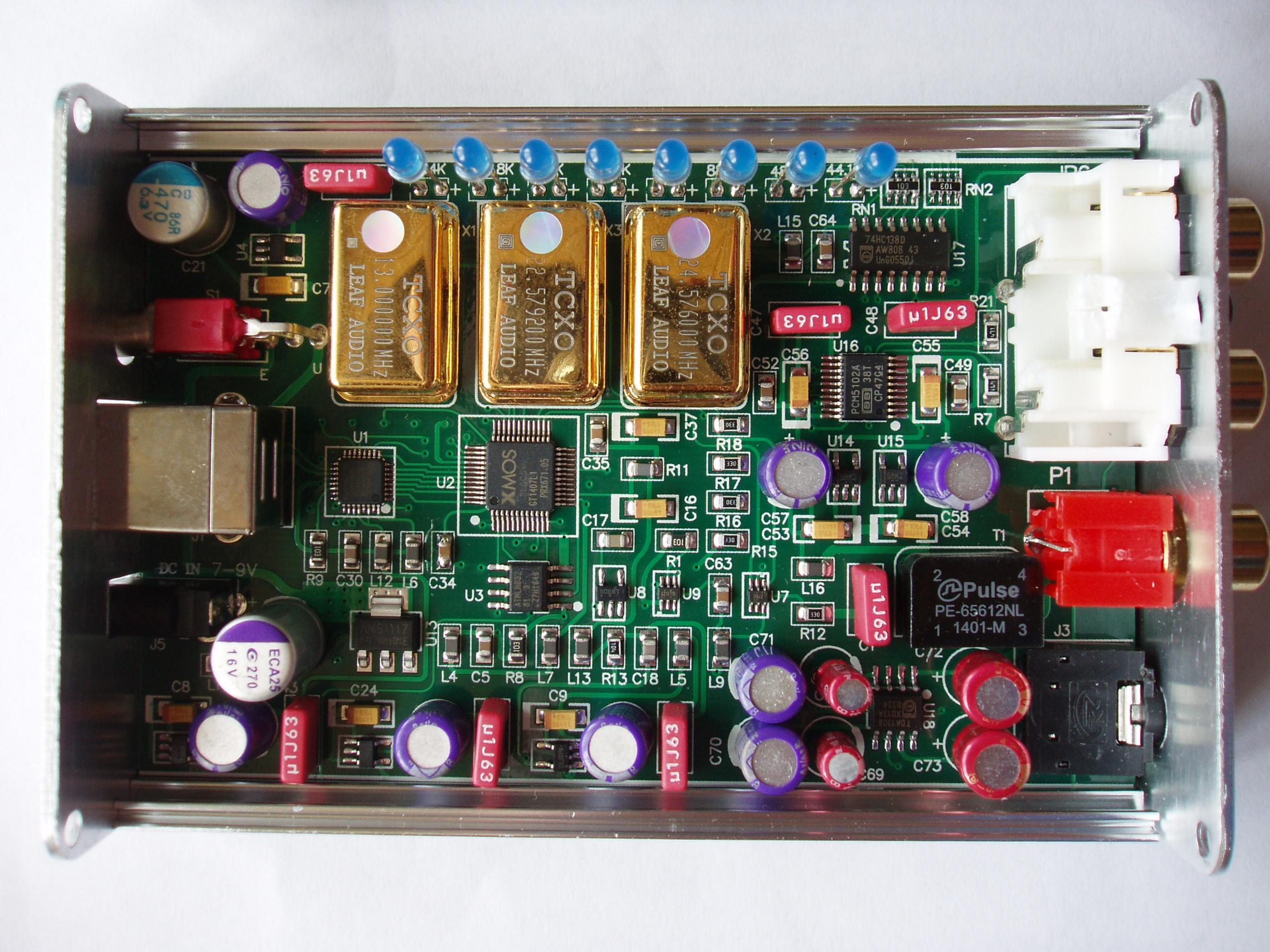

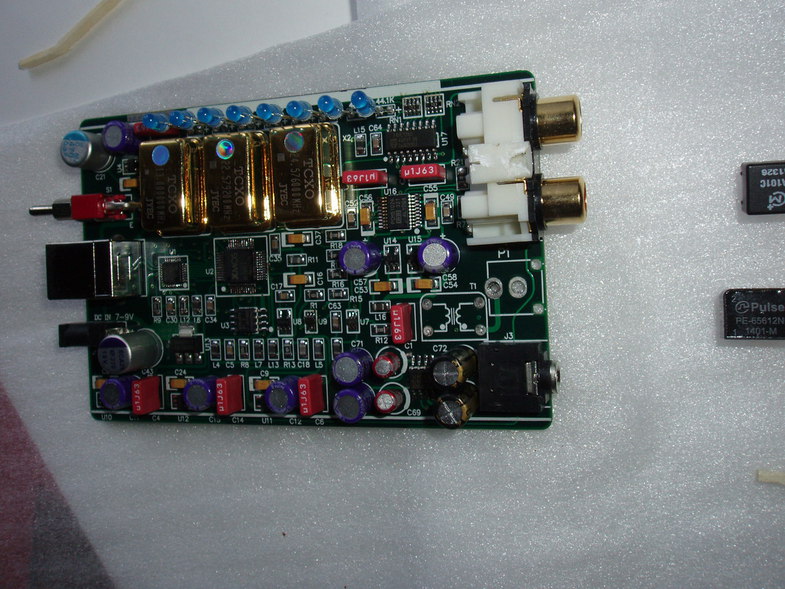

My upgrade this device:
At first remove digital transformer Pulse PE-65612NL (limits 7 mbps 96kHz)->Murata DA101C, Second remove low quallity RCA jack -> Neutrik NF-2D-2, wire and silver solder is AudioQuest

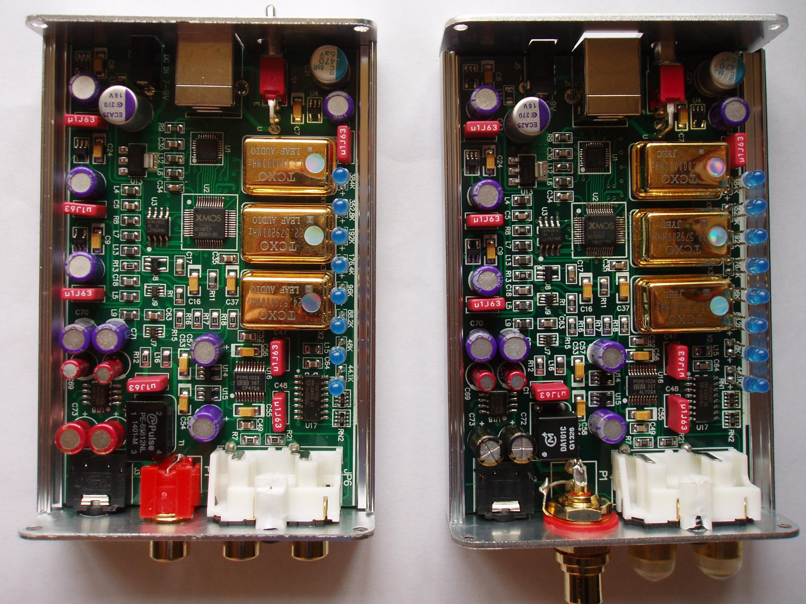

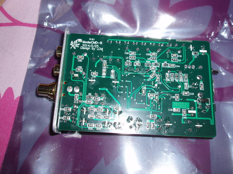

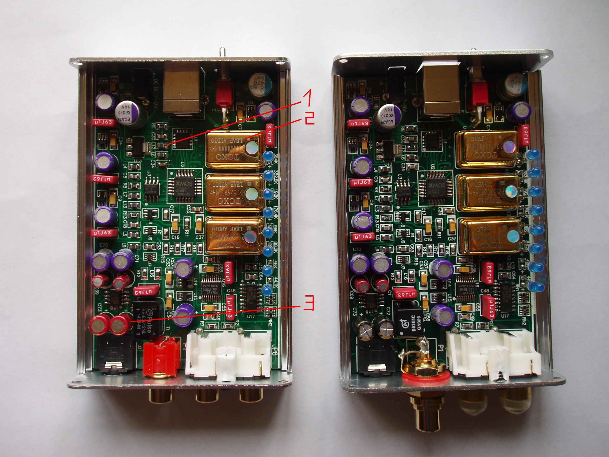

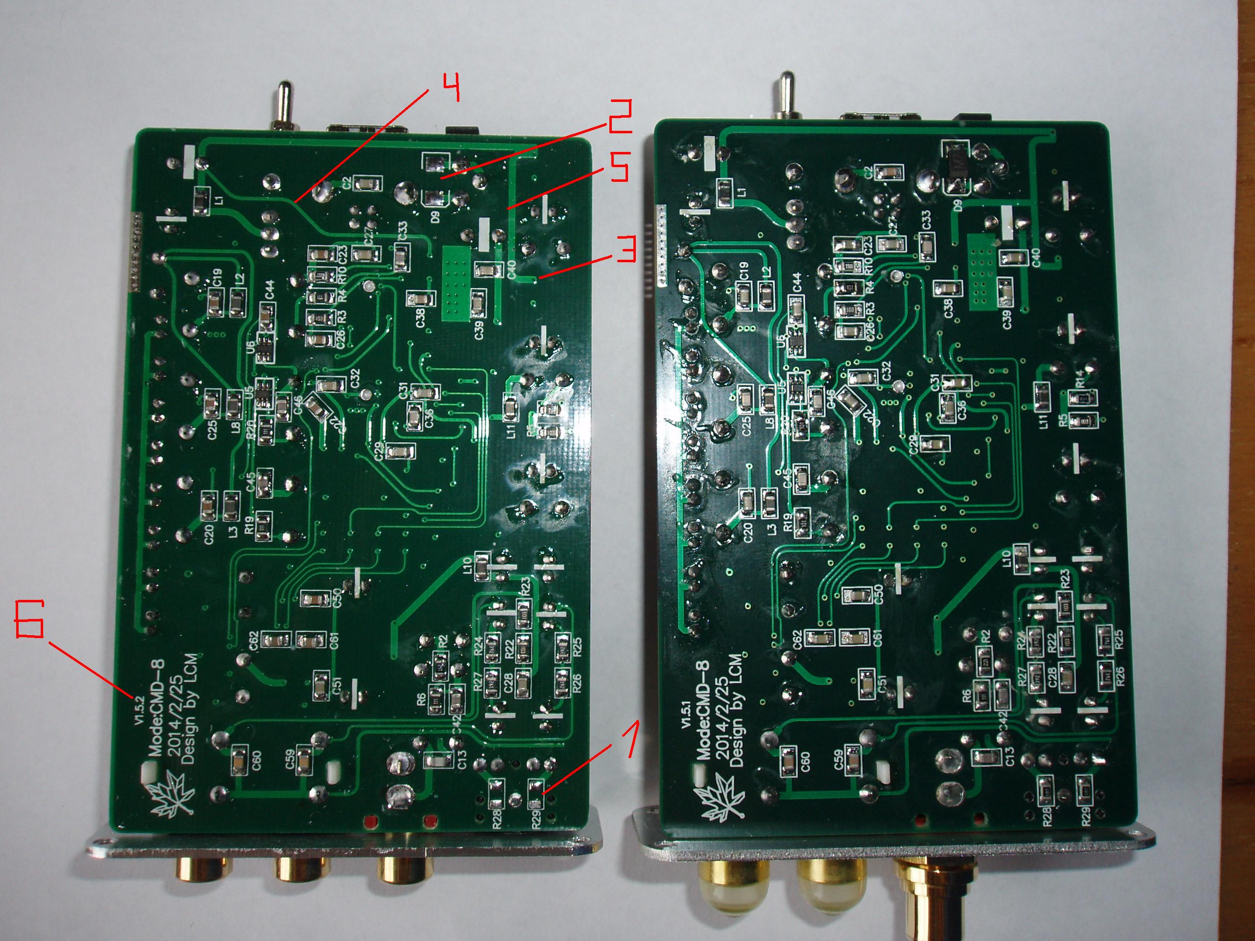

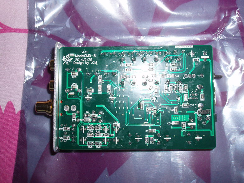

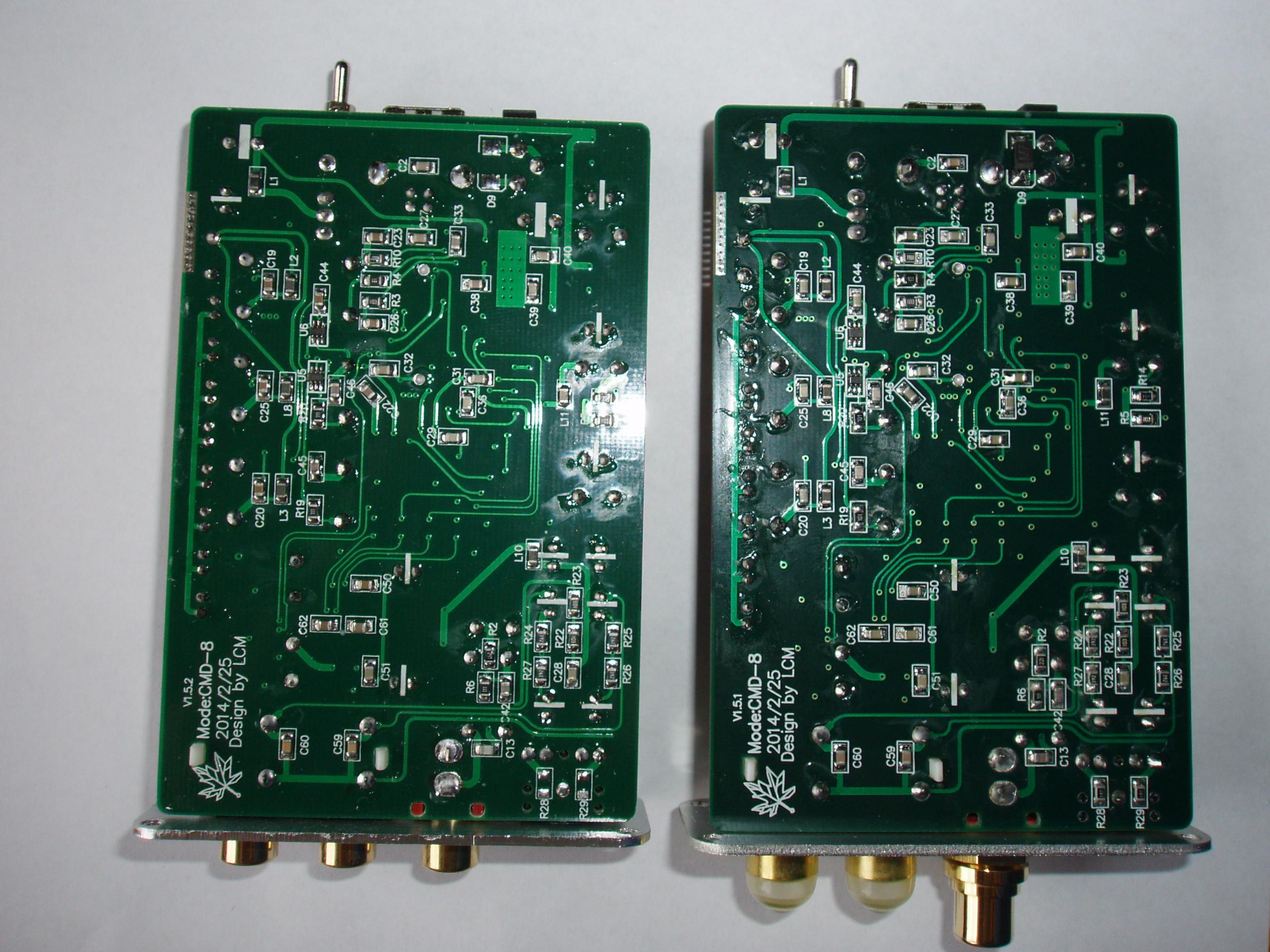

My friend have new version this device.
On the board print: V1.5.2 2014/2/25
changes (i have V1.5.1 2014/2/25)
1. L12 (other detail, but I am not sure)
2. Leaf Audio Clock (in my JYEC)
3. ELNA cap (in my nichicon for Audio)

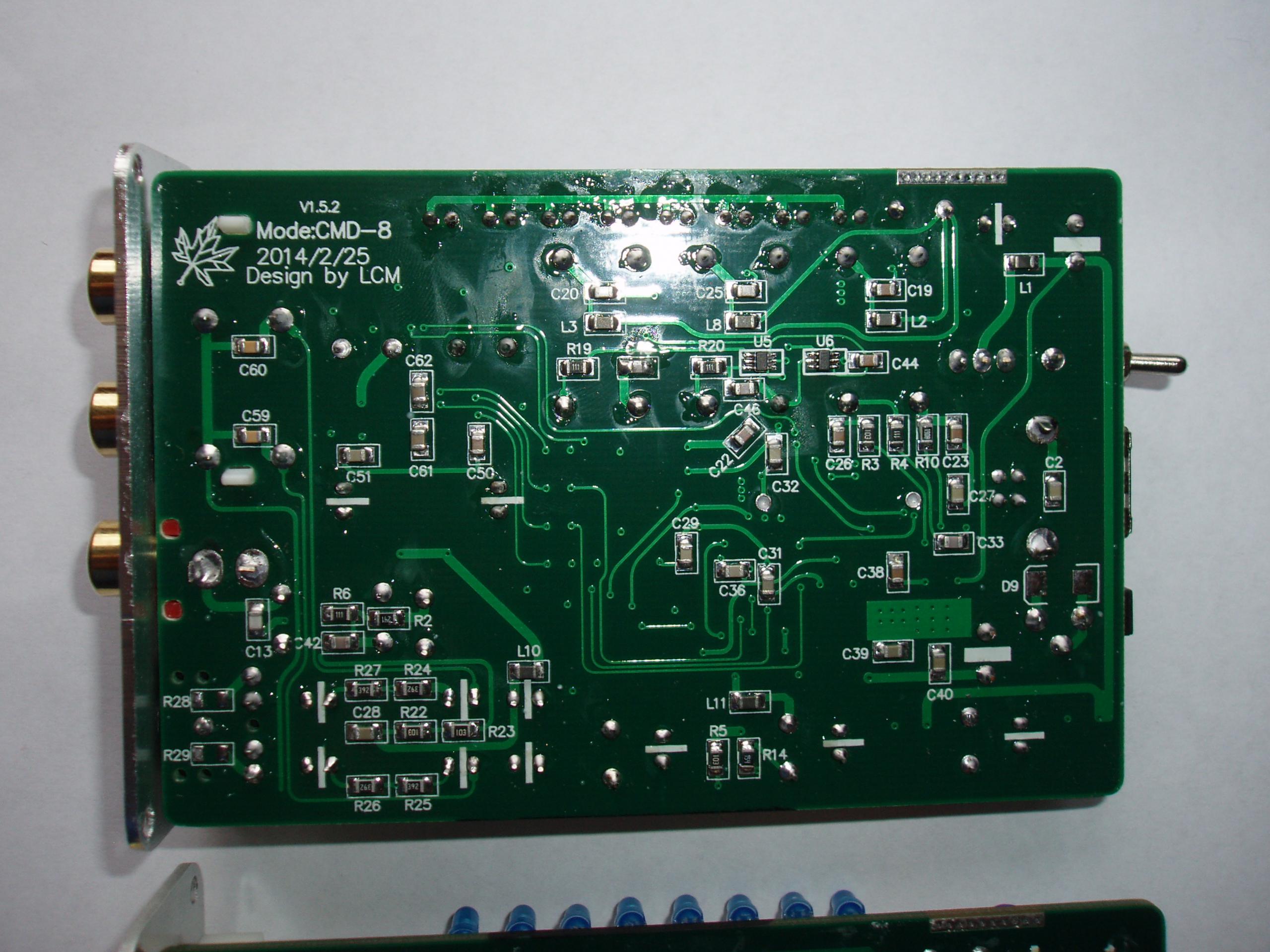

other side:
1. R28,R29 -are removed (Phones)
2. D9 -are removed
3-4-5. changes in PCB
6. print V1.5.2
other side:
2. D9 -are removed
6. print V1.5.2

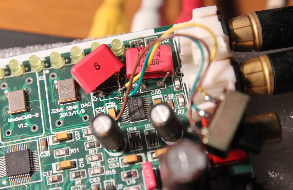

looks like de-emph is already selected. so then i cut the trace from pin 11 and connected that to where the ceramic cap is connected to pin 10 and viola... gorgeous sound. you must do this mod, haha.
Did anyone try this mod?

Adding Selector Switch to choose between IIR and FIR. I prefer IIR over FIR due to less muddy sound better separation to my ear. Here is what I did.
If you set Pin 11 to Ground, it is in FIR.
If you input pin 11 with 3.3VDC via pin 20, it is in IIR.
Hope it helpful
Hope it helpful
