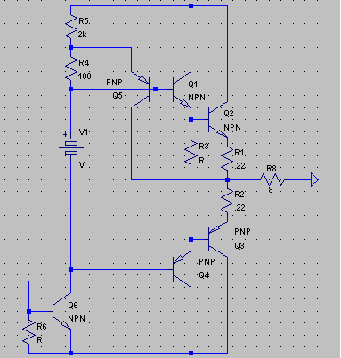

Gareth,
Your txt/asc trick worked perfectly for me..... I had no trouble opening the circuits briefly with LTSpice, but have been overtaken by events and have not yet examined the non-switch function.
The VAS can simply be buffered with an EF. This confers very strong drive with Zout less than a few ohms, and makes the stage a voltage rather than a current source. In this way wild variations in output stage input impedance are mere bagatelle, and this reduces the errors before feedback.
Carlos, you do me proud. I am sorry that I'm so close with my ideas, but this is a public forum, I work in a competitive environment, and I have no choice. But I'm always willing to discuss privately if you keep things private.
Keantoken makes the good point that non-switching output stages don't much seem to improve the distortion profile in his simulations. I've noticed this too. The vast majority of distortion in output stages seems to be large signal compression, which makes a spray of odd order harmonics, worsening with high amplitude. All the error correction I've examined in simulation doesn't seem to much reduce this distortion either, which is strange, because I can get a buffer to lose less than300mVp rom input to output at 45Vp. From this I conclude that the best EC system is probably very complicated indeed, for marginal subjective gain.
The Self EFII seems about the best to me, good sounding, stable, lots of drive, tolerant of difficult loads. Low emitter resistors seem to help, but this means quiescent hikes up, and matching and bias stability is tricky. But it's very hard to beat an EFII. The diamond buffer is worth experimenting with too, I need to build and listen to one, I'm done with simulating, it's inconclusive. Even a diamond buffer creates a string of odd order artefacts which goes on for MHz, yet it reportedly sounds good.

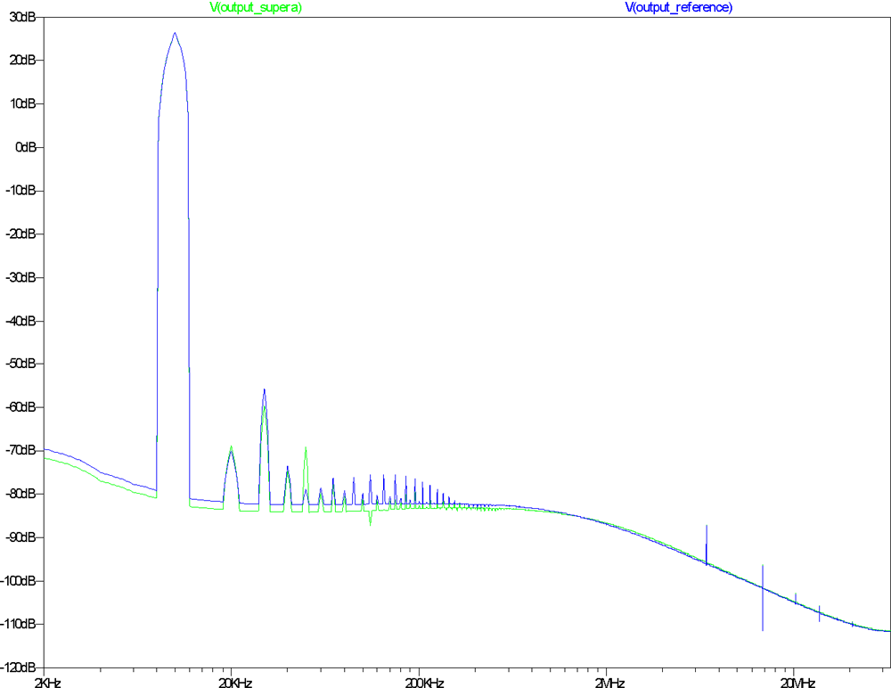

So I put together a crude CFP output with non-switching drive.
We may not believe the sims but it's fun to look now and again...
I drove the simulated amp close to full power, which means +/- 1600mV on the input.
Starting without CFP in the output stage, looking at FFTs run at 10kHz (similar trends at 1, 5 and 15kHz)
The attached shows the baseline (blue colour) amp with no SuperA biassing, showing a spray of harmonics from the 7th onwards. Introducing the SuperA biassing to keep the devices always-on is the green trace. The spray of harmonics is greatly reduced (some troubling 5H appears) but not eliminated.
Seems to confirm some benefit in pricinple, from the SuperA biassing that I hadn't uncovered with my initial rough sims.

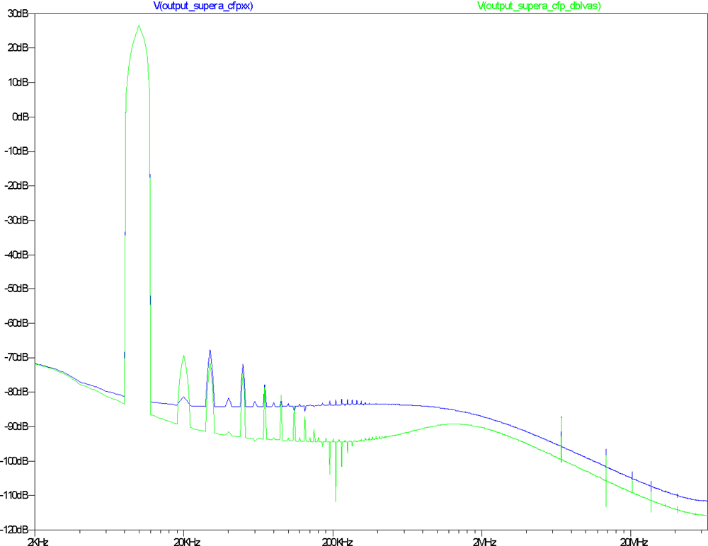

The attached shows the benefit of adding the CFP into the output. The green trace is the superA biassing only, the blue trace with superA and CFP output devices. Even harmonics are pulled way down and the higher order harmonics are almost into the noise floor.
Chalk one up for CFP output in a non-switching configuration.

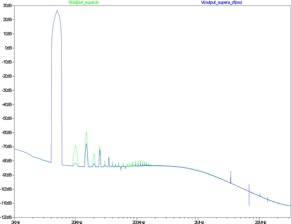

Last improvement is adding the EF bugger to the VAS, pulling the noise floor down. The key is not to wrap Cdom around the whole VAS, just put it on the 2nd device so that Cdom is actively driven from both ends instead of from the LTP output.

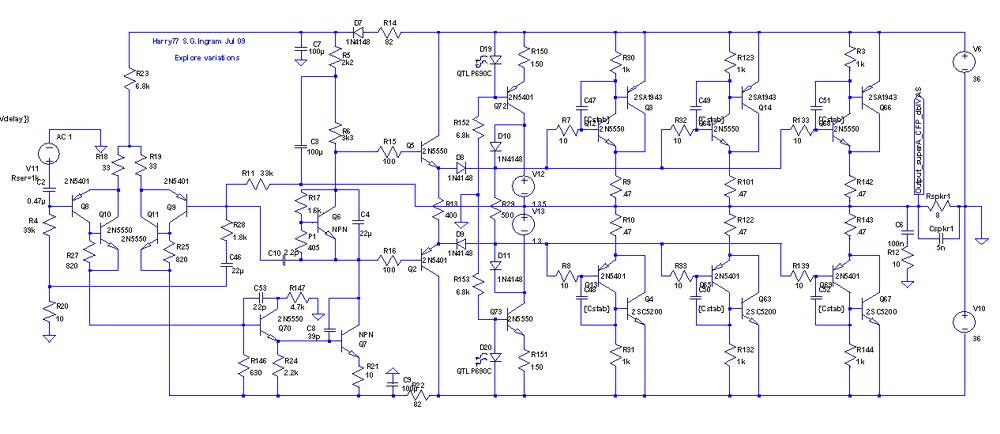

And schematic...
As I understand, the benefit of what I have used for the VAS is in buffering the input stage from the VAS/Cdom (rather than buffering the VAS from the drivers)
"bipolar transistors lose their input impedance as they are increased in operating current and require a constant bias drive because of their finite beta. This can put a significant load on the input stage, without further buffering." - John Curl

Bigun said:And schematic...
I have some input...
Don't use the "npn" model for the VAS transistor - in fact, don't use that model EVER, in a prototype schematic. This models a perfect transistor and therefore deserves a level of respect...
Switch this in for a suitable transistor model. I recommend you use the MPSA18, cascoded (that's what I would do, at least), but it may not be able to drive your OPS.
Next thing, the collector of Q70 is being wasted... Try attaching it to the top of the Vbe multiplier, like in the 5532 schematic:
http://www.dself.dsl.pipex.com/ampins/webbop/5532.htm
- keantoken
Joined 2009
Thanks Homemodder, it's always very useful to get some real world feedback on these things. The technics method adds complexity so you'd want a good reason to use it. I don't plan to use my amps at their limits so perhaps it doesn't offer enough. Still, I find it interesting to explore ideas via simulations - I couldn't possibly build everything that looks interesting. I think OStripper is planning to look at non-switching with MOSFETs at high power levels so it will be interesting to see what method he chooses.
Keantoken, thanks for the input. I do need to update my sims with some proper models, for example, I use the BD139 in my existing VAS.
But I'm not sure why I want to connect the 1st VAS collector to the bias chain ? are you thinking that it might benefit from the VAS bootstrap ?

Hi Bigun.
here are my 2 C's...
Looking at your schematic there are 2 "Cdom" capacitors, C8 and C53, that seems to be in the wrong place.
C8, because it is connected to the very low impedance node of Q70 emitter it will have nearly no effect in linearising the VAS stage.
C53, because it's connected to the collector of Q70, but as we are not taking out any signal here we have nothing to win here either.
Remove these 2 capacitors and add one capacitor from collector of VAS transistor to base of Q70.
R147 on the collector side of Q70 is kind of a waste, it also provides a voltage signal out of phase counteracting the base input signal via the non-linear Miller capacitor inside the transistor and will make the stage more non-linear, remove it and connect collector to GND or make a resistor divider from GND to negative rails voltage and add one larger capacitor connected from collector to negative rails voltage.
Good luck!
Cheers Michael
Actually, I think C53 has a positive affect.
The voltage at the beginning of the OPS is nonlinear. When we use a Cdom cap as you describe, this nonlinear voltage injects nasty harmonics into the VAS input, when all we were trying to do in the first place was introduce linear HF compensation. The voltage at Q70's collector will still be nonlinear, but it will be 2nd harmonic in nature and won't inject so many HF harmonics into the feedback loop.
To optimize C53, it's best that the highest tolerable value be chosen for R147, as this resistor increases the effectiveness of C53. If this resistor is increased, C53 can be decreased, which will improve THD and LTP operation at HF.
- keantoken
