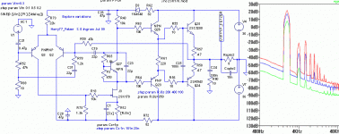

Harry77 with Fetzer VAS

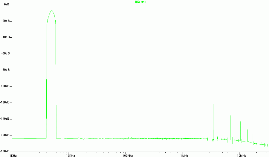

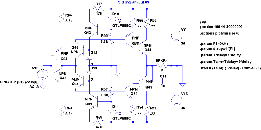

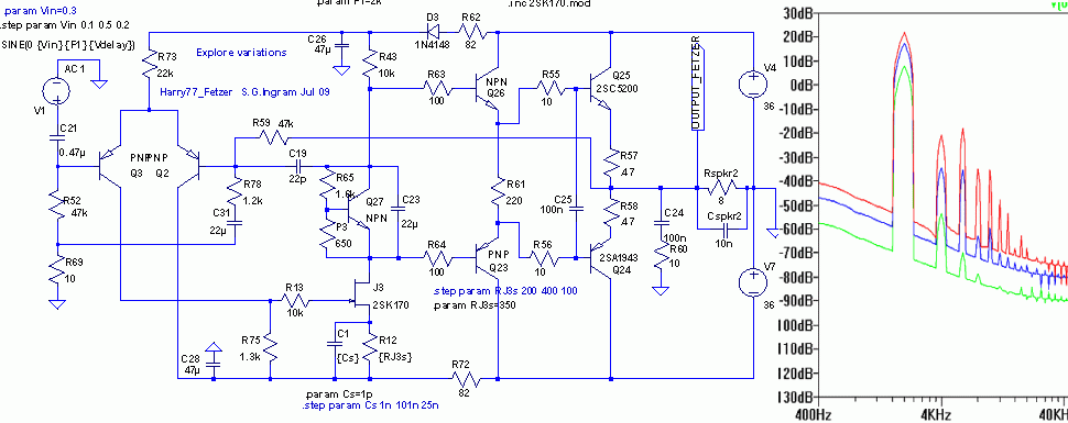

I decided that I needed to showcase my guitar amp credentials for this amplifier so I buried a Fetzer Valve into the VAS.
The schematic is attached. It shows a JFET working as the VAS. This device has a non-linear transfer curve and is set up to produce distortion. The Fetzer Valve is not my inventions, but it's usually employed as a pre-amp.
As the input signal increases the level of distortion rises. Here you see three FFT curves with progressively increasing input signal.
Get those guitars ready
p.s. no Cdom required.

Joined 2009

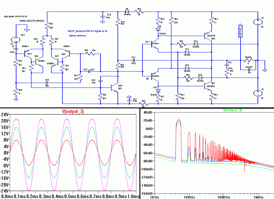

As promised, I have looked at the Wavebourn output structure, one that provides a built-in soft-clipping function.
It works as advertised. I grafted it onto the back of TGM2 to explore this. There's no global negative feedback. The schematic is attached along with output at 3 levels of input and the corresponding FFT. Unfortunately, in my configuration distortion is a bit too high at the low signal levels.

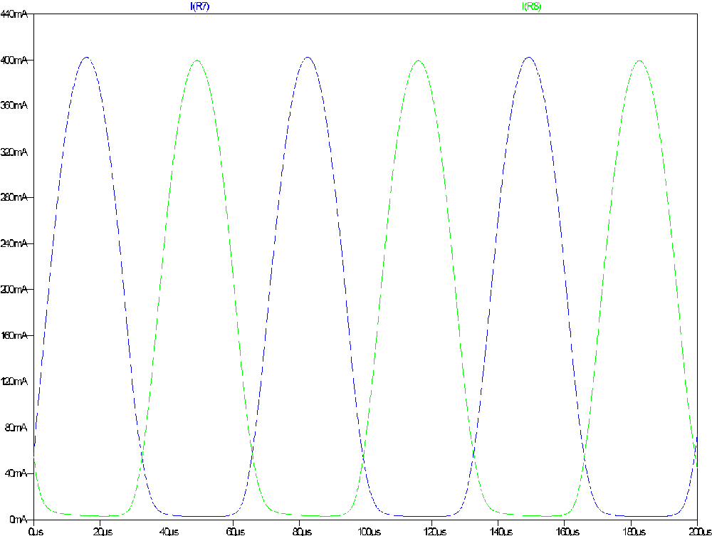

CAN YOU HELP ME ?
I'm very curious about the non-switching classB and I have made a simulation based on one of the commercial methods. I can't remember if it's Technics, Sansui or somebody else and it's called something like SuperA or AA or A+. Anyhow, I have the simulation working, I see some clear evidence that the output devices do not turn off.
But the simulations don't seem to indicate any benefit in terms of distortion ???
I will try attaching the spice file in case anybody is interested to help. There are 3 versions of the circuit. The top one is regular ClassAB, the 2nd one is the non-switching applied to the output devices and the bottom one is the non-switching applied to the driver devices.
Here's the current through the output device emitter resistors...

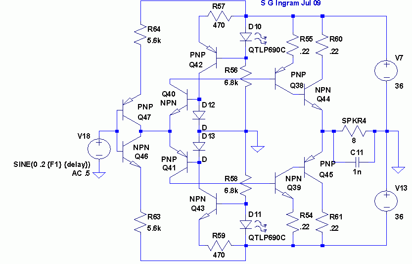

Joined 2009

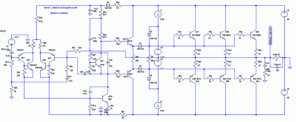

I've had a look at the Allison output. And I've read more on Fd Fwd and Error correction. I'm not sure I fully understand the Allison output structure.
The concern I have with the Wavebourn output structure is that I have not seen low distortion in my sims at low signal levels. I love the soft clipping at high signal levels but not at the expense of the low signal levels where most of my listening will likely occur.
A far bigger problem is my limited knowledge and experience. I can only get so far before I hit problems due to a lack of understanding. I'd appreciate any help with getting past these roadblocks.
Perhaps the 'super A' non-switching output is not providing the anticipated benefit. But the original aim with this thread was to look at non-switching based on the Blomley method - where the output stage is actually supposed to operate in a current mode.
So I have made up a simulation of a current amplifier output with a voltage input. It produces low distortion in my sims at low signal levels. Clipping behaviour is awful but that's something to look at another day. The big problem and it is clearly something darn STUPID that I'm doing - the simulation only works with the default transistors in Spice. As soon as I try to use a model of a real device the results fall apart. I never saw this with the voltage mode output structures I have simmed in the past so I don't understand what I'm missing.
I'd appreciate some help with this one, it's got to be something stupid.
I'll post a few bits and pieces for viewing: First the schematic

A note on the input VAS: the collectors of these transistors have no Vce, and so you will easily drive one transistor to saturation. Maybe you should try diodes in series with the bases?
Also, when you just leave the transistor models as NPN or PNP instead of specifying the model, it looks like LTSpice defaults to models of perfect transistors. This, obviously, will make your circuits impressive and ingenious in all ways.
It doesn't seem like it will work so good in real life though...
This circuit relies on Hfe to maintain the bias of the output devices, something that's not recommended.
I won't tell you it's a bad idea, because people have told me this and been wrong.
- keantoken
Joined 2009
Good question - these two devices are the 'magic' that make this amp work for voltage inputs.
The basic design is a current amplifier. Q40/41 are the input devices and essentially split the current +ve going and -ve going. The current has 'no way out' except through the output stage so the total current going into the load is virtually distortion free providing that you use 'ideal transistors'. In fact the distortion profile of the current going into Q40/41 emitters is reproduced very accurately at the output load.
Since the input will in reality be a voltage I needed a voltage to current converter. Now this is not as easy as it seems. A simple resistor feed into Q40/41 doesn't work, it's too non-ideal and you end up pushing a lot of distortion into the amplifier. I looked at several alternatives (including the venerable LTP) but most were non-ideal or suffered from too much offset.
However, Q46/47 present a nice simple current source to the amplifier. The amplifier needs a +ve and -ve current input wrt ground. Q46 pulls current from the amplifier that it sinks to the -ve rail and Q47 injects positive current sourced from the +ve rail. Hence both collectors are connected to the amplifier input. It also provides for a low input current because most of the base current for Q46 is supplied from the base of Q47 and vice-versa. The signal input is a very tiny current. This is key, it is why this V-I converter has such low distortion going into the amp.

Has anyone built this type of non-switching output - how did it sound ???

I am still wondering about my dream of a current amplifier, if the realities of real-world devices can be overcome.
With the default spice models in my voltage mode amplifiers I always saw distortion. Adding in real models improved the accuracy but didn't produce a large degradation. With the current amp it changes drastically and it's a real shame.
Here's the FFT of the current amplifier from the default spice models - you will agree that it makes for a very compelling design approach
