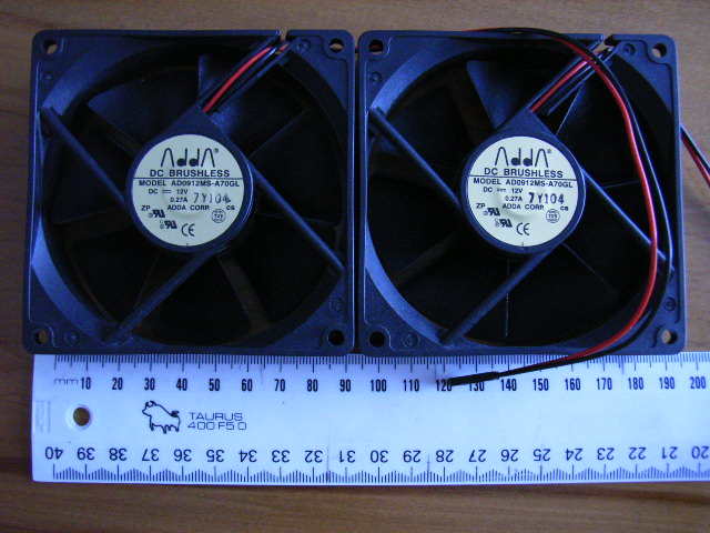

as far as using fans. they push air better then they pull. the most effective method is to arange the sinks as was previously described then place the fan on the bottom letting the fan and natural convection lift the heated air out the top. larger diameter fans generaly make less audible noise. i find that enermax enlobal computer fans are very quiet, plus the are magnetically suspended so the bearing lasts seemingly forever. I boght the last ones at Mcm electronics. ifind nothing wrong with using fans either other than the periodic need to clean out rhe accumilated dust. My deciding factor was when the wife saw how big the new amp would be she freaked ,so fans were the only option to get the new amp out of the shop.
Fans
I am going to run two of these fans
I am thinking of using Rod Elliott's Thermal Fan Circuit.
