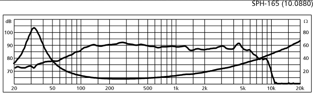

I'm unable to find frequency response in any form for Monacor SPH-165.

I have found it: http://loudspeakerfreaks.com/datasheets/monacor/sph-165c.pdf
I would choose Dayton DC160 since it is much cheaper and they even provide *.frd file. Monacor may be better, but not 3x and frequency response graph provided is useless.
Indeed, Monacor says it is 33hz to 5000hz, but what I found really suspecious is that they say the vas is 36l which is impossible for a 6.5inch woofer !! however it looks better build with more than 2kg weight

The SPH-165 is a polycone with a powerful motor, hence Qts 0.21 and VAS 36L. Fs 33Hz. Efficiency 89dB. Le must be about 2mH (not 1.1mH) for correction purposes looking at the impedance curve.

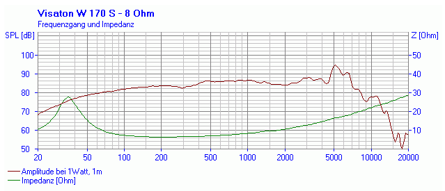

Not unbelievable at all. The 87dB 1.2mH Le W 170 S - 8 Ohm is not a million miles away, but more closed box at Qts 0.52 and Vas 38L. In practise, you'd usually use about 20L with a 6" bass. Big cabinets get a bit flabby on bass, and power handling is reduced.

Usually with high inductance woofers you add some resistance in the capacitor shunt arm to keep them smooth. A simple LC often gives a peak at crossover, especially as you take crossover higher when inductance becomes significant. A bit of impedance correction, in effect. High inductance woofers generally roll off better than low inductance, and sort of have a bass bafflestep coil built in.
