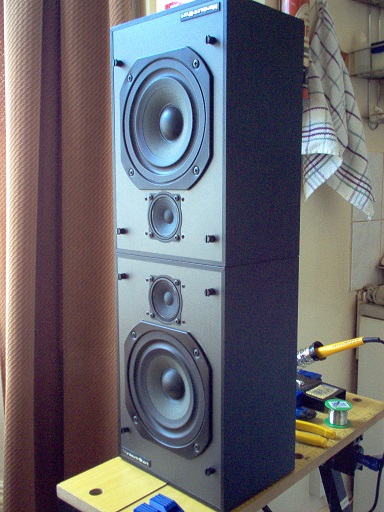

Here's a Wharfedale E90 WWMTM design. Genius, IMO. Simple LR2 crossover with the mids wired in series. This is a loud PA speaker in essence. I like the idea of twin drivers. You get 4X the level for the same distortion.

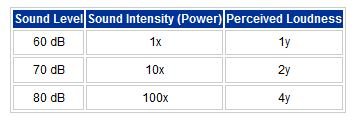

No, that's wrong. Doubling the membrane surface gives you only +3dB while double the loudness would be +10dB, to quadruple it, you'd need additional +10dB. If you were referring to the +3dB at the half impedance on parallel drivers, that is correct, at least partly. Because then the power also doubles and that means, the distortion rises the same.
system7 said: "...I like the idea of twin drivers. You get 4X the level for the same distortion."
You haven't thought about it. And you are confusing perceived loudness with power. Wire two 80dB 8 ohm MT speakers in parallel, and you now have a 86dB 4 ohm MTTM. Each speaker is working at exactly the same level and distortion but we have gained 6dB, which is 4 times the power. The series wired equivalent works the same way, but it's then an 80dB 16 ohm MTTM speaker. I rest my case. :cool:
Sorry mansa. That doesn't help you much here. I think you need a modelling program or a good 3 way design that you can maybe convert for doubled drivers. And series wired twin drivers is easier.
