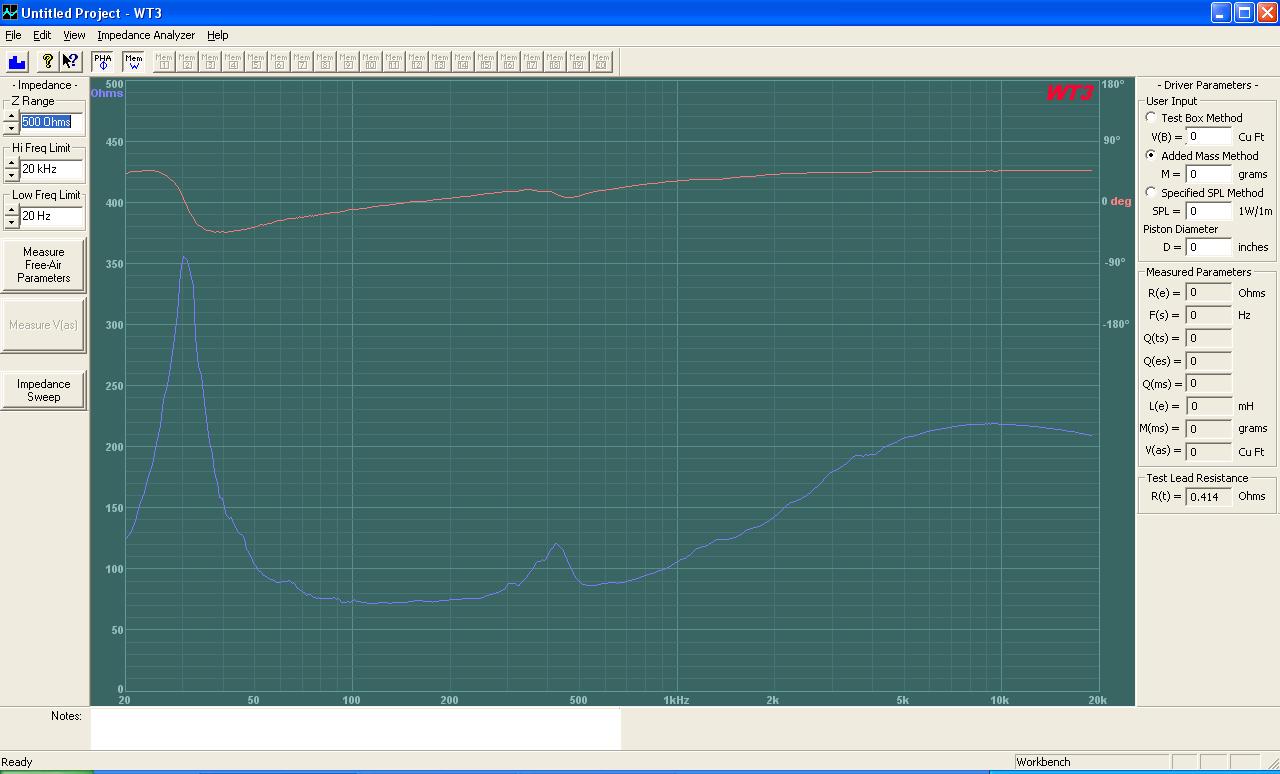

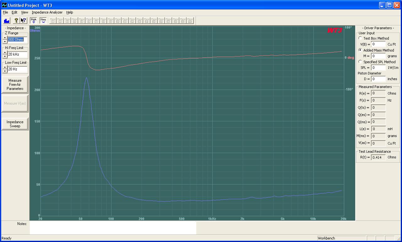

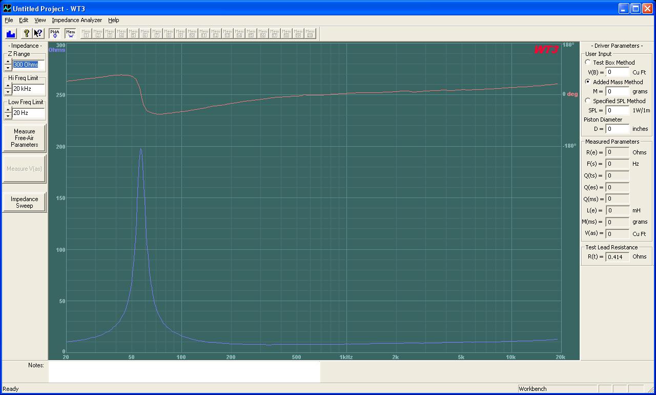

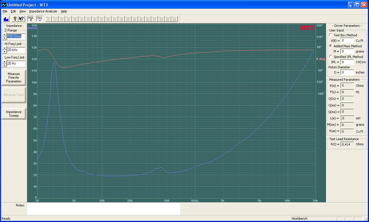

cool - looks like a significant shift in resonance from ~41 down to 30 - if you hit "measure parameters" it will give the impedance curve and display system Q (~like a sealed box) -

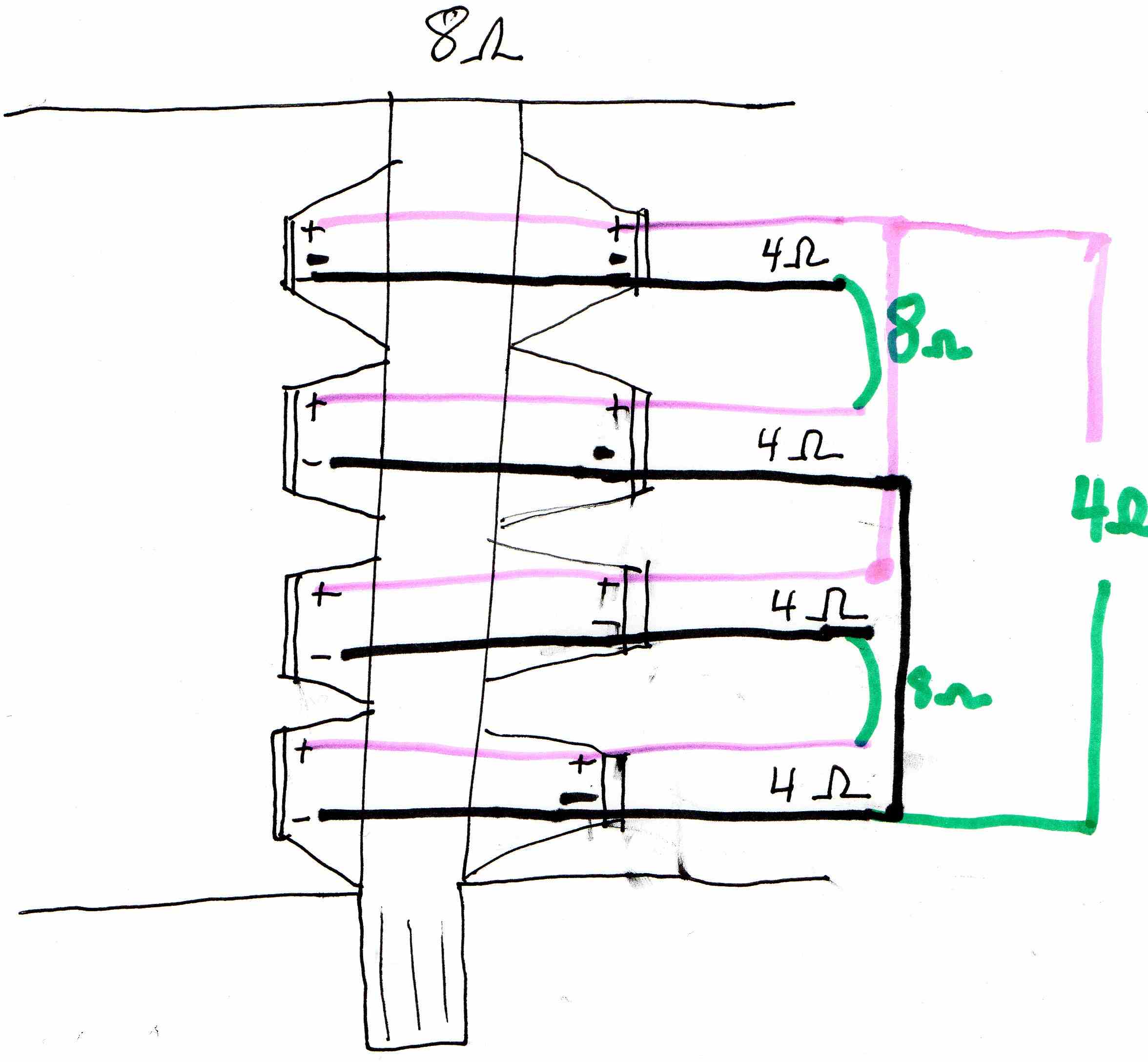

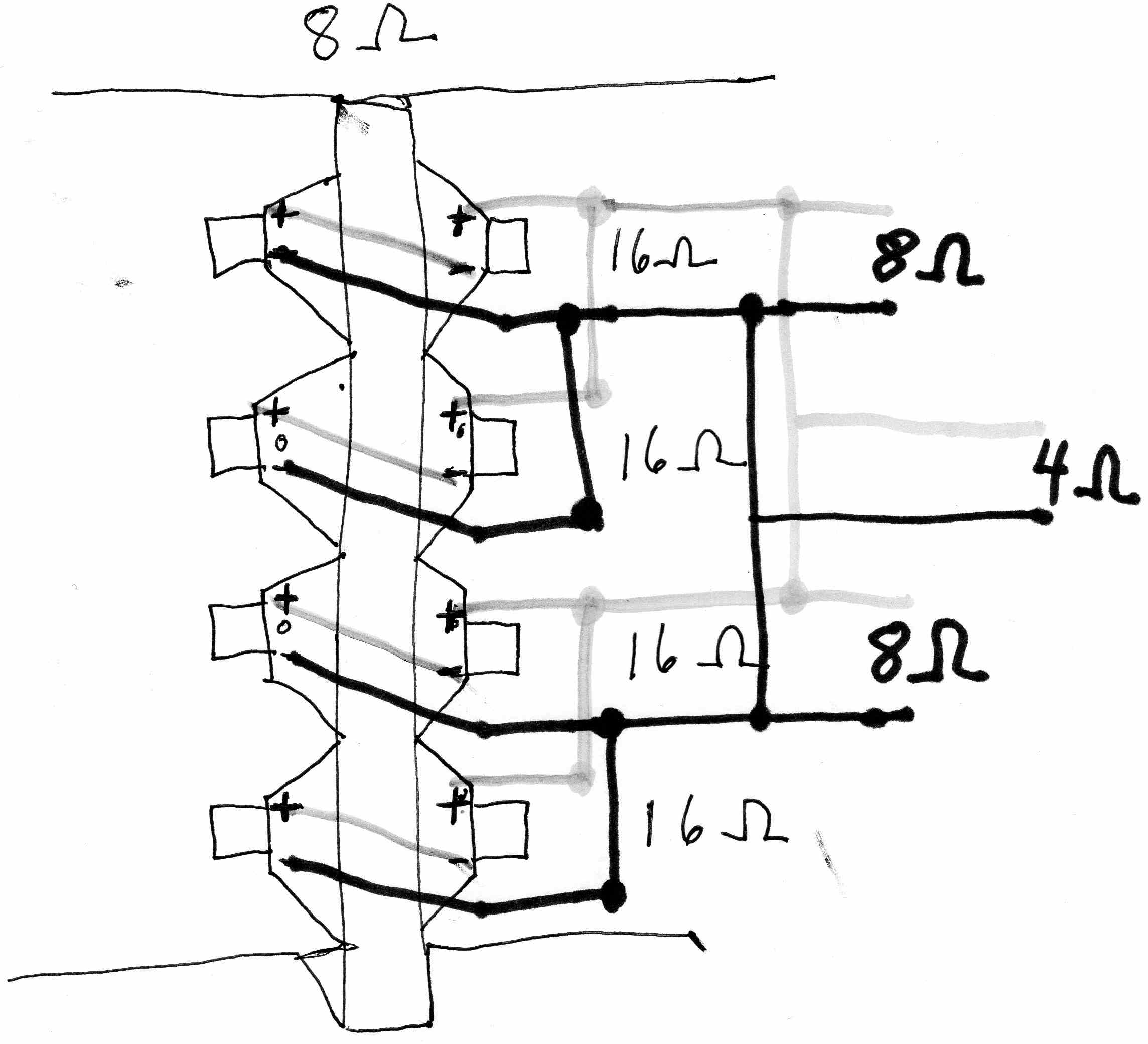

how I wired them.....
hi,
I tried a few combinations and some speakers were louder or got over driven,Yes I am a POWER driver,lol.Sometimes I push them to see how much they will suffer before they distort or blow,but ,I found two ways to try ,That I liked.
1st I figured since you have 2 speakers facing each other and in one slot, they should work together so I have read this article about push pull ,well I think if it pushes and the other speaker pulls that only moves that volume of air,what does that do? I think not much,So I think instead if you wire them to both push,then you got 2 times push coming out the slot ,opposite when it pulls in.....So I have wired each 2 together and connected all of them for the impedance,

I think that there are other advantages to the push pull arrangement. The thread posted in the subwoofer section has a nice explanation of those advantages ... distortion cancellation being one of them.
I don't recall the author of that individual post within that thread but check it out. It's a good explanation and one that isn't intuitive ... until you read it at least

I'll take a look, I think I read about alot of different combo's of wiring them and my last way of using them in a positive pushes in and neg pulls out seems to sound the best,but I am always willing to try out Idea's from other members
I used the speakers that Nelson Pass recommended and I have 12 speakers per side,Have you tried any mods to these ,How did you make yours?
