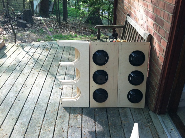

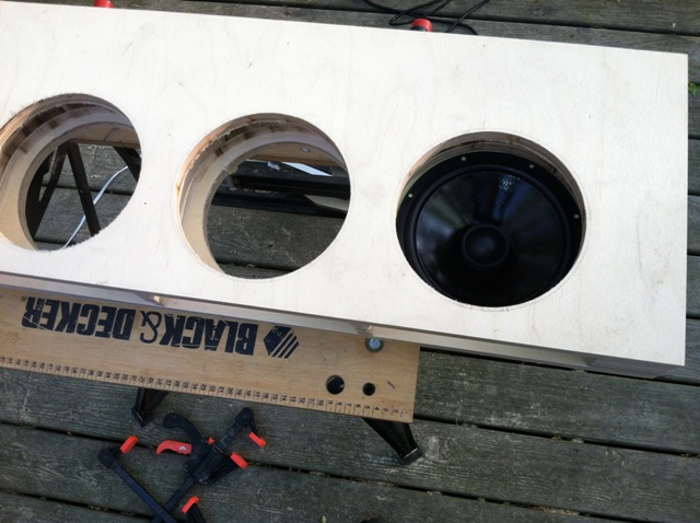

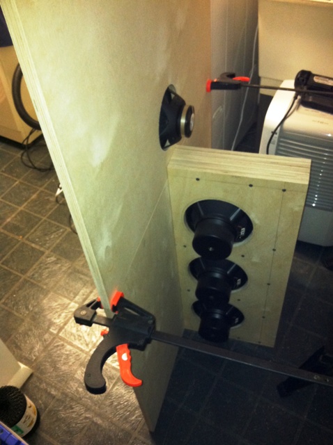

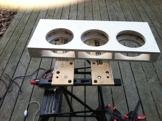

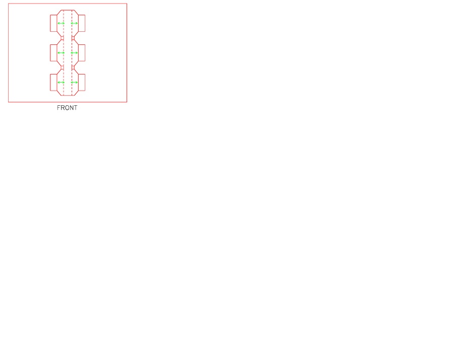

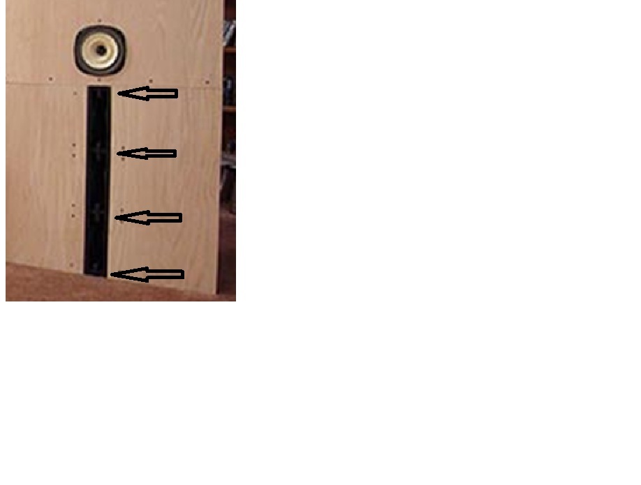

Driver Mounting
Must the drivers need to be flush mounted to their baffles inside the slot area? Would flush mounting the drivers reduce turbulance inside the slot?
Are the woofer pairs seperated by a "brace" that is formed by layering the sheets of plywood? See attached diagram. From the photos describing the project, it appears that a "horse shoe" structure is formed inside the slot.
See pics.
Thanks,
Vince
See pics.
Thanks,
Vince

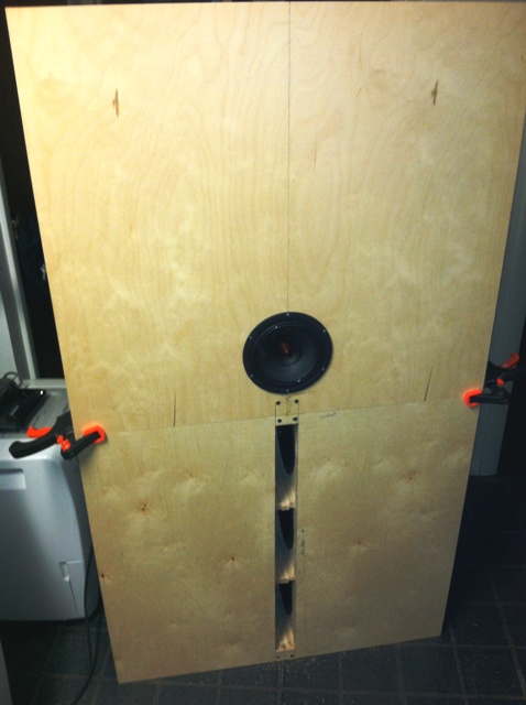

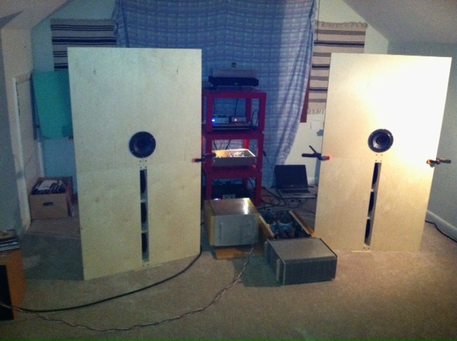

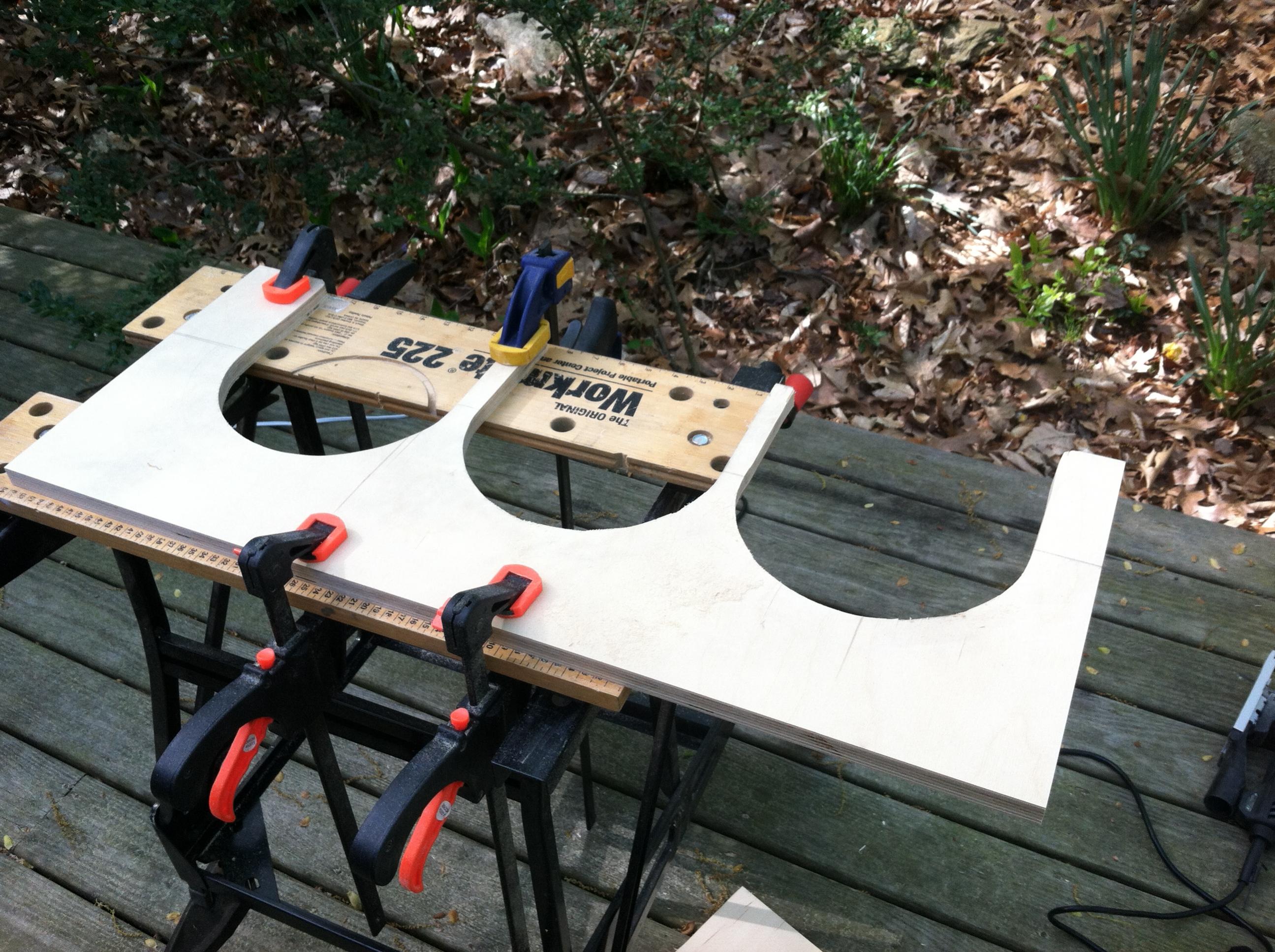

Anyone else build this speaker? Anyone else move from physics theory to pratice? If you built a full-scale model, please share your photos and sound impressions. Don't let the last 40 or so pages of arguments disturb you. It's just necessary growing pains.
I'll start. It sounds really good. Lots of appropriate bass without the box sound. I guess at first I was waiting for it to impart bass in every part of a song whether is needed it or not, but that would be like some people buying a sub for a home theater and they are not happy unless they hear their sub through out the whole movie. Once I got over that need to hear the bass in a pronounced manner, I began to appreciate what it could do. I did throw on some Hooverphonic to check out how low would it go...and it did.
BTW- hard rock is pretty insane on this speaker. More than I need at close range.
It does blend well with the 6.5" full-range (FR) driver, although I haven't completely dialed in the levels perfectly yet. I'm using a volt meter in the active crossover and adjusting it from there. I bumped up the Q at the crossover to .9 and like it. The bass leaves off at 100hz and have set the FR to pick at around 125Hz. I'm still playing with the XO points; I only make changes once at night.
My issues are not with the bass unit, it's with the FR driver (Parts Express PS180-8). At first listening session, there was much midrange emphasis. It really takes away from the rest of the system. It's horrible actually. It was better on night two. I suspect there will be a long break-in period. So far I've heard it takes 100-200 hours for drivers to relax.
I have not used baffle step compensation, but read a nice article at Elliot Sound. it would not be difficult to implement a line level ciruit betweem the XO and amp.
The FR is powered by the Zen 9 and bass unit by the F5 modified with no thermistor and not protection. The woofers are Peerless India 8", 12 ohm, shielded drivers. They are wired 3 in series, then the set is in parallel.
One more thing...I mounted the woofers on the outside baffles. The slots are probably a bit larger than they should be, but I don't hear a problem. There is no port noise. The tones out of the slots are clear and defined.
Your turn...
Vince

Thanks for the update Vince. I have been waiting for your report since you stated that you were going to try this. I've been looking at budget drivers from several sources, including the Peerless that you used.
Do you have the capability of running a frequency sweep? I would be interested in knowing how low these things go. I am planning to use a similar set-up under some vintage 12" co-axial's I bought to experiment with. ( so far I have University Mustangs, Coral, Pioneer, and EV's, still looking for a deal on some Jensens. All are from the '60's and early '70's. )
I'm going to go a little more ghetto on my set up, basic plate amp with 2nd order XO, and my KT-88 SET amp on top.
I'm also thinking about "U" frame enclosures to reduce the monster baffle size....
keep up with the update's please.
PS: If those PE fullrangers are anything like the Fostex FE206's I have, they will take a lot of hours to break in, but will get better, and smoother as they do. When I broke in mine, I built an OB about 18" wide, by 40" tall, with the thought that later I could add wings, or a shallow "U" frame, and a couple of 12" woofers, but I have them in some back loaded horns now that I really like.
